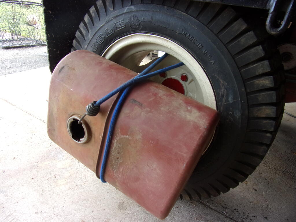

Ed Kennell 44,823 #8 Posted January 1, 2023 I used gravel to clean the rusty 953 tank. Jack up the wheel, bungee it fast, and let her run. Washed it out with hose pressure, dried it with a heat gun and coated it with motor oil till I was ready to install and fill with fuel. 6 Share this post Link to post Share on other sites

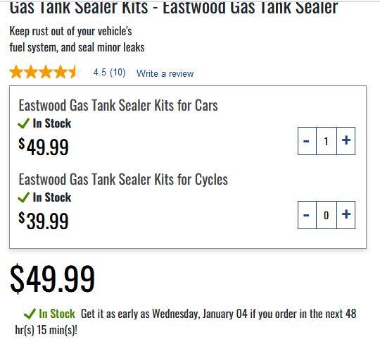

pfrederi 19,868 #11 Posted January 1, 2023 I have used this kit on at least three tanks. All were done about 20 years ago still doing well. 3 Share this post Link to post Share on other sites
Retired Wrencher 6,442 #12 Posted January 1, 2023 2 hours ago, Ed Kennell said: I used gravel to clean the rusty 953 tank. Jack up the wheel, bungee it fast, and let her run. Washed it out with hose pressure, dried it with a heat gun and coated it with motor oil till I was ready to install and fill with fuel. I saw that before Ed and was thinking of that myself. I have some small point stones. It is not that bad but would not hurt to do this. Thanks. 1 Share this post Link to post Share on other sites

Retired Wrencher 6,442 #14 Posted January 1, 2023 16 minutes ago, pfrederi said: I have used this kit on at least three tanks. All were done about 20 years ago still doing well. Thanks for the info. Will keep in mind. 1 Share this post Link to post Share on other sites
