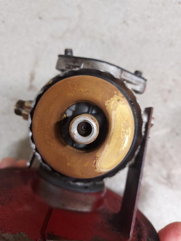

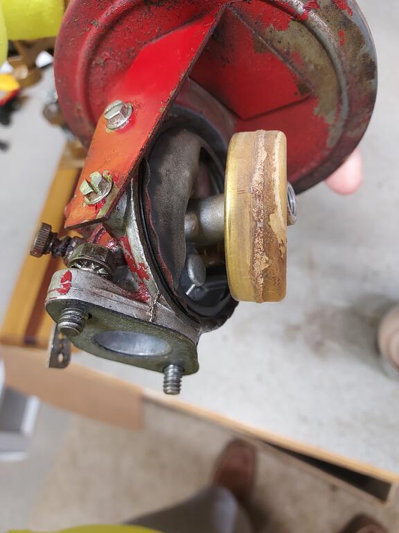

ebinmaine 81,139 #26 Posted March 5, 2023 On 3/4/2023 at 1:42 PM, csvt99 said: I'm thinking I might just need to replace the carb instead of messing with it. I cleaned the gas tank, blew out the lines, replaced the inline fuel filter, and added fresh non ethanol fuel. I never use ethanol in my small gas equipment. Thanks. 2 minutes ago, csvt99 said: I removed the carb and the bowl. The bowl did still have some gas in it. Any thoughts? Not quite sure where to start. Thanks! That carb needs to be cleaned. NOT replaced. Send it to me and I'll check it over. 1 Share this post Link to post Share on other sites
Handy Don 17,679 #27 Posted March 5, 2023 25 minutes ago, ebinmaine said: That carb needs to be cleaned. NOT replaced. That carb will likely be fine. The critical parts are the inner passages, the jets, and wear and tear on the holes in the body where the throttle shaft pivots. Many of the folks on here have seen WAY worse carbs that have been saved. 1 Share this post Link to post Share on other sites
csvt99 173 #28 Posted March 6, 2023 So the next question I have is where do I go from here, currently having a carb that leaks gas, to a carb that doesn't leak so I can put the tractor back together and start teaching my kids how to work. Given the era I was born in, these carbs seem to have some secret code that I do not possess. I of course know this is not the case and that they are not that complicated and the real problem is that my head is filled with too much computer jargon. Anyway, any suggestions on where to start? My dad is pretty good with these things but he keeps following my mom around on vacation so I'm on my own 3 Share this post Link to post Share on other sites
ebinmaine 81,139 #29 Posted March 6, 2023 4 minutes ago, csvt99 said: So the next question I have is where do I go from here, currently having a carb that leaks gas, to a carb that doesn't leak so I can put the tractor back together and start teaching my kids how to work. Given the era I was born in, these carbs seem to have some secret code that I do not possess. I of course know this is not the case and that they are not that complicated and the real problem is that my head is filled with too much computer jargon. Anyway, any suggestions on where to start? My dad is pretty good with these things but he keeps following my mom around on vacation so I'm on my own Send me a pm. Give me a call. I'll guide you through this. Share this post Link to post Share on other sites
ebinmaine 81,139 #30 Posted March 6, 2023 Been a while since I've perused through this but I believe this particular thread has some good info in it for you. 1 Share this post Link to post Share on other sites
csvt99 173 #31 Posted April 1, 2023 I got it done today. Cleaned and installed the rebuild kit. We will see if it worked! 1 1 Share this post Link to post Share on other sites
ebinmaine 81,139 #32 Posted April 1, 2023 2 hours ago, csvt99 said: I got it done today. Cleaned and installed the rebuild kit. We will see if it worked! Keep us posted! Share this post Link to post Share on other sites
Sailman 1,307 #33 Posted April 1, 2023 If it still leaks gas double check that float. I went through the same process with one of my C-120 tractors. No leaking, rebuilt and cleaned the carb including tiny holes in the jets. Ran fine but started leaking gas. Turned out the float had a tiny leak with enough gas ingress to not completely close the needle valve. Thought I had checked it when I rebuilt the carb but was VERY hard to tell. 1 Share this post Link to post Share on other sites
csvt99 173 #34 Posted April 2, 2023 So far it hasn't leaked. Will give it a couple more days. 1 1 Share this post Link to post Share on other sites
csvt99 173 #35 Posted April 3, 2023 Ran it a bunch today and it seems good to go. However I did have some oil leaks🙄. I tightened down some bolts so I think it should be good now. 🤞 1 3 Share this post Link to post Share on other sites

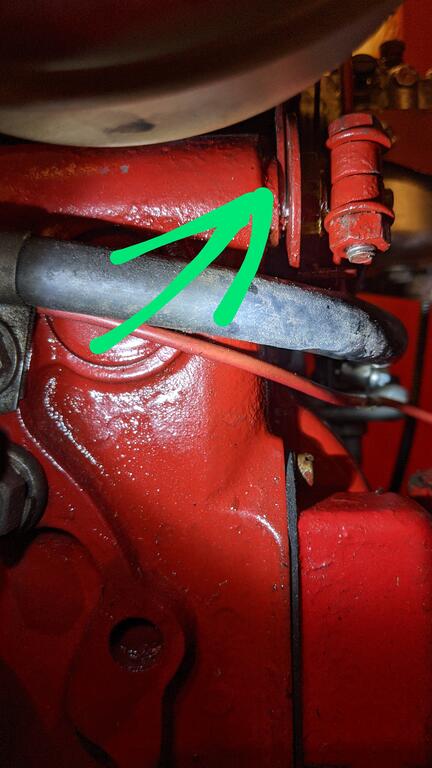

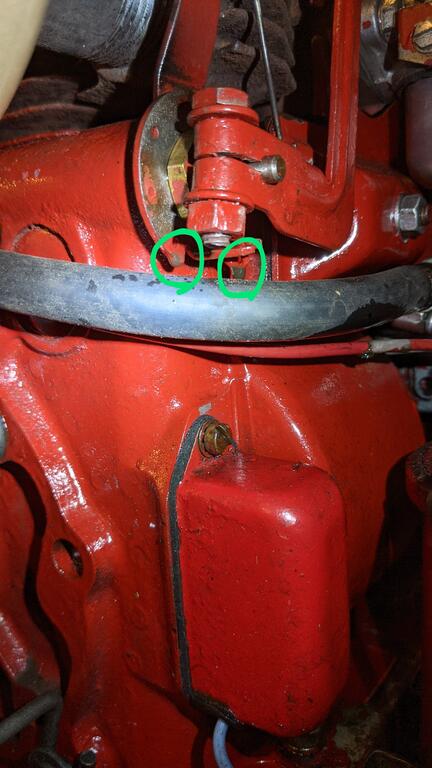

csvt99 173 #40 Posted April 4, 2023 5 hours ago, squonk said: Possible. It will leak from the pan when it's full of oil just sitting if the gasket slipped. It sat on the bench for a few month's with oil in it and didn't leak at all. I had torqued the bolts but sometimes I wonder if the spec is really tight enough. Here is where I think it is leaking. The oil pan gasket seems to be okay. 1 Share this post Link to post Share on other sites
squonk 48,325 #41 Posted April 4, 2023 No seal at the governor shaft. Check your oil level. Do not screw the dipstick in when you check it. Make sure it's not overfull. And check the oil for gas in it by smelling it. 1 Share this post Link to post Share on other sites
WHX?? 58,347 #42 Posted April 4, 2023 Most leak a bit in those spots. I have tried a o-ring on the governor shaft with no luck. Breather cover a thin coat of gasket maker works. Share this post Link to post Share on other sites
csvt99 173 #43 Posted April 4, 2023 2 hours ago, WHX?? said: Most leak a bit in those spots. I have tried a o-ring on the governor shaft with no luck. Breather cover a thin coat of gasket maker works. Thanks so much guys, this makes me feel better and helps with knowing what to expect. I will try to adjust the breather cover and seal it up with gasket maker. Regarding the oil pan bolts, I hand tightened them with a 6" long 1/2 inch wrench. Is it important to back them off to factory spec plus a bit or should I be okay as is? Share this post Link to post Share on other sites

csvt99 173 #50 Posted April 7, 2023 It looks like I will need to remove the fuel pump in order to get access the whole way around the breather to get gasket maker in there to seal it up. Does the oil come that far that I will have to drain it in order to remove the fuel pump without making a mess? Share this post Link to post Share on other sites
