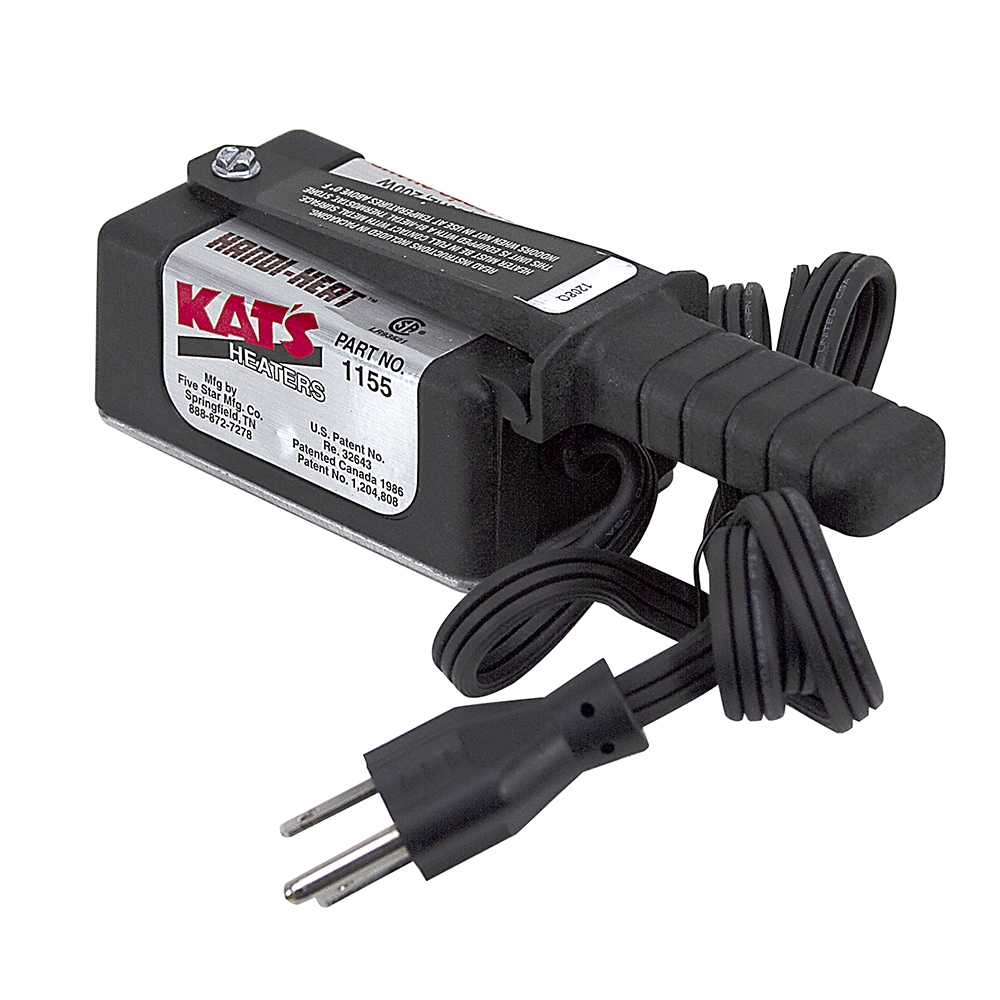

Bill D 2,770 #38 Posted January 8, 2025 How about sticking a magnetic oil pan heater on the bottom of the transmission? I saw several online. 3 Share this post Link to post Share on other sites
Bill D 2,770 #39 Posted January 8, 2025 12 minutes ago, ebinmaine said: BE EXTREMELY CAUTIOUS using this type. Most engines do NOT have enough fluid around the heating element. (Dipstick) I do NOT advise anyone to use them unless you're absolutely sure it's OK. Dipstick tube is plastic. Bad idea all around. 2 Share this post Link to post Share on other sites
Handy Don 16,279 #40 Posted January 8, 2025 On 12/31/2022 at 4:00 PM, Ed Kennell said: I have only Eatons now, but some of my past Sunstrands were filled with 10w30 and they all lifted instantly. I feel this slow cold lift is an Eaton quirk. It is a mystery though, why some are not slow. I’m gonna guess that the bypass valves in the “slow” ones are allowing fluid to bypass a sluggish hydro motor longer than the “fast” ones . (There are separate bypass valves for both forward and reverse motion--part of their job is to reduce shock on the hydro motor during rapid changes to the motion control input.) Share this post Link to post Share on other sites
Handy Don 16,279 #41 Posted January 8, 2025 20 minutes ago, Bill D said: How about sticking a magnetic oil pan heater on the bottom of the transmission? I saw several online. This sounds safest to me as long as it is sized correctly. Share this post Link to post Share on other sites
squonk 46,125 #42 Posted January 8, 2025 I have 3 of these. I put 2 on my Power King (both sides of the hyd. tank for the loader ) and one slapped to the bottom of my Sunstrand on my C-160 ( when it was used for plow duty) 3 Share this post Link to post Share on other sites
davem1111 2,274 #43 Posted January 14, 2025 On 1/8/2025 at 4:50 PM, squonk said: I have 3 of these. I put 2 on my Power King (both sides of the hyd. tank for the loader ) and one slapped to the bottom of my Sunstrand on my C-160 ( when it was used for plow duty) I picked up a couple of these at Menards - a bit pricey but well designed, magnetic so you just slap it on the trans or oil pan. I also bought 5 quarts of 10w30 synthetic, not Mobile 1 since they didn't have that brand but it's a similarly well-known brand, forget which now. I also found an OEM WH/Toro hydro filter that I forgot I had acquired along with a bunch of other parts. Drained the trans, changed the filter, re-filled the trans. Let it warm up a bit (and I think it was maybe around 30*, not teens or single digits) and it still seems to be displaying the same behavior. Hard to get it to move forward/backward for a while, and the lift doesn't work until I've moved the tractor forward and backward quite a bit, and it "quivers" then drops back down. Figuring at this point I'm going to have to swap the pump or the whole trans. I have a total of 4 Eaton 1100's on premise right now - this one, a "spare", and two other tractors that could end up being donors if necessary. We're headed for single digits and maybe negative temps really soon so I probably won't be messing with it for a while, unless we get significantly more snow. 1 Share this post Link to post Share on other sites
