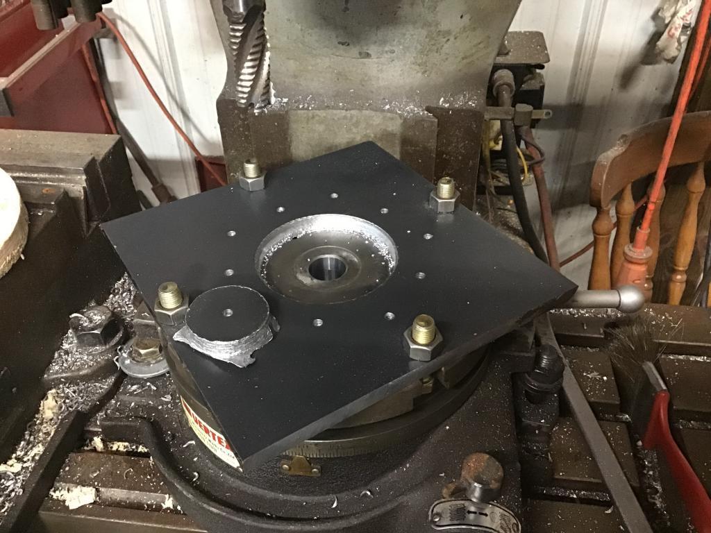

Pullstart 71,285 #32 Posted December 30, 2022 We got millin’ stuff… 3 1 Share this post Link to post Share on other sites

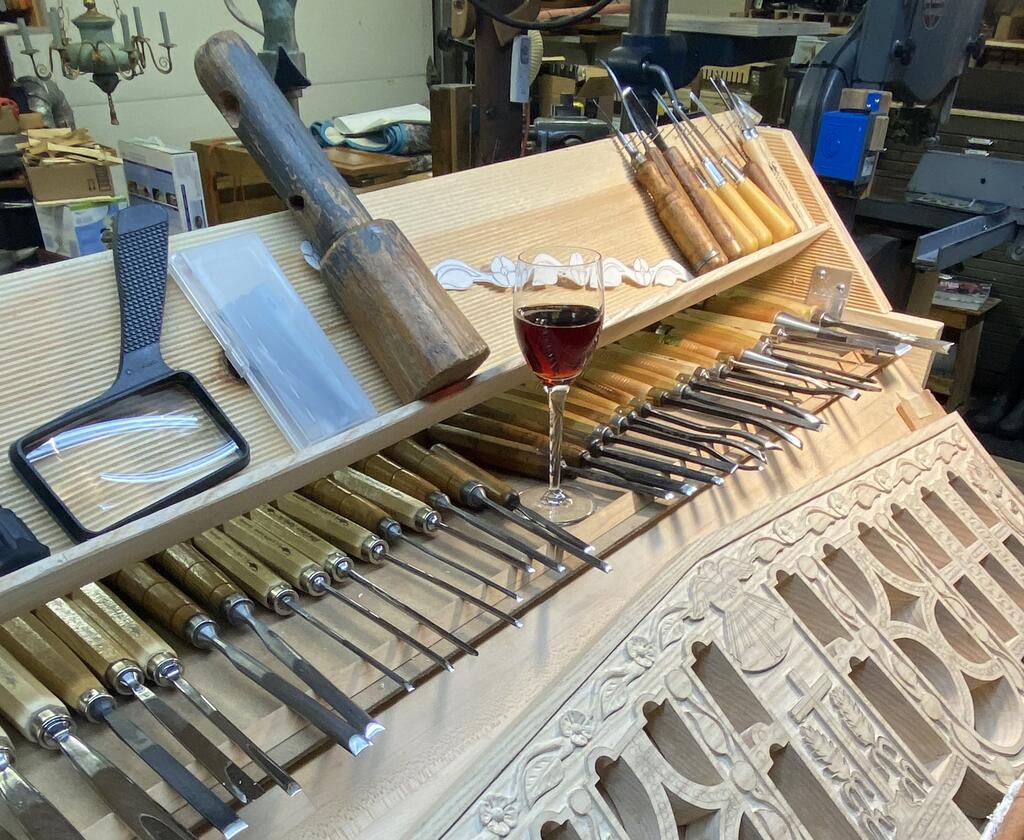

formariz 12,381 #33 Posted December 30, 2022 @ebinmaineI can understand the physical limitations or difficulties. I go through them all the time. While at it I use home remedies that not only dull the pain ,loosen the joints, but at the same time enhance creativity. Well proven. 1 1 3 Share this post Link to post Share on other sites

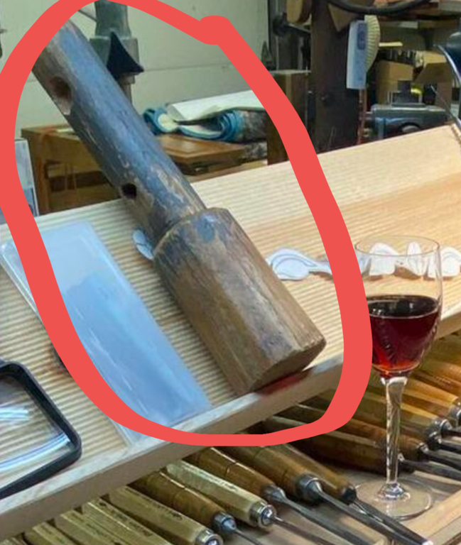

ebinmaine 80,757 #34 Posted December 31, 2022 (edited) On 12/30/2022 at 6:04 PM, formariz said: @ebinmaineI can understand the physical limitations or difficulties. I go through them all the time. While at it I use home remedies that not only dull the pain ,loosen the joints, but at the same time enhance creativity. Well proven. I know what the glass full is for. I use different substances with the same effect. I figure the big stick is for beatin' cranky body parts into submission. 😜 Edited January 4, 2023 by ebinmaine 2 4 Share this post Link to post Share on other sites

formariz 12,381 #36 Posted December 31, 2022 1 hour ago, ebinmaine said: I figure the big stick is for beatin' cranky body parts into submission No, it’s for the wife to beat me out of my stupor during one of the most creative sessions. 2 4 Share this post Link to post Share on other sites
