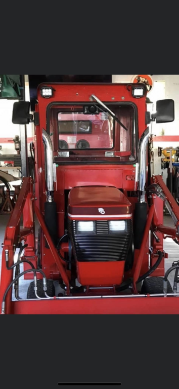

Randy Lindblad 71 #6 Posted December 28, 2022 I built my own 1 Share this post Link to post Share on other sites
WheelHorse520H 710 #7 Posted December 28, 2022 12 hours ago, Randy Lindblad said: I built my own I saw that picture of it and that's what gave me the idea. The biggest problems I am having is how to attach it. I don't want to drill into or weld to anything, and I don't have a welder or one that I can borrow so it can't be made of metal. 2 Share this post Link to post Share on other sites
