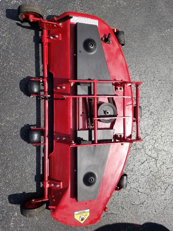

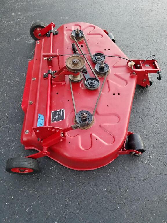

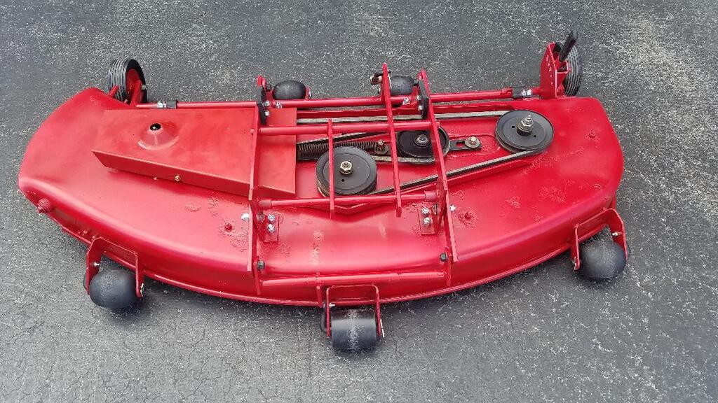

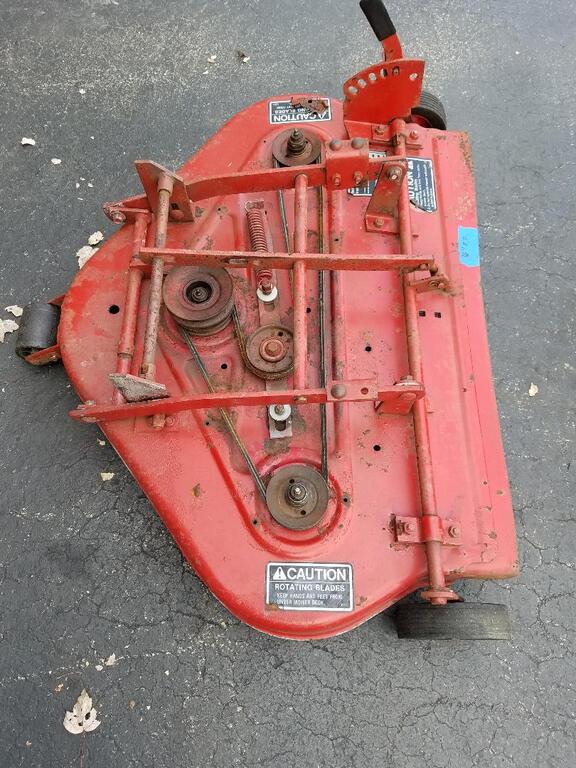

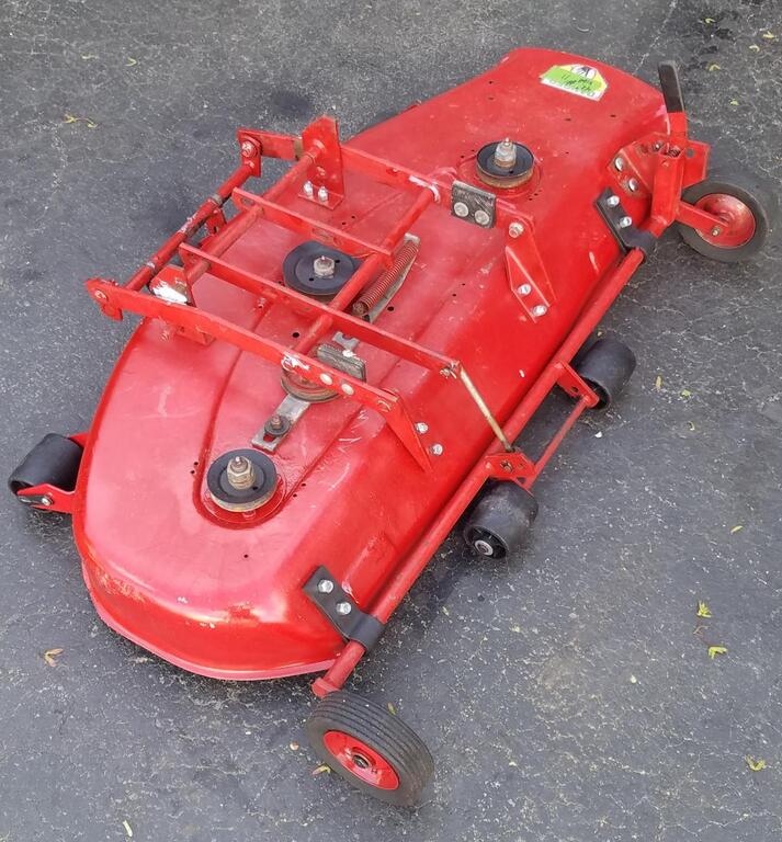

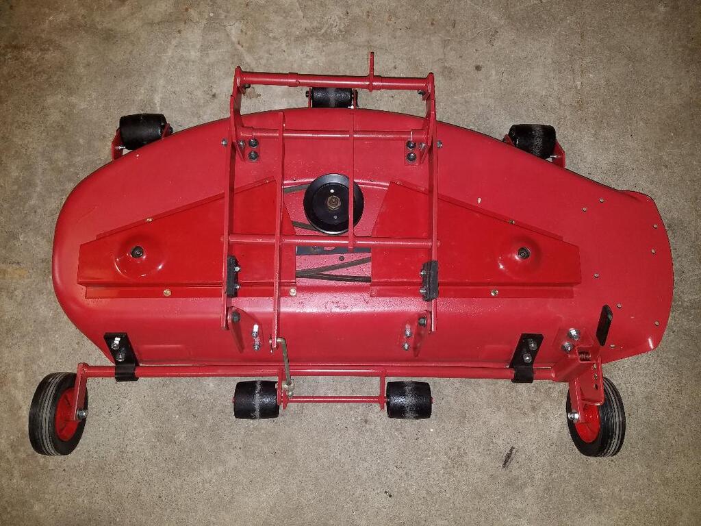

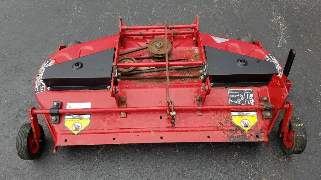

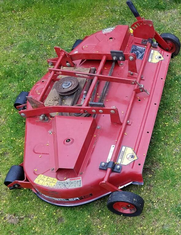

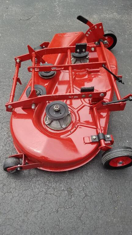

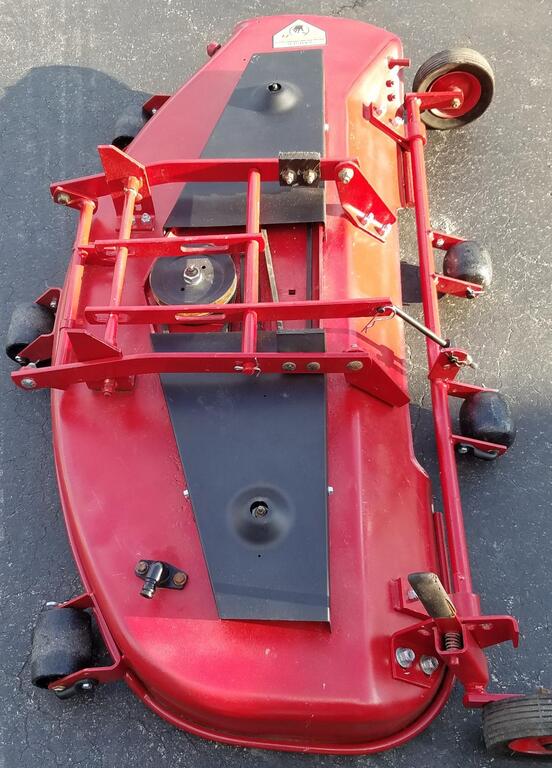

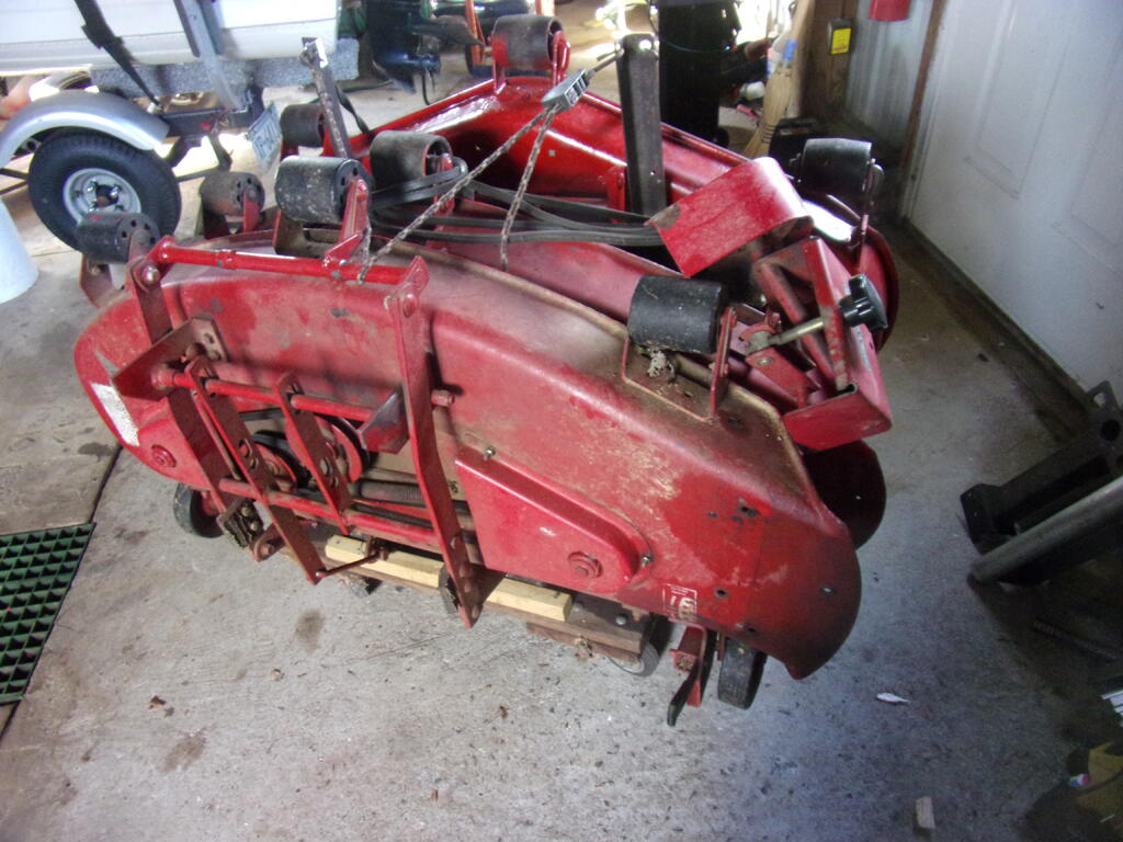

Brockport Bill 2,481 #5 Posted December 23, 2022 here are some photos of different model mowers and sizes as well as side and rear discharge --- 36,37,42,48, etc Share this post Link to post Share on other sites
