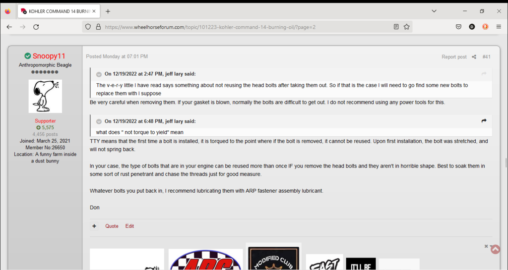

Snoopy11 5,731 #28 Posted December 21, 2022 12 hours ago, Jeff-C175 said: No... I'd be afraid they would chew up the aluminum head. But the K series have a steel washer under them so that shouldn't be an issue. Wouldn't use them without a washer on aluminum though. That is exactly the same logic that says that you need to put lock-tite on rod bolts. Some people even put lock washers on them. Those people have zero comprehension of the purpose of these types of bolts. If you use the 'right' kind of bolts, and torque the bolts correctly with an actual torque wrench, the bolts themselves stretch and actually act like springs. Bolt torque isn't just a term used so the bolts don't come loose. ARP has it right... nothing else need be said. I have never. AND I MEAN NEVER. Had cylinder head bolts come loose... on any engine that I have had in my possession... truck... machine... mower... whatever. @WHX??... I recommend legitimate fastener assembly lubricant. Don Share this post Link to post Share on other sites
