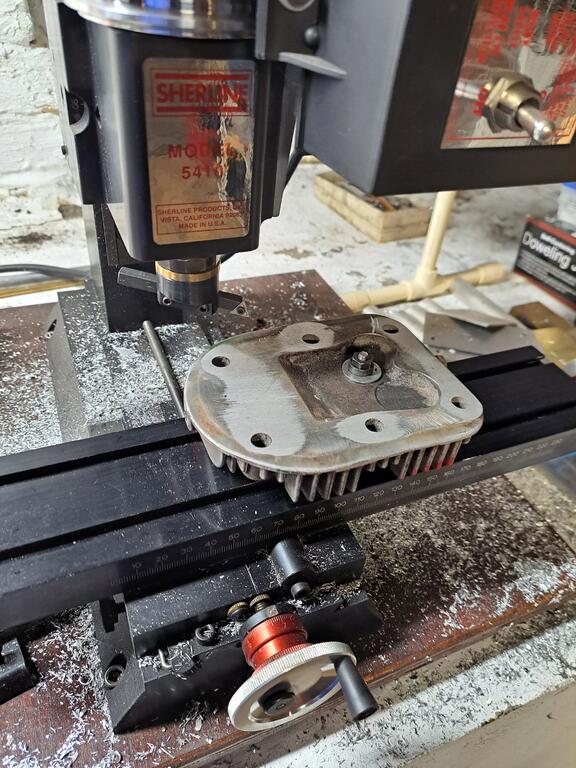

benjiboo 174 #1 Posted December 19, 2022 So on my K91 Kohler that came on my Suburban 400 I had noticed a little bit of oil bubbling between the head and block. Yummy....this means a head gasket/head work needed. So I pulled the head off and the head gasket actually looked like new without any burn through or anything like that. But....the head obviously hadn't been planed prior to replacing the gasket so...here are a few pictures of my process from beginning to the end result. 2 Share this post Link to post Share on other sites

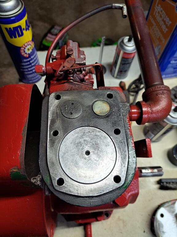

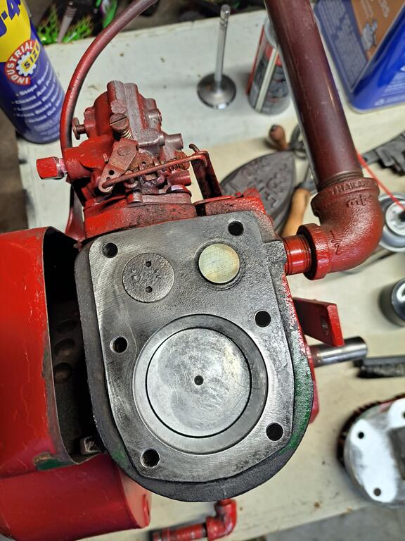

benjiboo 174 #3 Posted December 19, 2022 A few pictures of the condition of the block deck and cylinder bore. 3 1 Share this post Link to post Share on other sites

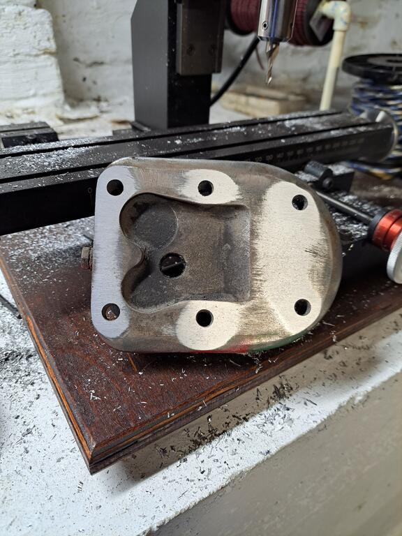

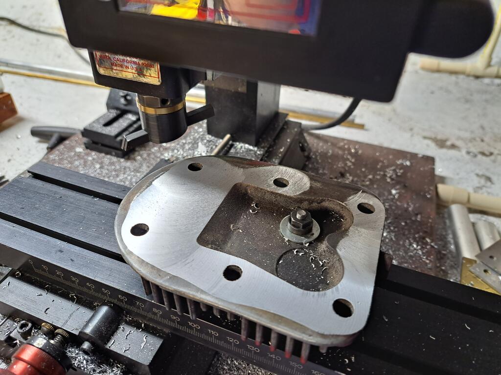

benjiboo 174 #4 Posted December 19, 2022 Here are the rest of the pictures of planning the head and the end result. 5 2 Share this post Link to post Share on other sites
