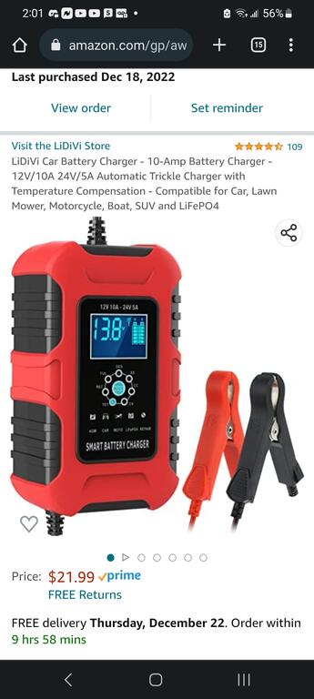

RED-Z06 2,720 #4 Posted December 19, 2022 (edited) Some maintainers dont put out 1/4 amp hardly while others put out enough to eventually hurt a battery, i use a NOCO Genius 1, 1 amp maintainer..its small enough to charge the little powersports and generator batteries, or maintain a 78series car battery. That said...if a battery freezes, it doesn't matter what charger is on it...the colder it gets the less power the battery has. A 340ca battery might hsve 280@32⁰...and if its a year old or has sulfidization on the plates, that number can dup under 150amps, and a cold engine needs more power to crank over. Put a 8 or 10 amp on it for an hour or 2...if it wont kick off its probably just bad...we had 1 cold snap in Florida and i had 3 batteries go bad overnight Edited December 19, 2022 by RED-Z06 3 Share this post Link to post Share on other sites

RED-Z06 2,720 #8 Posted December 19, 2022 3 minutes ago, Joe 77 B100 said: Its cold and supposed to get colder AND snow 4" so I have to get this figured out before the snow falls. When you say "put an 8 or 10amp on it", does that mean a regular batter charger rather than the maintainers I have been using. I haven't ever noted that the charger has amp readings on it. Just the 6v or 12v. Both of my maintainers are cheap, Menards brand maintainers. Clearly, not too familiar with batteries and such. Every charger should have an amp output rating, smart chargers will generally start at their peak output and step down to a low rate as the battery charges up. My charger let its smoke out yesterday so i ordered another cheap one..no sense spending alot, im hard on chargers. But as you see, its rated at 10amps 1 Share this post Link to post Share on other sites

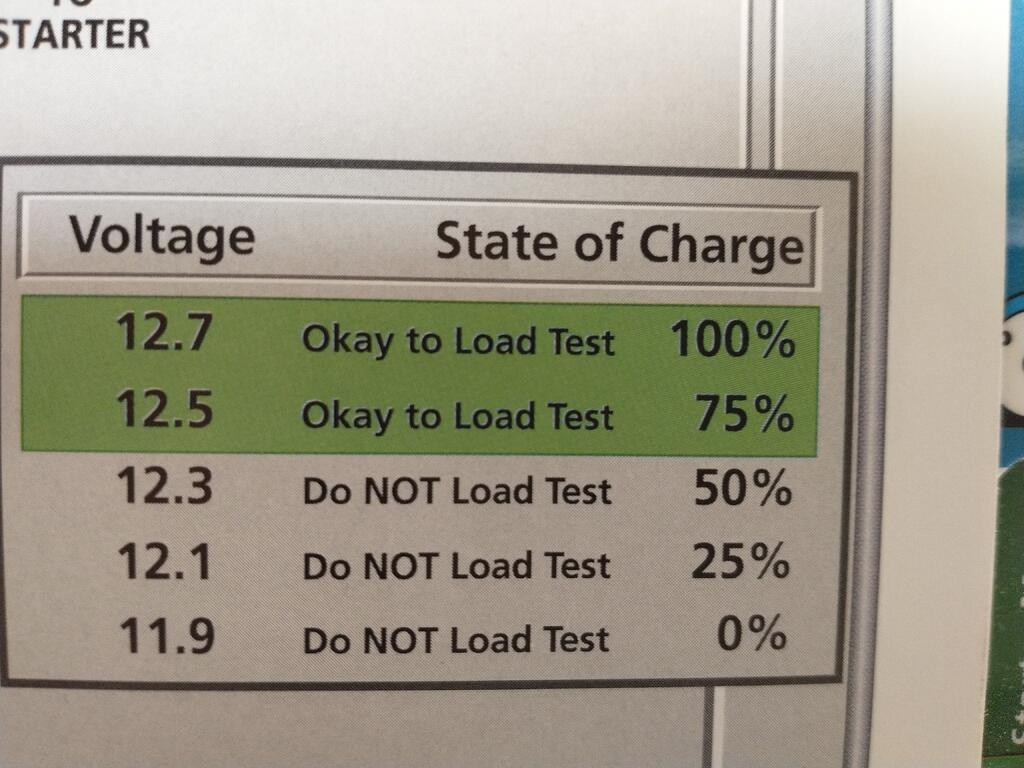

pfrederi 21,303 #9 Posted December 19, 2022 If the battery has been on a tickle charger for over 24 hours it should have enou0gh charge to start or at least crank the engine, 14 v is about right for a maintainer trickle charger. 4 Share this post Link to post Share on other sites
Pullstart 71,516 #10 Posted December 19, 2022 Most auto parts stores can load test the battery for free in hopes to sell another battery. My local store even charges it for a few hours for you before load testing it. 4 Share this post Link to post Share on other sites
lynnmor 9,073 #11 Posted December 19, 2022 1 minute ago, Pullstart said: Most auto parts stores can load test the battery for free in hopes to sell another battery. My local store even charges it for a few hours for you before load testing it. They should be fully charged to get a load test. It usually takes at least 10 hours to get a full charge. 2 Share this post Link to post Share on other sites
Pullstart 71,516 #12 Posted December 19, 2022 12 minutes ago, lynnmor said: They should be fully charged to get a load test. It usually takes at least 10 hours to get a full charge. I’m sure they’ll keep it as long as it needs to get full 2 Share this post Link to post Share on other sites
