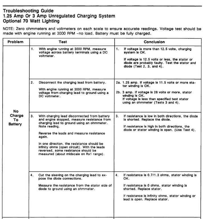

oliver2-44 11,758 #2 Posted December 19, 2022 Download the Kohler manual from the Manual Section on here. There is a good section on all the Kohler electrical. Also download the manual for you tractor and see the wiring diagram for it. 2 Share this post Link to post Share on other sites

pfrederi 21,172 #4 Posted December 19, 2022 First year for 310 was 1985 I believe. Do you have a model number? If it is 1985 310 it had the 3 amp unregulated system. 1 1 Share this post Link to post Share on other sites

pfrederi 21,172 #8 Posted December 21, 2022 The 3 amp system on my 310-8 works just fine. I would agree only if testing reveals your stator is bad then it would be worth the $$ for the upgrade. 1 Share this post Link to post Share on other sites
Rob R 989 #9 Posted December 21, 2022 A simple thing you can do and what solved my 310-charging issue was to simply remove the rectifier and clean and sand the back of the unit and the place where it mounts (especially if the tractor has been repainted). You have to have excellent grounding for the charging circuit to work. 1 Share this post Link to post Share on other sites
