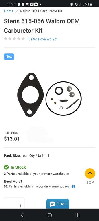

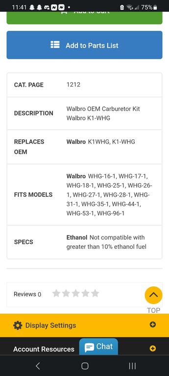

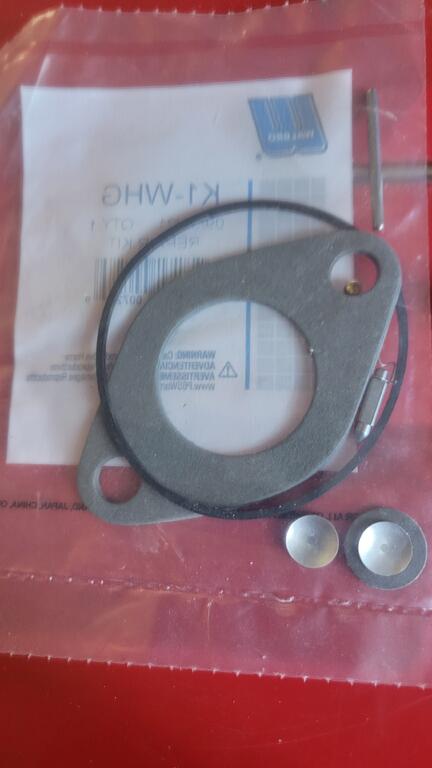

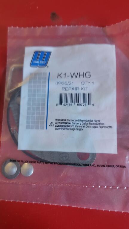

ebinmaine 81,139 #7 Posted December 19, 2022 24 minutes ago, pfrederi said: Most Techy parts manuals show a carb kit part number... Do you have that? Thanks Paul. Didn't know they had part numbers listed. I'll check it out. 22 minutes ago, WHX?? said: Guessing you checked fleabay? I know your not a fan but Chinese knockoff an option? I have at least one good solid mostly clean carb that I'd like to try to get gaskets and needle for. 8 minutes ago, pfrederi said: OHV is actually a vertical shaft engine...is that what you are working on??? Later model 16 horse are referred to as OHV for sure. 1974 model year the 12 horse was a flathead but the 16 has a separate valve cover box up on top. It's clearly an overhead valve engine but the serial numbers do state, HH. Interesting part about that is some of the small engine repair guys and other sources online refer to them as OHV160. Share this post Link to post Share on other sites
oliver2-44 11,816 #8 Posted December 19, 2022 One you find the part number put it in Mrs Google, she knows almost everything. 1 1 Share this post Link to post Share on other sites
RED-Z06 2,720 #9 Posted December 19, 2022 (edited) Got mine off Amazon for like 9 dollars a few months ago. Edited December 19, 2022 by RED-Z06 1 1 Share this post Link to post Share on other sites
ebinmaine 81,139 #10 Posted December 19, 2022 1 hour ago, RED-Z06 said: mine I have an LMH carb. How did you come up with that part number? Share this post Link to post Share on other sites
Snoopy11 5,731 #11 Posted December 19, 2022 Eric, if you want a quality kit... perhaps check out Randy's Engine Repair. I have used parts from them before.... EXCELLENT PEOPLE. Don't be afraid to give them a call. Not sure if this is the correct kit for you or not... but this is something like I was thinking... https://randysengine.repair/products/walbro-k1-whg-632445-carburetor-kit-common-on-oh160-oh180-oh140-oh120 Don Share this post Link to post Share on other sites
RED-Z06 2,720 #12 Posted December 19, 2022 5 minutes ago, ebinmaine said: I have an LMH carb. How did you come up with that part number? I looked my model and serial up when i was having flooding issues to have a kit on hand, turned out not to need a kit at all. If you have an LMH then the part number is K1-LMH. Walbro wasn't exactly big thinkers when it came to naming their rebuild kits. 1 Share this post Link to post Share on other sites
Handy Don 17,674 #13 Posted December 19, 2022 1 hour ago, RED-Z06 said: Walbro wasn't exactly big thinkers when it came to naming their rebuild kits IMHO it is harder to keep it simple! Three cheers for their designers/engineers/whoever. 1 Share this post Link to post Share on other sites
ebinmaine 81,139 #14 Posted December 19, 2022 1 hour ago, RED-Z06 said: I looked my model and serial up when i was having flooding issues to have a kit on hand, turned out not to need a kit at all. If you have an LMH then the part number is K1-LMH. Walbro wasn't exactly big thinkers when it came to naming their rebuild kits. My local small engine shop that I love to deal with has been nothing short of fantabulous to me over the years. Both of the guys that worked there tried to help me out by placing calls and emails on two different days not knowing that the other one had already done it. Neither one of them ever even got an answer. I gave him the wall bro number above and of course it just popped right up. Special bonus... Several dollars cheaper than anywhere online. Super cool. 1 1 Share this post Link to post Share on other sites
