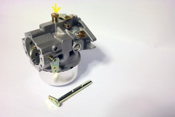

Snoopy11 5,731 #2 Posted December 18, 2022 Sounds like the machine is too rich. When is the last time you replaced the air filter? Could it be clogged? It could be a carburetor adjustment issue... as when you remove the air filter... you are allowing more air in. When you say "new carburetor" ...where exactly did you buy it? Did you buy a replacement that has an adjustable main jet needle? If the air filter is not clogged, and you did buy a carburetor that has an adjustment screw... try screwing the top screw on the carburetor clockwise, see if that solves your problem... Don 1 Share this post Link to post Share on other sites
