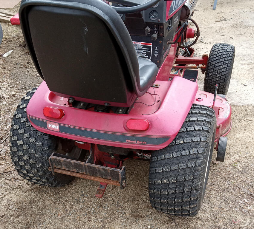

NA73 82 #1 Posted December 16, 2022 well, back in the spring due to the leaves/wet grass/mud, etc. I found the turf tires would get clogged too easily. so I borrowed a tire groover and went to work. to do both tires took a couple hours and having run it all summer and now into snow season it was well worth the time to do. so far, even in snow, the traction is just as good as chains. haven't had any real ice to test yet. and yes, that is a ber-vac weight bracket on the back. 9 5 Share this post Link to post Share on other sites
Pullstart 71,482 #2 Posted December 16, 2022 I see how you cut them to have opposing patterns. Let us know if either one works out better than the other…. I’ve thought about doing similar to some for grip testing… great post! 4 Share this post Link to post Share on other sites

SylvanLakeWH 32,776 #6 Posted December 17, 2022 3 hours ago, Pullstart said: I see how you cut them to have opposing patterns. Let us know if either one works out better than the other…. I’ve thought about doing similar to some for grip testing… great post! Curious - @NA73 did you do the two patterns as a test or...? I'm guessing you will get a different grip... look forward to hearing your impressions on which works better... 3 Share this post Link to post Share on other sites
NA73 82 #7 Posted December 17, 2022 I actually messed up when I started the 2nd tire and just continued the pattern. which is why the tires are the way they are. both patterns seem to work equally well. I haven't had either tire lose traction or clog up more than the other. 6 1 2 Share this post Link to post Share on other sites
