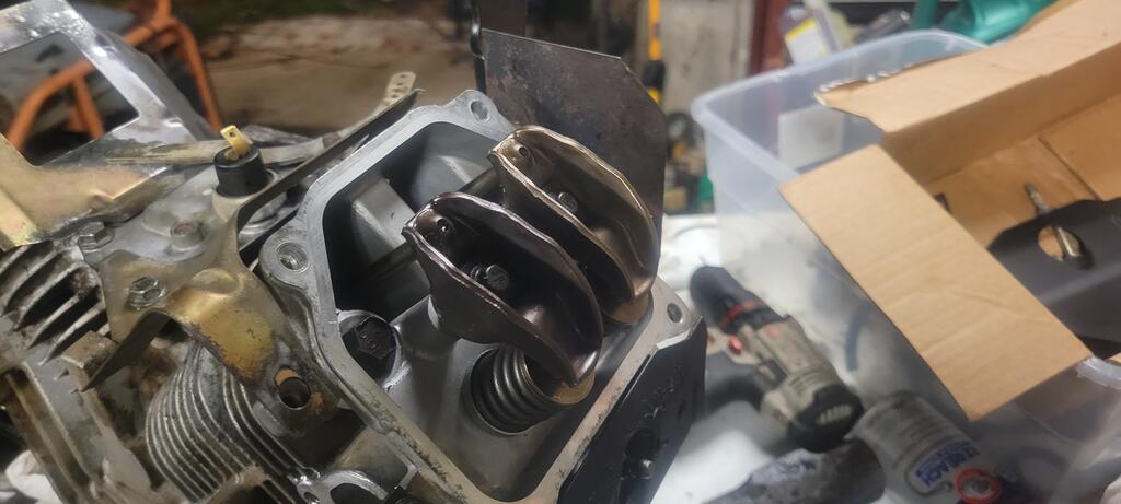

jeff lary 173 #59 Posted December 20, 2022 (edited) I agree this will need a head off look see. I was just really unsure how to deal with the rockers and push rods. That is why I stopped. That said if I had gone deeper would this have been the right things to do; Remove rocker arms mark their replacement positions (i.e.) PTO side vs flywheel side Remove push rods mark them as well Remove the head bolts a little at a time till all torque is released from each bolt Remove head and pray for bad head gasket... I would have absolutely gone further but I would have wanted someone here that had done this before to guide me the first time. I know I may have disappointed those that offered advice and for that I apologize. Thank you for all the responses and feel free to keep going on this if you wish I am still learning from you comments. Like I tried to explain in the beginning I was just kind of trying to feel my way through. Edited December 20, 2022 by jeff lary 1 Share this post Link to post Share on other sites
RED-Z06 2,700 #60 Posted December 21, 2022 (edited) 24 minutes ago, jeff lary said: I agree this will need a head off look see. I was just really unsure how to deal with the rockers and push rods. That is why I stopped. That said if I had gone deeper would this have been the right things to do; Remove rocker arms mark their replacement positions (i.e.) PTO side vs flywheel side Remove push rods mark them as well Remove the head bolts a little at a time till all torque is released from each bolt Remove head and pray for bad head gasket... I would have absolutely gone further but I would have wanted someone here that had done this before to guide me the first time. I know I may have disappointed those that offered advice and for that I apologize. Thank you for all the responses and feel free to keep going on this if you wish I am still learning from you comments. Like I tried to explain in the beginning I was just kind of trying to feel my way through. Yeah you can mark the rockers and push rods for position. On head bolts on aluminum engines i back them off by hand about a half turn then run them out with the impact..its alot of threads there. Then the head should lift off. On assembly i dan a little anti-seize on the head bolts and run them down with a 1/4" impact to flush then follow the torque procedure with the torque wrench. Here are some photos of a 1200hr command twin i rebuilt last year, it had the air filter pipe come loose after getting whacked with a tree branch and it was using about 15oz of oil an hour while mowing and would nuke a set of plugs in 3 hours. I did new rings, both cylinders cleaned right up with a light hone, cleaned both pistons, both rods showed no visible wear and it wasn't noisy. Cleaned the valves up and new guide seals. It ran perfectly and no smoke Edited December 21, 2022 by RED-Z06 Share this post Link to post Share on other sites

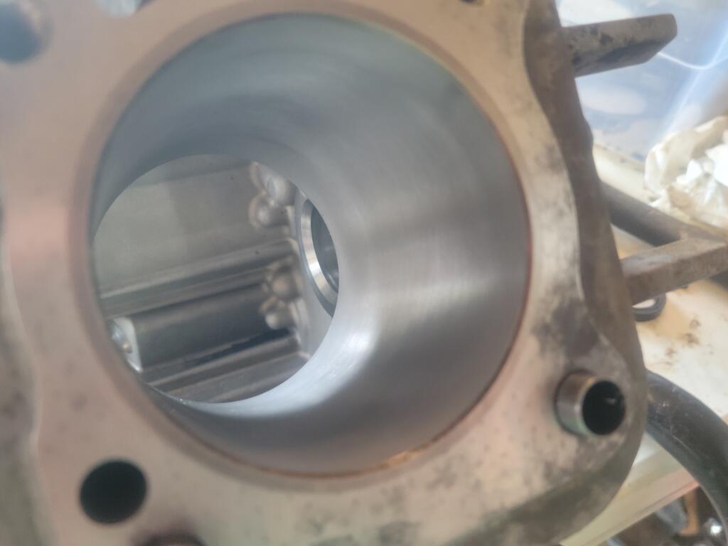

bds1984 1,506 #61 Posted December 21, 2022 That is probably the second dirtiest Kohler engine I have ever seen! Damn. My 315-8 I purchased years ago had a very similar issue. Burned a decent amount of oil, ran great, but only had 400 hours on it. I left the engine on the frame and began to inspect/disassemble to determine the cause. Well, the oil ring was wiped out which was strange since everything else was clean and showed no wear as everything spec'd out. The air filter was not compromised so I sometimes wonder if the rings were defective. Oh well. So a light hone, new rings, gaskets, and copious amounts of flushing she is thumping along side my other Horses using very, very little fuel. This is my only OHV horse and she sounds more like a four-wheeler than a garden tractor. 1 Share this post Link to post Share on other sites
RED-Z06 2,700 #62 Posted December 21, 2022 22 minutes ago, bds1984 said: That is probably the second dirtiest Kohler engine I have ever seen! Damn. My 315-8 I purchased years ago had a very similar issue. Burned a decent amount of oil, ran great, but only had 400 hours on it. I left the engine on the frame and began to inspect/disassemble to determine the cause. Well, the oil ring was wiped out which was strange since everything else was clean and showed no wear as everything spec'd out. The air filter was not compromised so I sometimes wonder if the rings were defective. Oh well. So a light hone, new rings, gaskets, and copious amounts of flushing she is thumping along side my other Horses using very, very little fuel. This is my only OHV horse and she sounds more like a four-wheeler than a garden tractor. The crankcase pressure had blown the upper crank seal out so it had been bleeding badly, but ill say it fired right up, i cranked it with the plugs out about 10 seconds then put the plugs in and it kicked Right over. Kohler Commands are among my favorite engines from an architectural standpoint, ive seen them well over 3500 hours..still kicking Share this post Link to post Share on other sites

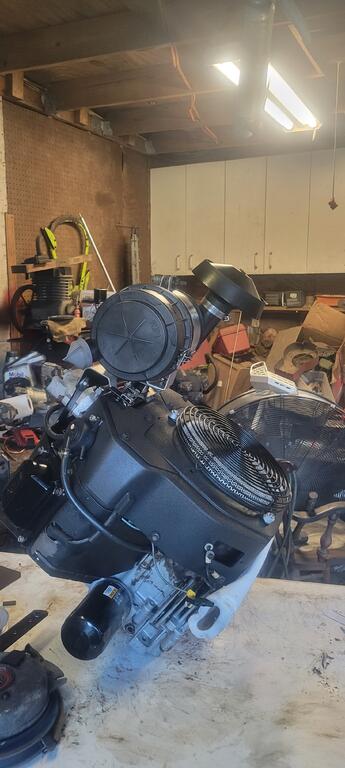

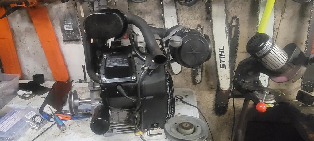

jeff lary 173 #72 Posted January 2, 2023 I removed the engine yesterday I will get it to the shop as soon as he has the room for it. If I could just be around someone doing it for the first time I would have had enough confidence to do the work myself the next time. In any case I am doing a few other things while the engine is off and the tractor is in the shop. I am going to replace the main drive belt and have run a new Fuel line. I assume the line there is the original so its time for new. I have the deck off and cleaned up underneath that and now ready for some sort of paint. I will do that this week I think I have some industrial urethane gray primer I will put a few coats of that on it. We used to use it before the orange top coat when painting snowplows she is some rugged stuff for sure. Checked the rear gear case oil level that is as clean as the day it was poured into it. Going to look all the wires over closely and clean the grounds and put the engine back in when completed. I will post then when I know what he found inside. 1 Share this post Link to post Share on other sites
