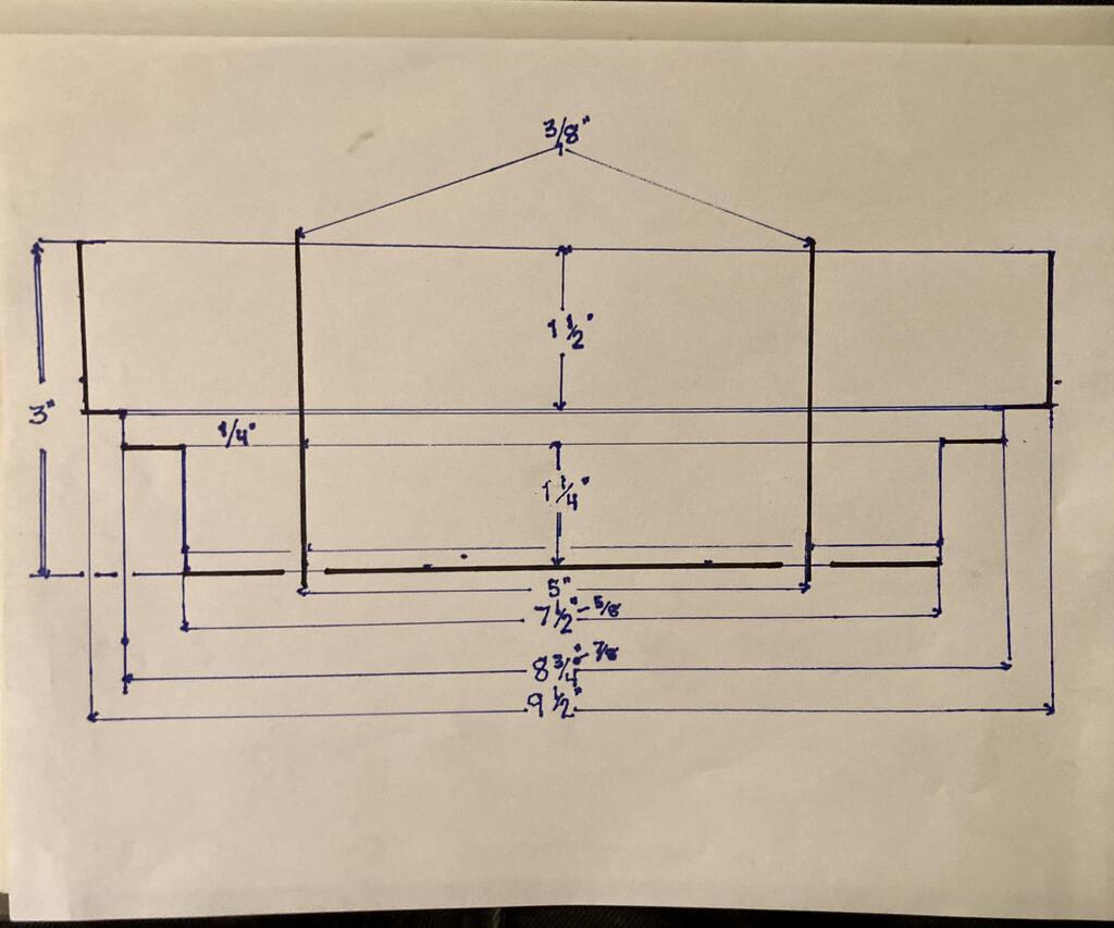

"Manic-Mechanic" 1,485 #1 Posted December 15, 2022 (edited) (3" x 9" Steel Blank Weighs @ 69 lbs) This is a rough drawing to give the general idea of the weight design, all the final tweaks will be done in shop as a wheel is on the bench for reference. To avoid all the critique. Edited December 16, 2022 by "Manic-Mechanic" 4 1 Share this post Link to post Share on other sites
Jeff-C175 7,209 #2 Posted December 15, 2022 22 minutes ago, "Manic-Mechanic" said: 3" x 9" Steel Blank Weighs @ 69 lbs You getting ready to fire up the forge and cast them? Or???? 3 Share this post Link to post Share on other sites
"Manic-Mechanic" 1,485 #3 Posted December 15, 2022 10 minutes ago, Jeff-C175 said: You getting ready to fire up the forge and cast them? Or???? No, I wish! A cut from Stock 9-1/2" Round, then to the CNC Lathe 3 2 Share this post Link to post Share on other sites
Jeff-C175 7,209 #4 Posted December 15, 2022 26 minutes ago, "Manic-Mechanic" said: No, I wish! A cut from Stock 9-1/2" Round, then to the CNC Lathe I think I'd make the bolt holes 1/2" 1 Share this post Link to post Share on other sites
"Manic-Mechanic" 1,485 #5 Posted December 15, 2022 3 minutes ago, Jeff-C175 said: I think I'd make the bolt holes 1/2" Well, I have the option to go larger, however, to use a 1/2" bolt would require enlarging the holes in the rims. 1 Share this post Link to post Share on other sites
Jeff-C175 7,209 #6 Posted December 15, 2022 (edited) 52 minutes ago, "Manic-Mechanic" said: Well, I have the option to go larger, however, to use a 1/2" bolt would require enlarging the holes in the rims. My thinking is that you might want a little 'wiggle room' when trying to wrassle a 65 Lb weight into place. Still use the 3/8" bolt... just make the hole larger to ease installation. Edited December 15, 2022 by Jeff-C175 2 Share this post Link to post Share on other sites
"Manic-Mechanic" 1,485 #7 Posted December 16, 2022 (edited) 1 hour ago, Jeff-C175 said: My thinking is that you might want a little 'wiggle room' when trying to wrassle a 65 Lb weight into place. Still use the 3/8" bolt... just make the hole larger to ease installation. No, I'm good. The holes in the rim are a bit larger already, but not large enough for 1/2". The shop will know already to make the holes slightly over, but not all the way to 1/2" 60-65lb for me is pretty light. Know the exact weight then after all the tweaks, chamfers, etc. Edited December 16, 2022 by "Manic-Mechanic" 2 Share this post Link to post Share on other sites
ri702bill 12,169 #8 Posted December 16, 2022 Don't you need a blind hole from the backside to clear the spindle hub?? Excellent, but expensive for the material. There were two different bolt hole sizes AND spacing over the years. All my early tractors use 1/2" fasteners. the C81 uses 3/8" at a different spacing. Found that out while making the set for the C81... Bill Share this post Link to post Share on other sites
"Manic-Mechanic" 1,485 #9 Posted December 16, 2022 19 minutes ago, ri702bill said: Don't you need a blind hole from the backside to clear the spindle hub?? Excellent, but expensive for the material. There were two different bolt hole sizes AND spacing over the years. All my early tractors use 1/2" fasteners. the C81 uses 3/8" at a different spacing. Found that out while making the set for the C81... Bill The depth of the weight does not hit the hub. Yes 100 a weight is high, but finding a pair and then paying shipping, way more. Wheel Horse weights are light and too expensive if found, last set I found guy wants 300 before shipping for a rusty pair of front weights. Yes, the spacing can be different. I have also seen weights that are threaded and bolted from the backside of the wheel, thinking they are rear weights for 8" wheel on a lawn mower. Love to have that tractor! 1 Share this post Link to post Share on other sites
