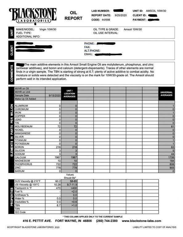

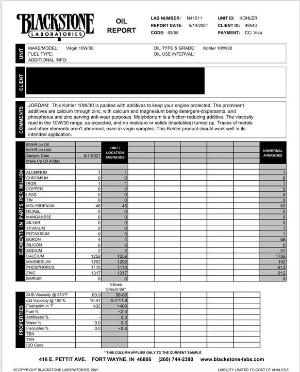

bds1984 1,506 #9 Posted December 14, 2022 So if any of you are looking to deep dive on VOAs (virgin oil analysis), here you go. Diesel Oils PCMO (Passenger Car Motor Oils) Best bet for zinc in readily available oil AND not overpriced seems to be Motorcraft and Wolf's Head 15W40. And for S&Gs, here are two photos of VOAs for Kohler and Amsoil small engine oils. 1 Share this post Link to post Share on other sites
