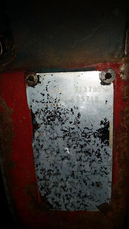

WHX?? 58,347 #1 Posted December 14, 2022 (edited) Courtin & sparkin one but be nice to know her age ? Best pic I have ... K161 T 713795 Stamped in the serial Spec 28571E It has both electric and Fairbanks recoil pullstart. Edited December 14, 2022 by WHX?? Share this post Link to post Share on other sites

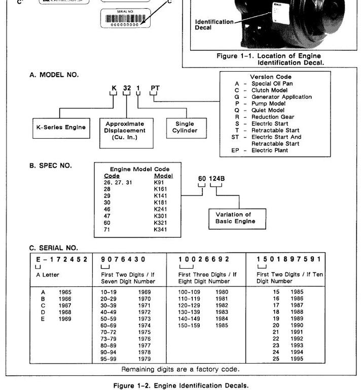

pfrederi 21,303 #2 Posted December 14, 2022 Made for DEMCO Co. 6 digit serial should be prefaced with a Letter A - E 1965 -1969 2 1 Share this post Link to post Share on other sites

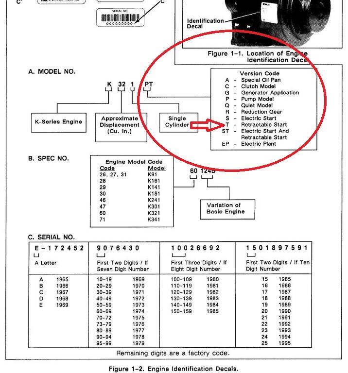

pfrederi 21,303 #5 Posted December 15, 2022 2 hours ago, WHX?? said: Correct Paul off a DEMCO tractor. Prefaced with the T Sorry but Kohler manual doesn't indicate a T prefix What is a Demco??? 1 Share this post Link to post Share on other sites
wallfish 20,733 #6 Posted December 15, 2022 (edited) Pretty sure this is what he meant K161 T 713795 Stamped in the serial Edited December 15, 2022 by wallfish 1 Share this post Link to post Share on other sites

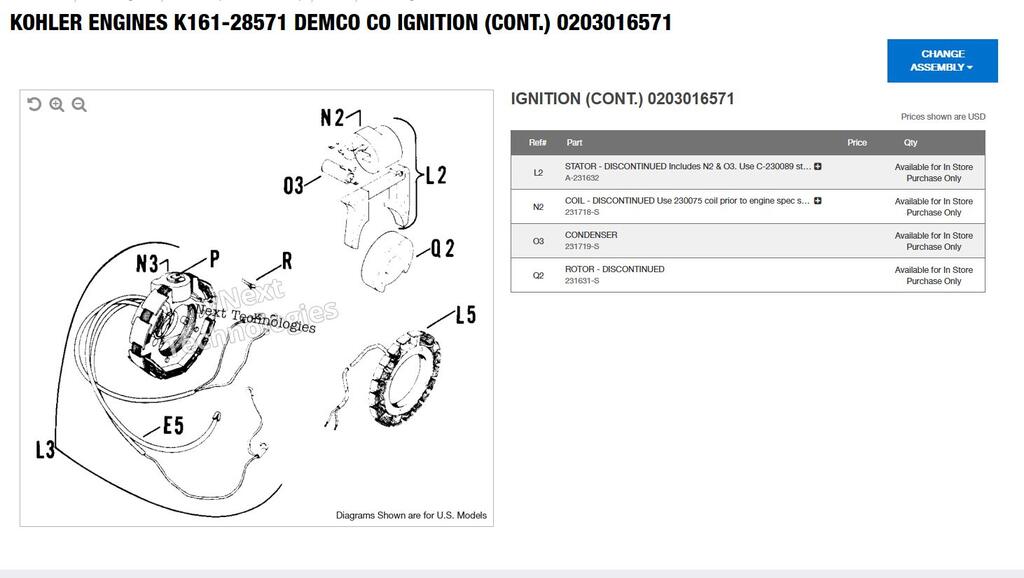

WHX?? 58,347 #7 Posted December 15, 2022 (edited) Correct 'Fish... this one also has a SG and trying to finger out if this is the original motor. Was thought to be magneto ignition but no magnets under the flywheel. Some signs say yes some say no. It has the correct hardware but lots of blue paint under red. Not to say it was repainted for OEM. All comes down to who knows what in 50 + years. DEMCO = Design Engineering & Manufacturing Co. Paul...short lived company that was bought out by ...you guessed it ...AMC ... who wanted to cut corners and led to the demise of Amigos. AARON DAVIS.docx Edited December 15, 2022 by WHX?? 2 Share this post Link to post Share on other sites

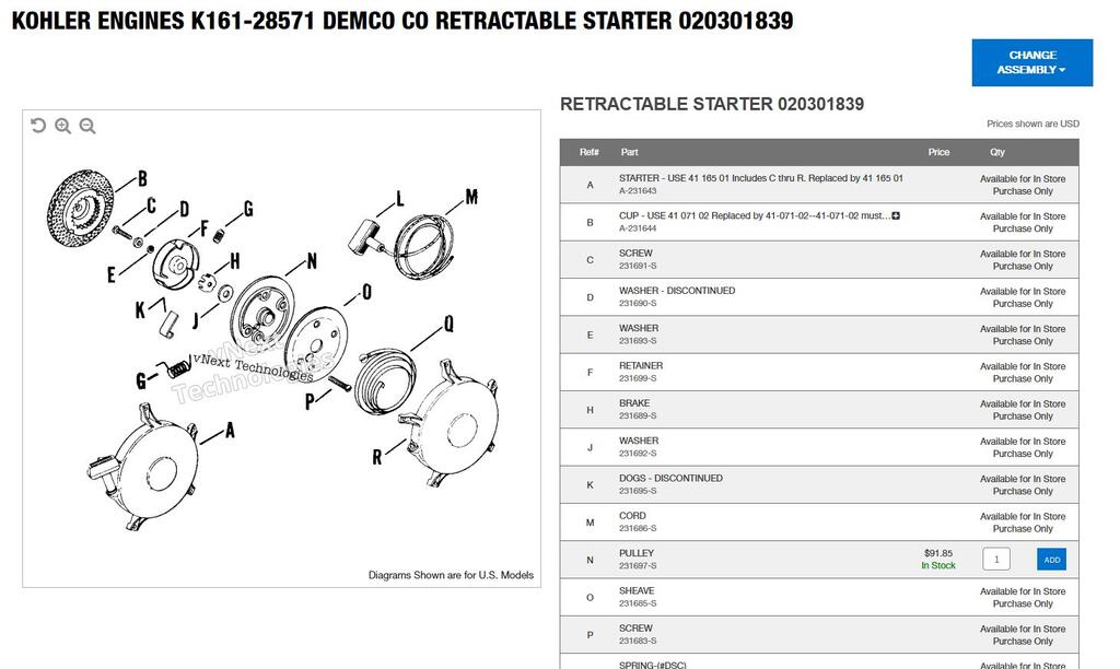

pfrederi 21,303 #10 Posted December 15, 2022 Interesting info on the Amigo /Demco Some as built info on the engine 2 Share this post Link to post Share on other sites
