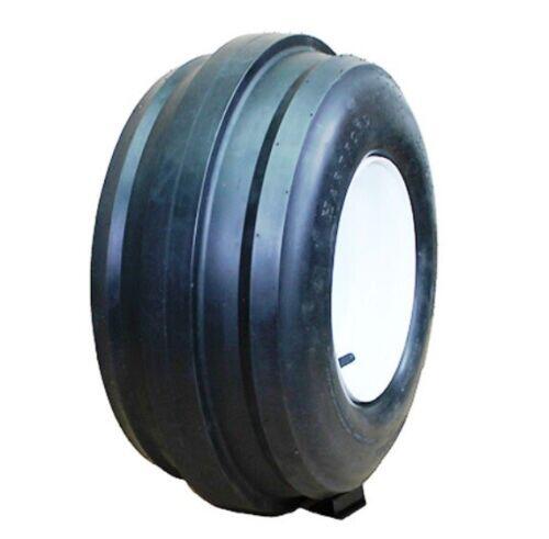

"Manic-Mechanic" 1,485 #1 Posted December 14, 2022 (edited) I have had several treads on the front of the 18 Auto and find maneuverability over ground & Snow, ,almost pointless. On top of asphalt or cement no problem. I am considering the Tri Rib. Any thoughts on these and the claim to add easier steering? Better maneuverability on Snow? Edited December 14, 2022 by "Manic-Mechanic" Share this post Link to post Share on other sites
ebinmaine 78,097 #2 Posted December 14, 2022 IMHO --- WEIGHT will be your best friend. ANY rubber no matter what shape won't match chains. I have a set of 20 x 8 x 8 turfs on the front of my snow tractor. Fluid filled. 5 gallons each. Approximately adds 55 lbs per side. It's pretty good except on ice or really tough heavy snow. Some folks use snowblower tires and get good results. I don't believe the tri-ribs would please you for winter steering. 2 Share this post Link to post Share on other sites
SylvanLakeWH 31,002 #3 Posted December 14, 2022 I use turf tires in rear and front, no chains. Works for me plowing Michigan slop snow on three flat concrete drives. I would think tri-ribs would be very poor performing in snow but i have no personal experience with them... I would think same reason they turn easy on pavement and dirt would be same reason they wouldn't turn on snow - very little surface area... just my Share this post Link to post Share on other sites

"Manic-Mechanic" 1,485 #5 Posted December 14, 2022 2 minutes ago, SylvanLakeWH said: I use turf tires in rear and front, no chains. Works for me plowing Michigan slop snow on three flat concrete drives. I would think tri-ribs would be very poor performing in snow but i have no personal experience with them... I would think same reason they turn easy on pavement and dirt would be same reason they wouldn't turn on snow - very little surface area... just my Yes, Eric was just mentioning this as well. Sounds logical to me. Toss that idea! Keep the turfs and look at weight. Now on the rear I have 32" tall ags sitting on 16" rims. Thinking now should've went wider? Tires are costly so, glad to refrain from the Tri rib. Share this post Link to post Share on other sites
Achto 31,467 #6 Posted December 14, 2022 (edited) 40 minutes ago, "Manic-Mechanic" said: I am considering the Tri Rib. Any thoughts on these and the claim to add easier steering? Better maneuverability on Snow? At the steering wheel, on hard ground tri ribs will make it feel like you power steering compared to turf tires. Don't know how they are for traction in the snow. I but a set of these on the front of my snow plowing tractor. With these tires my tractor always goes where I point it. No added weight on the front. https://www.amazon.com/Carlisle-Trac-ATV-Bias-Tire/dp/B001THCJDO/ref=sr_1_2?crid=K6XFHZZWJ0VA&keywords=6.5+x+8+snowblower+tires&qid=1670978625&s=automotive&sprefix=6.5+x+8+snowblower+tires%2Cautomotive%2C120&sr=1-2 Edited December 14, 2022 by Achto 1 2 Share this post Link to post Share on other sites

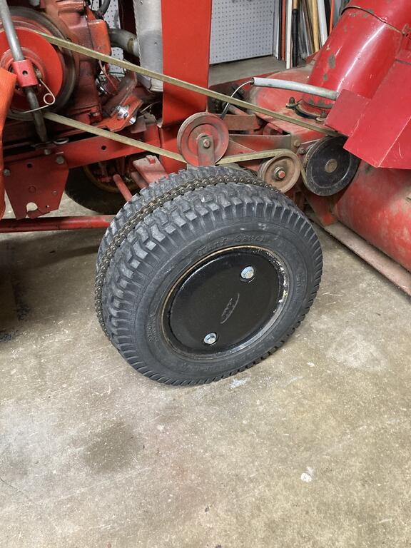

Blasterdad 3,163 #9 Posted December 14, 2022 6 minutes ago, Darb1964 said: Weight and chains, weight and chains. 4 1 Share this post Link to post Share on other sites
"Manic-Mechanic" 1,485 #10 Posted December 14, 2022 1 minute ago, Blasterdad said: Yes! I seen those last year, just figure up the links on 35 chain? Share this post Link to post Share on other sites
Darb1964 1,166 #11 Posted December 14, 2022 1 minute ago, Blasterdad said: Yes that 1 1 Share this post Link to post Share on other sites
"Manic-Mechanic" 1,485 #12 Posted December 14, 2022 1 minute ago, Darb1964 said: Yes that 1 Share this post Link to post Share on other sites
Blasterdad 3,163 #13 Posted December 14, 2022 1 minute ago, Darb1964 said: Yes that #40 roller chain, old chains from the snowblower, perfect length. 1 1 Share this post Link to post Share on other sites
Blasterdad 3,163 #14 Posted December 14, 2022 4 minutes ago, "Manic-Mechanic" said: Yes! I seen those last year, just figure up the links on 35 chain? About 100 links... Depending on tire... 1 Share this post Link to post Share on other sites
Blasterdad 3,163 #15 Posted December 14, 2022 Mine are #40, thats what size the snowblower uses. 1 1 Share this post Link to post Share on other sites

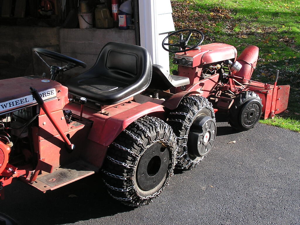

ri702bill 11,688 #17 Posted December 14, 2022 10 hours ago, Darb1964 said: Weight and chains, weight and chains. My version- Weights - 4, Fluid Filled tubed tires - 4, Chains - rear, Turf tires - rear, AG tires - front, (AG'g stay on all year, without the homemade weights in the summer) 1 2 Share this post Link to post Share on other sites
oldlineman 1,664 #18 Posted December 14, 2022 (edited) Edited December 14, 2022 by oldlineman This is what I use 1979 c-1o1, wrap the front tires with #40 chain best thing I have done for winter steering , like its glued to the ground. Bob 3 1 Share this post Link to post Share on other sites
