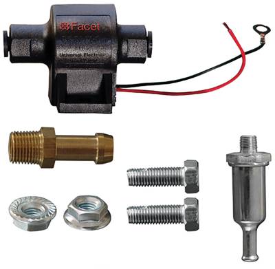

squonk 45,531 #7 Posted December 12, 2022 I pay a bit more for an electric pump at Napa. # 610-1051, $79.00 now. But if it fails I can get another one in 15 minutes and be running again. 1 1 Share this post Link to post Share on other sites
John Rizzardi 70 #8 Posted December 12, 2022 31 minutes ago, squonk said: I pay a bit more for an electric pump at Napa. # 610-1051, $79.00 now. But if it fails I can get another one in 15 minutes and be running again. That is the exact one i took off my machine and replaced with exact same one at NAPA today, no idea how old the “old” one was, but that is the same pump now in a box on DR table till i go out later today and swap it out, there was a filter on discharge side of pump (‘tween pmp and Carburator, on the intake side of pmp was was what i thought had to be check vlv!, I mean who puts 2 fuel filters on gas line?, never got fuel THAT dirty, until in the box with new pmp was what is in lower right corner of your picture, fuel filter, old one ‘tween pmp outlet and Carb looked old and shot, its out and i put new fuel filter ‘tween suction side of pmp snd Petcock at tank, now located under seat, still not gonna use 2nd filter( new one that came with fuel pmp). Thanks for reaching out, and the pic of pump that i too purchased st NAPA (for $79 as well.) 3 Share this post Link to post Share on other sites
squonk 45,531 #9 Posted December 12, 2022 These electric pumps want to push not pull. Mount it as close to the tank as you can. 3 1 Share this post Link to post Share on other sites
