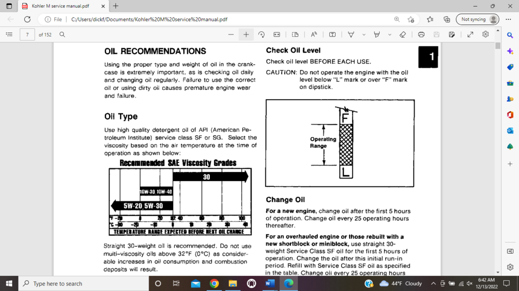

953 nut 69,476 #26 Posted December 13, 2022 When I lived in Florida I put in a lot of hours mowing my lawn at ambient temperatures well over 90 degrees Fahrenheit without any oil problems. This Kohler M Twin (same as KT except the ignition) manual shows the temperature range to be 32 to over 100 degrees Fahrenheit tor 30 weight. 1 Share this post Link to post Share on other sites
Brockport Bill 2,478 #27 Posted December 13, 2022 yes -- my plan is to use the 5w or 10w for winter..... and the straight 30w starting early summer oil change for warmer outdoors temps -- the original issue i asked about was more about the alpha designations of the API and of SG, SH, Sn etc - gotten some feedback on the alphas, but that's the info I am still seeking to learn more about ? Thanks Share this post Link to post Share on other sites
