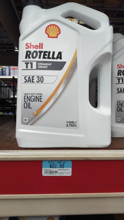

Bill D 3,100 #2 Posted December 12, 2022 If you want to really baby those old engines spring for Amsoil small engine oil. Very pricey. If the tractor is going to be inside in a warm place use Rotella T1 30W. Much cheaper. 4 2 Share this post Link to post Share on other sites

Achto 32,347 #4 Posted December 12, 2022 (edited) 3 hours ago, Brockport Bill said: API Service SP, "SN plus, SN" As oil is improved the API S# increases. At the time your engine was built SG & SH were the latest and greatest. I run Rotella 30wt diesel oil in all of my K model Kohlers, it has more "dino juice" & less synthetic additives in it. Edited December 12, 2022 by Achto 2 2 Share this post Link to post Share on other sites
953 nut 68,511 #5 Posted December 12, 2022 25 minutes ago, Achto said: I run Rotella 30wt diesel oil in all of my K model Kohlers We have had lots of threads about motor oil over the years and diesel 30 weight motor oil has been the consistent winner. Here are a few hundred oil related threads. https://www.wheelhorseforum.com/search/?&q= oil&type=forums_topic&search_and_or=and&search_in=titles&sortby=relevancy 2 2 Share this post Link to post Share on other sites
oldlineman 1,800 #6 Posted December 12, 2022 I only run Rotella HD 30, have had 0 problems. Bob 1 3 Share this post Link to post Share on other sites

pfrederi 21,050 #8 Posted December 12, 2022 The higher the letter the newer more advanced the oil. They are backward compatible (except for the issue of flat tappets and the lack of ZDDP) but that has been an issue for the last couple of iterations. If you have SN oil I would recommend you add a ZDDP supplement. When KT17s were made oils at that time had adequate ZDDP 1 Share this post Link to post Share on other sites
Jeff-C175 7,211 #9 Posted December 12, 2022 (edited) Quote adequate ZDDP @Brockport Bill And remember... MORE is NOT better! If you look up the oil spec, and read the directions on the ZDDP bottle, then do the math, you will find that if you use the 30W T1 Rotella, that 1 Oz per Quart (of the Rislone brand) gives adequate Zn levels. Adding more can cause the oil to become acidic over time and that's worse than no Zn at all! Edited December 12, 2022 by Jeff-C175 1 1 Share this post Link to post Share on other sites

Brockport Bill 2,455 #11 Posted December 12, 2022 1 hour ago, Jeff-C175 said: @Brockport Bill And remember... MORE is NOT better! If you look up the oil spec, and read the directions on the ZDDP bottle, then do the math, you will find that if you use the 30W T1 Rotella, that 1 Oz per Quart (of the Rislone brand) gives adequate Zn levels. Adding more can cause the oil to become acidic over time and that's worse than no Zn at all! Jeff -- the 1 oz is the info i needed -- 2 Share this post Link to post Share on other sites
