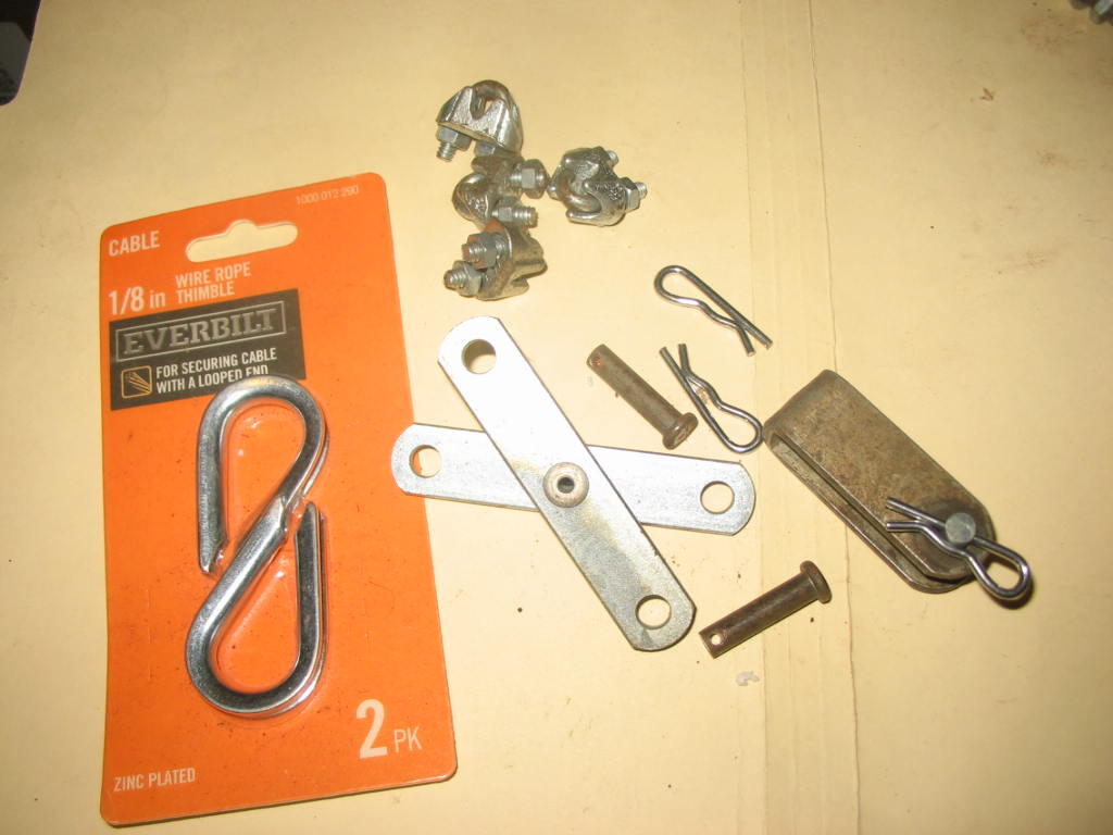

squonk 48,215 #26 Posted December 12, 2022 I have the ferrule crimper tool that looks like bolt cutters. They do not crimp tight enough to keep a ferrule on if lifting say a 10" plow 2 1 Share this post Link to post Share on other sites

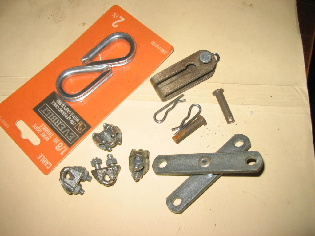

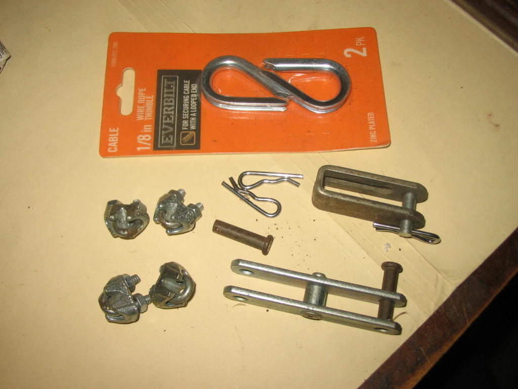

daveoman1966 3,884 #27 Posted December 12, 2022 (edited) You could use the CRIMP style ferrules, but I prefer the CABLE CLAMPS and LOOPS. ps.. I have this SWIVEL ..double clevis pin connector #8292 (for under tractor), single clevis (for rear) , the cable loop (2), cable clamps (4), Clevis pins (3), hair pins(3). Everything you see here except the cable and the coundiuit tube. Put $45 in my Paypal account and I send this stuff to you. ps... (That doyuble clevis 8292 is $22 on Ebay.) So, $23 for all the other stuff and shipping is what I'm asking. Edited December 12, 2022 by daveoman1966 1 Share this post Link to post Share on other sites
ebinmaine 80,934 #28 Posted December 13, 2022 10 hours ago, daveoman1966 said: .double clevis pin connector #8292 (for under tractor I may very well take you up on that Dave. It'll be a few days before I can look to see what I've got here. What's the purpose of the swiveling double clevis pin? (As opposed to a single clevis). Share this post Link to post Share on other sites

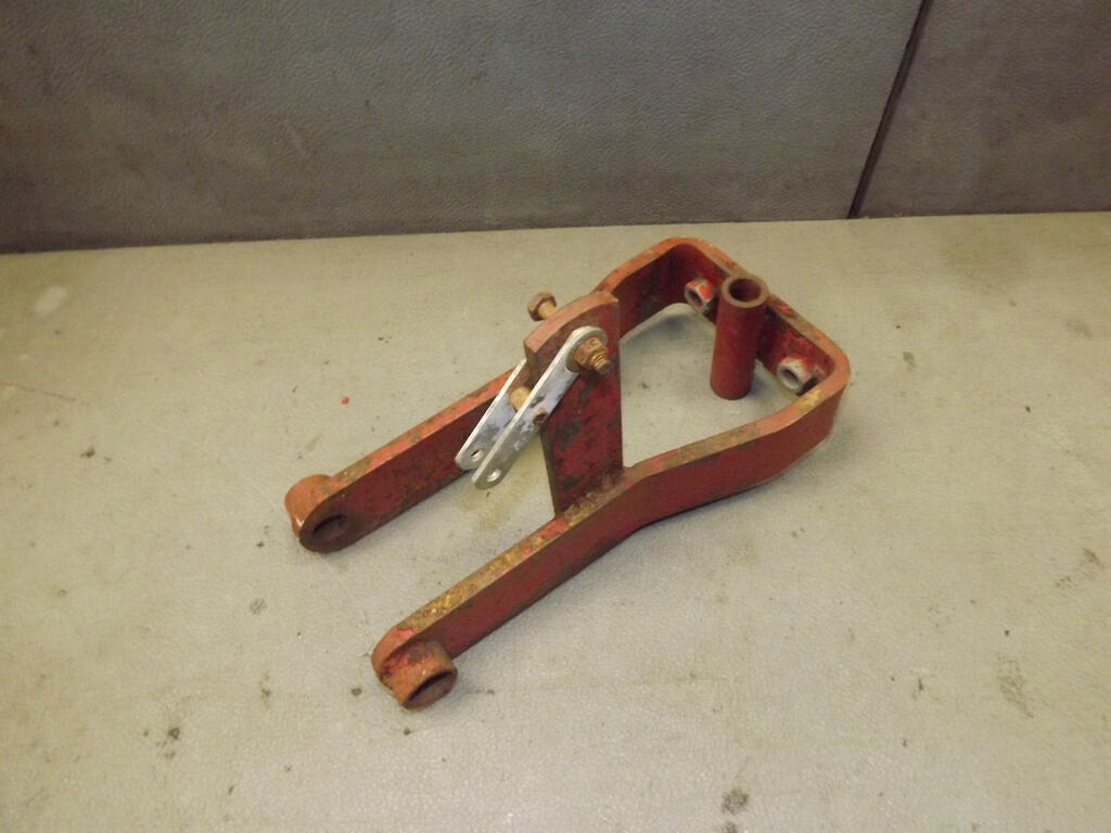

daveoman1966 3,884 #29 Posted December 13, 2022 The double clevis 8292 is shown here...to connect a RANDOM lenght of cable with a LOOP. Also used to hook a random length of cable with a LOOP to the lower ends of the ROCK shaft (Bell Crank) under the tractor. It makes for quick and easy underneath connect/disconnect by simply removing either of the two clevis pins. 1 Share this post Link to post Share on other sites

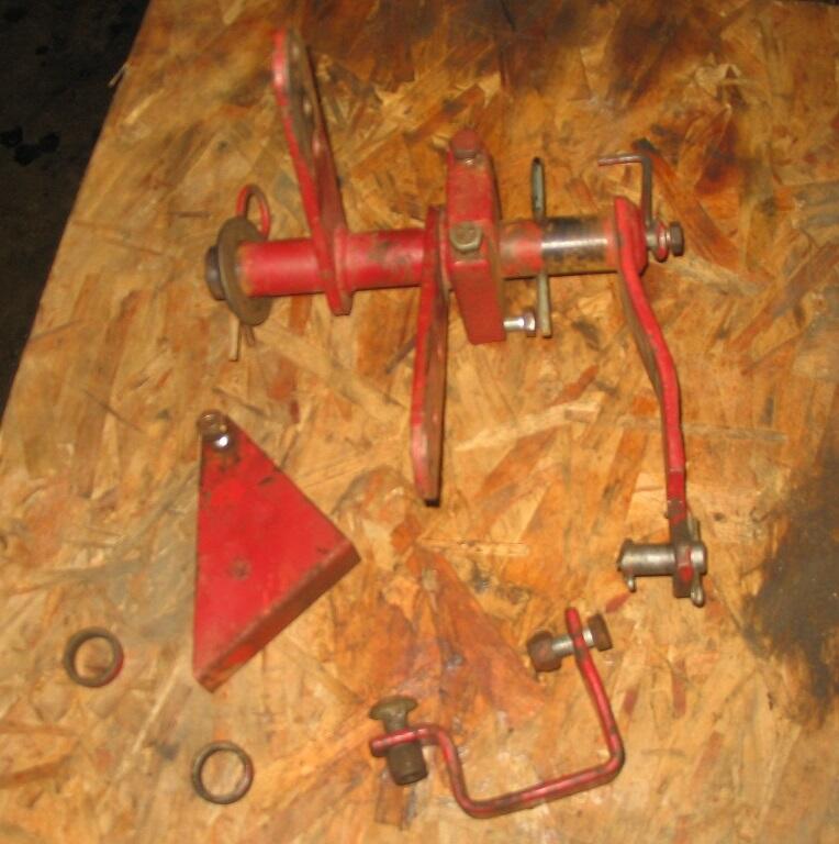

peter lena 10,090 #30 Posted December 13, 2022 @daveoman1966 just how I see it , that lever lift set up is a , lubrication gold mine . typically neglected for life , brought it back and enhanced every opportunity to make it function easier, firm up end play , washers , shucking areas , grease , like power steering easy . just me , pete 1 Share this post Link to post Share on other sites
