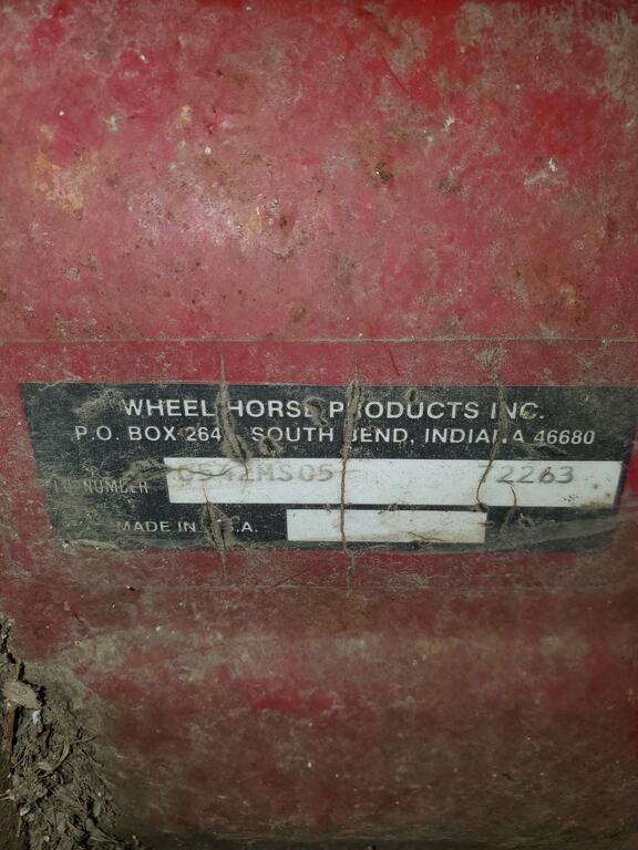

Dick Denny 2 #1 Posted December 11, 2022 I'm really new to the Wheel Horse community. I purchased a deck with a powerflow bagger. One of the spindles needs replaced. I did a quick search on Google and they seem very pricey. Didn't really find much info searching on here. I'm attaching a picture of the tag on my deck... 1 Share this post Link to post Share on other sites

953 nut 69,810 #4 Posted December 12, 2022 This is a very common deck used on 300 series and 400 series Wheel Horses. The part number for the spindle assembly is 110172. You will probably be able to get a good used one from A-Z Tractor Parts. Give Lincoln a call. https://www.a-ztractor.com/. 1 1 Share this post Link to post Share on other sites

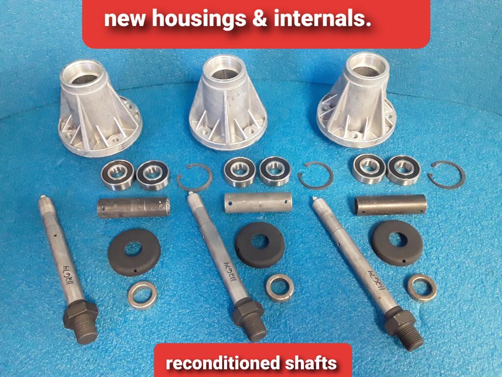

76c12091520h 4,290 #5 Posted December 12, 2022 Used, new, and reconditioned available here: 1 1 Share this post Link to post Share on other sites
