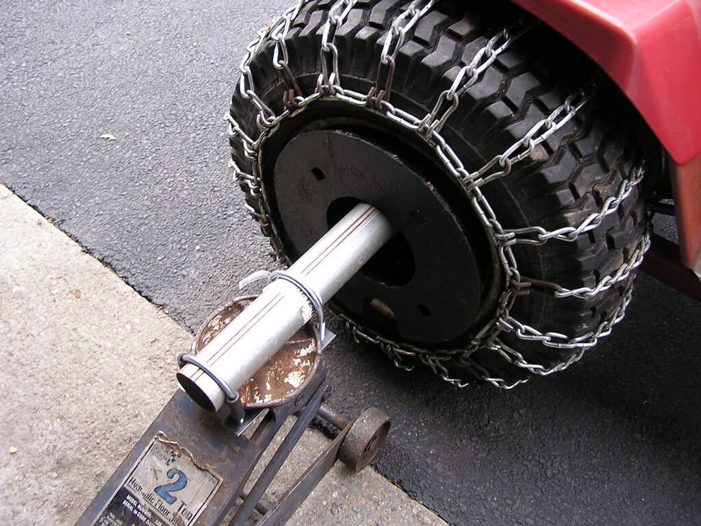

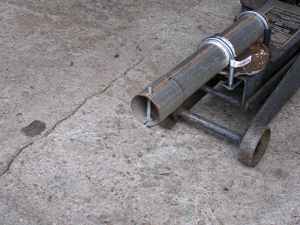

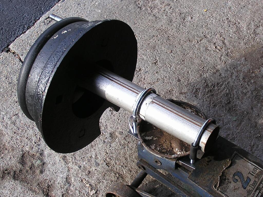

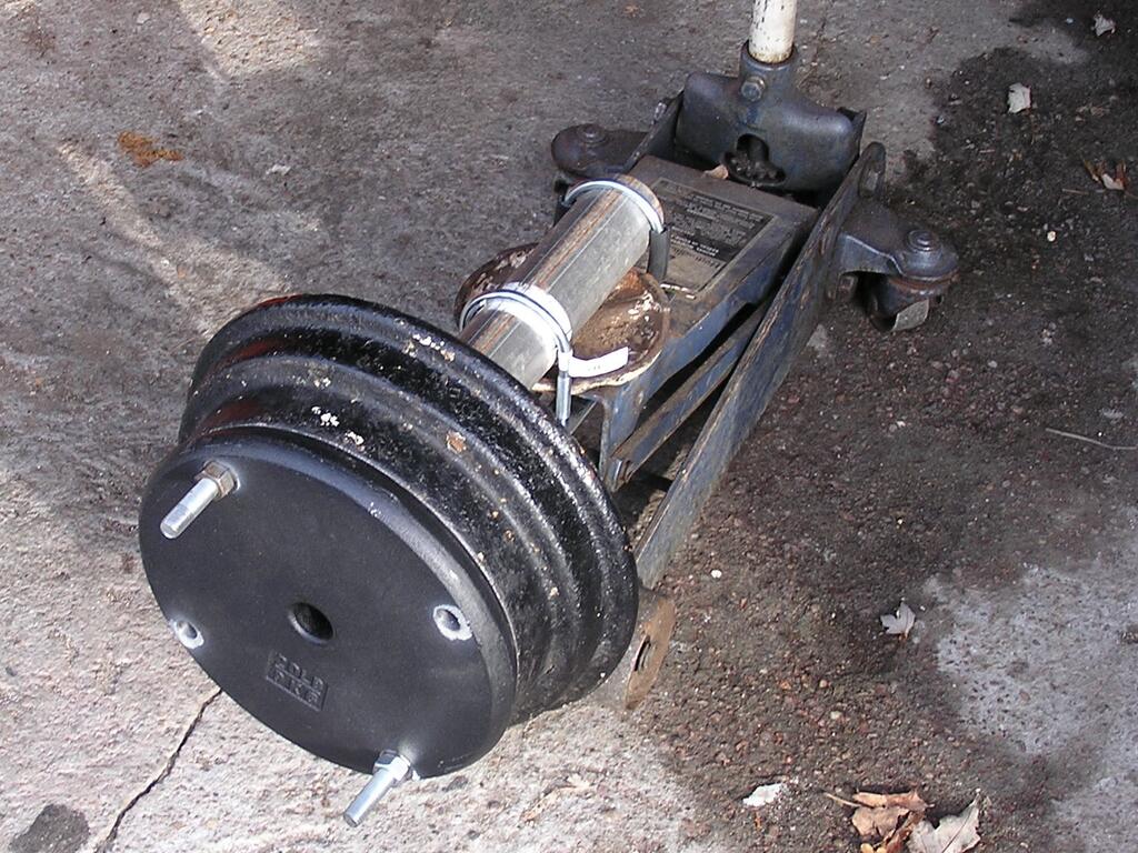

ri702bill 11,525 #1 Posted December 10, 2022 (edited) Per my previous post, the rear weights are assembled, but it was evident a device was needed to hold the weight securely while lineing it up to the wheel. I make a simple bolt on attachment for my trusty 40 year old 2 ton floor jack. Most of it was made from various itens from the "Parts Department". A length of 2-14" OD exhaust pipe, a pair of two 2-1/2" conduit clamps, a pair of 1/8" x 1" flat straps drilled for the clamps, and a short length of 5/16" threaded rod, inserted thru the end of the pipe to act as a stop to keep the weight in place. Worked well. Total cost was under $15 bucks. Edited December 10, 2022 by ri702bill 2 15 Share this post Link to post Share on other sites

ri702bill 11,525 #3 Posted December 10, 2022 No, 30 weight is slick!! Thanks for the comment, This was needed to avoid the juggling act and the pinched fingers. Hope others agree... My biggest fear was that the jack would tip forward with the weight on - another 6" overhang and it would. Bill 2 Share this post Link to post Share on other sites

ri702bill 11,525 #6 Posted December 10, 2022 All - feel free to take this design and alter as needed for your own application - seems that the older floor jacks had the larger saddle plate - my newer 3 ton has a much smaller plate, about the size of a hockey puck... 2 Share this post Link to post Share on other sites

953 nut 64,613 #14 Posted December 10, 2022 5 hours ago, ri702bill said: biggest fear was that the jack would tip forward with the weight on I attempted the same thing but my jack isn't as hefty as yours, though about adding weight to the back of the jack. It was easier to just pull the wheel off and lay it on a couple 4X4s then remount it. 3 Share this post Link to post Share on other sites

WHX?? 55,678 #19 Posted December 11, 2022 (edited) 59 minutes ago, 953 nut said: It was easier to just pull the wheel off and lay it on a couple 4X4s then remount it. I'm not seeing that Richard... most WWs cover the mounting studs? Guessing that would be really hard if tires are loaded? Edited December 11, 2022 by WHX?? Share this post Link to post Share on other sites
