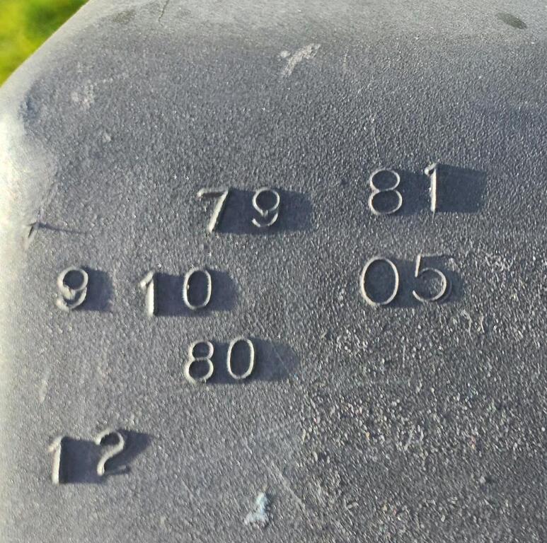

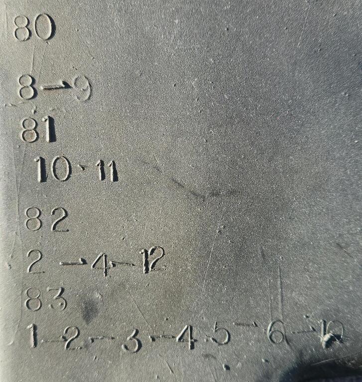

Brockport Bill 2,498 #1 Posted December 10, 2022 Here is a trivia curiosity test question for the WH experts and historians... I had removed a couple gas tanks and was cleaning them and discovered a couple different patterns of numbers?? Any insights out there of what they mean, or represent? Year of manufacture - tractor model year? Some other production info? See the attached photos ----------- Thanks 2 Share this post Link to post Share on other sites
Brockport Bill 2,498 #2 Posted December 10, 2022 as an fyi -- there are 2 different photos that look merged together but they are 2 different tanks -- a top and bottom photo 1 Share this post Link to post Share on other sites

Handy Don 17,634 #5 Posted December 10, 2022 Some are surely mold identifiers. Manufacturers need these to link product with the molds that create them in the event of defects and to time "retirement" of a mold. But that's a lotta numbers! 4 Share this post Link to post Share on other sites

ebinmaine 81,046 #8 Posted December 10, 2022 They remind me of date codes and production run numbers combined. The year and maybe month listed around what number production run the tank was made in. Multiple runs listed could be the previous with the highest number being the current. 1 1 Share this post Link to post Share on other sites
8ntruck 9,368 #9 Posted December 10, 2022 Probably some combination of build date, mold number, and maybe a partial part number. 3 Share this post Link to post Share on other sites
Handy Don 17,634 #10 Posted December 10, 2022 Meant to add that a lot of plastic tanks use a multi-part mold so there would be mold numbers on each part. Also interesting to note that the numbers are raised on the tank so they are indents in the mold--the mold maker/maintainer is whacking those updates into the mold surface with "reverse" number stamps! So the earlier suggestion that they get a new stamp at the start of each month/year of use makes perfect sense to me. 1 1 Share this post Link to post Share on other sites
ri702bill 13,271 #11 Posted December 10, 2022 I like the use of the numeral 1 character turned sideways as a hyphen ..... Share this post Link to post Share on other sites
ri702bill 13,271 #12 Posted December 10, 2022 1 hour ago, Handy Don said: Also interesting to note that the numbers are raised on the tank so they are indents in the mold--the mold maker/maintainer is whacking those updates into the mold surface with "reverse" number stamps! Material removal in a mold is easier, quicker and cheaper than adding (weldind and machining) material back on. The "Budget Trifecta".... Share this post Link to post Share on other sites

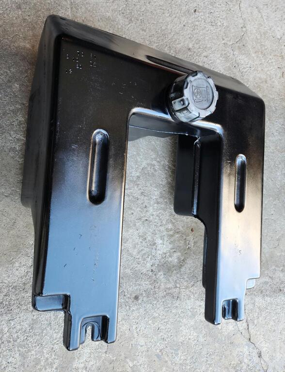

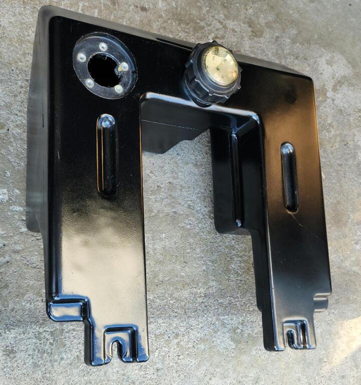

Brockport Bill 2,498 #13 Posted December 10, 2022 4 hours ago, rmaynard said: Can we see pictures of the whole tanks? the insights in posts about the molds is interesting considering the tanks without a guage sender unit have the numeric imprints on the top corner..... and the tank with a guage sender have the numeric imprint on the bottom of tank - thus the production line would have to have different mold design for the imprint to be made???????? Share this post Link to post Share on other sites
ri702bill 13,271 #14 Posted December 10, 2022 A case of "the chicken or the egg". Tanks without sending units came first, followed by those that did. The numbers had to move... 1 Share this post Link to post Share on other sites
