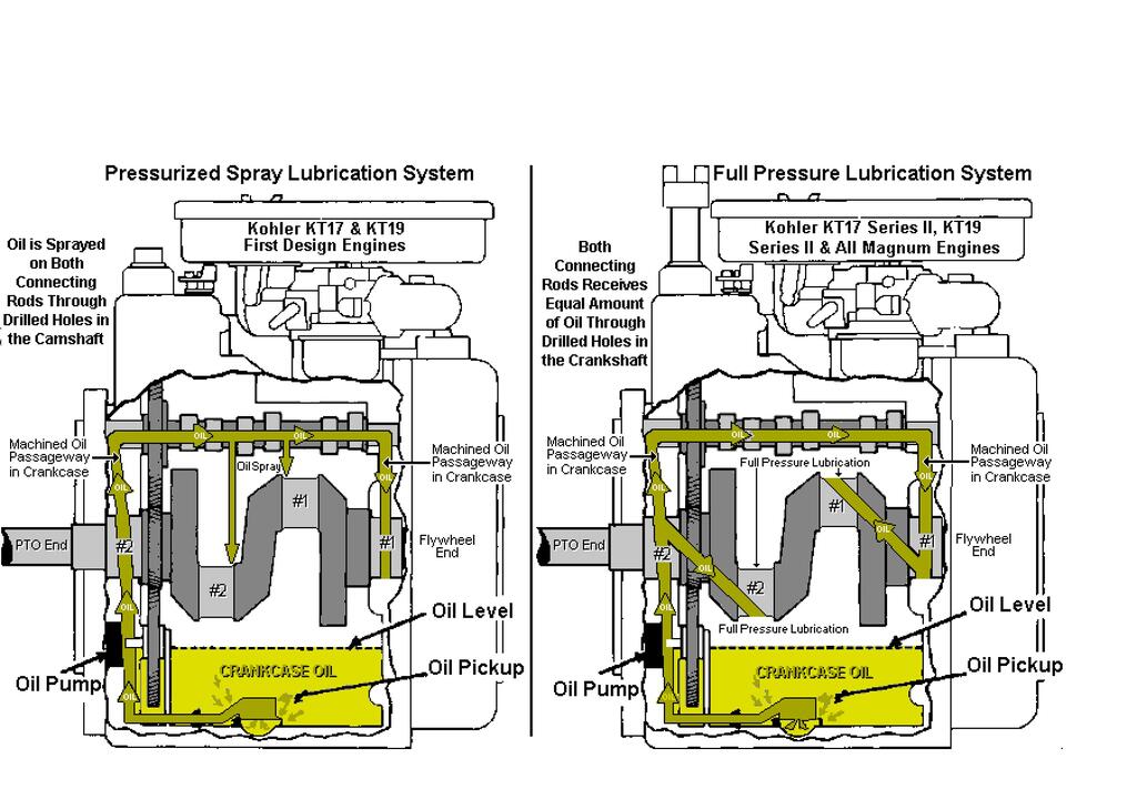

Wild Bill 633 943 #7 Posted December 10, 2022 My understanding is the KT series 1 has a splash oil system and the series 2 has the improved pressurized oil system. https://madison.craigslist.org/grd/d/madison-kohler-kt-19-motor/7565358825.html Share this post Link to post Share on other sites
953 nut 70,325 #8 Posted December 10, 2022 55 minutes ago, Wild Bill 633 said: KT series 1 has a splash oil system Not a splash oil system, more of a drip oil to the connecting rods. It is a low pressure system with no direct pressurized oiling to the crank. Share this post Link to post Share on other sites
