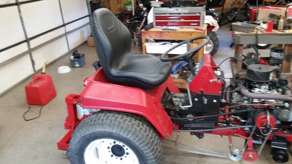

WHX?? 58,324 #2 Posted December 9, 2022 (edited) Guessing the orginal seat? The orginal on my Super C is in good shape but rather uncomfortable. A tractor bro gave me a real nice comfy Milsco aftermarket seat and mounted up ok but a pain to get on and off of. Too high and too close to the wheel. So be wary of replacements. Not many options on relocating on a 195. Orginal I believe. Edited December 9, 2022 by WHX?? 1 Share this post Link to post Share on other sites

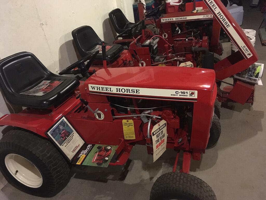

c-series don 12,609 #6 Posted December 10, 2022 Although I’m not a Super-C (C-195) expert, I believe this is the correct original seat. I realize these are not 195’s, this is just an example. Not trying to prove anyone wrong, just lending my two cents for whatever it’s worth!! With inflation it’s probably not worth that 😂 2 Share this post Link to post Share on other sites
