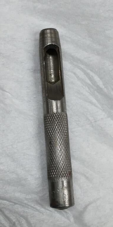

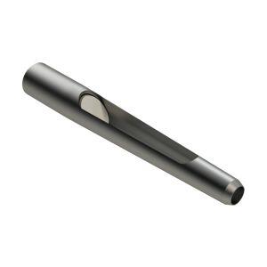

19richie66 17,928 #37 Posted December 8, 2022 (edited) Hollow aerator spikes make good gasket hole punches. I have several different sizes. Edited December 8, 2022 by 19richie66 5 2 Share this post Link to post Share on other sites
ebinmaine 79,550 #38 Posted December 9, 2022 52 minutes ago, 19richie66 said: Hollow aerator spikes make good gasket hole punches. I have several different sizes. Yep. 2 Share this post Link to post Share on other sites
