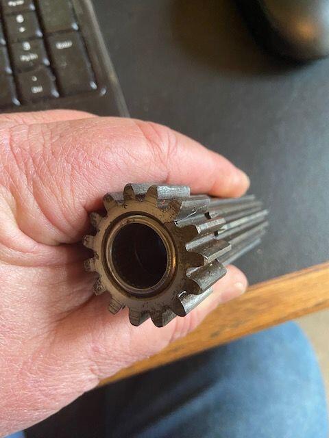

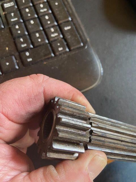

Lagersolut 733 #4 Posted December 4, 2022 (edited) 18 hours ago, Chrishar said: I posted sometime back about this problem I tried a different transmission casting with some of the gears out of the old one but it still making nose I don't know what I'll doing wrong any help would be helpful or a another transmission if anybody has one it for a 702 wheel horse tractor Look at your gears very carefully - " fully cleaned up " - this came out of my 416-8 making a ticking noise - when I got this one apart I was baffled - for the life of me couldn't find anything wrong - one by one I started looking at each gear under a light ( after a few nights of rolling around in bed wondering what I was looking for ) . This hairline crack wasn't from abuse - in my opinion it was a bad casting - nothing in the transmission suggested it was from a hard jolt or hitting something - the crack is all the way through the casting back a tooth - the noise was it spreading and clicking on another gear even a slight load - could not hear it with tractor running - only when pushed in neutral making room in garage . Another member here had a good replacement to get me rolling again Edited December 4, 2022 by Lagersolut 1 3 Share this post Link to post Share on other sites
