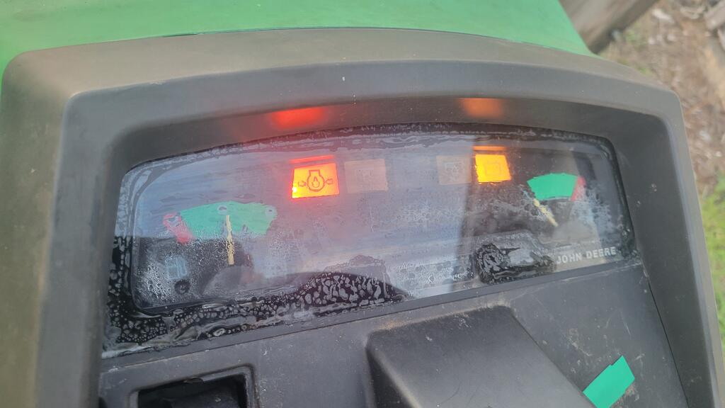

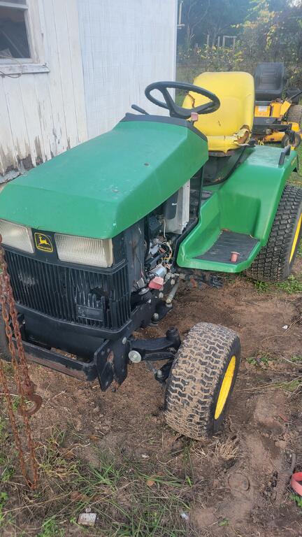

RED-Z06 2,718 #1 Posted December 1, 2022 Guy dropped it off for repair last week, said it was parked in 2020 because the pto stopped working. He sold his house and was going to move it...it started but died and lost power. He replaced the printed circuit board/ignition module and it would crank but no spark. I got it here and plugged in the old board, the LEDS show it all should work. It cranks over but no power to the fuel pump in the tank and no power to the fuel solenoid. I told him, possibly a cut or burnt wire, but I needed to pull it apart and look for chewed wires..he said he was hoping it was a fuse or something simple, really didn't want to put anything into it. Id already cleaned the carb on his push mower...he offered to trade the 425 for that..so, yeah. Its an all wheel steer model...pretty rough, missing the tail lights, both side panels, grille. 54" deck though is nice. Itll be a project...im figuring 8 hours to fix it, i feel like maybe the fuel pump shorted and cooked a wire, but doesnt explain the lack of juice to the fuel solenoid If it runs im estimating about 1200 in parts to get it right. I had one new in 2001...loved it. Ill get pictures tomorrow 2 Share this post Link to post Share on other sites
