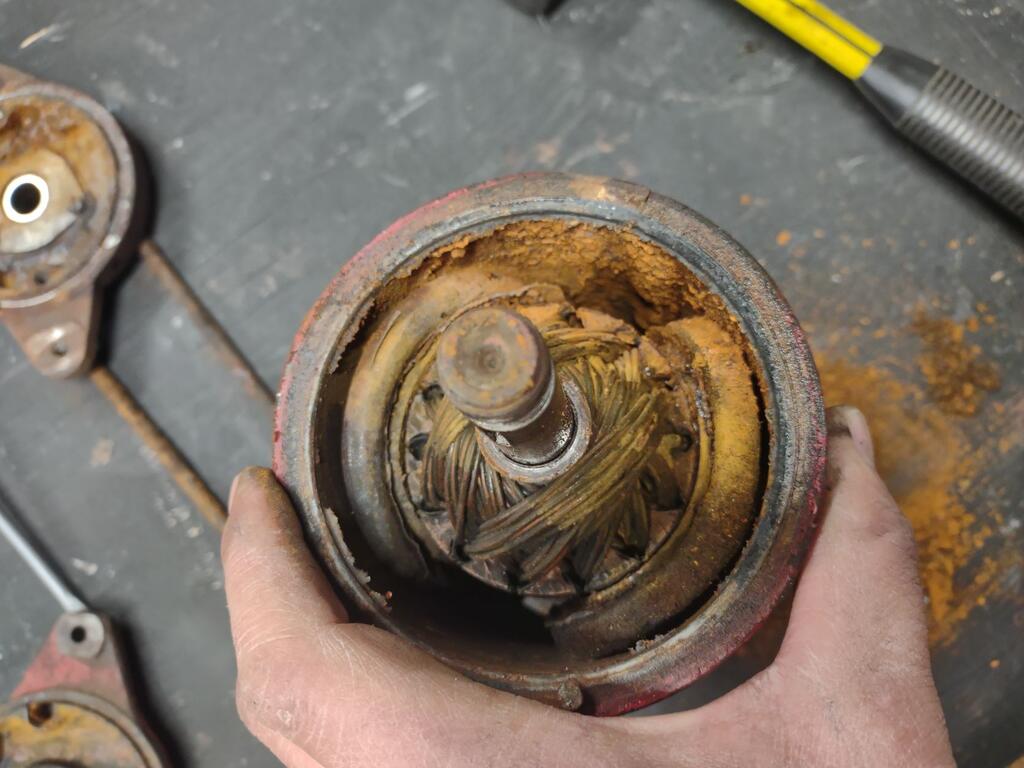

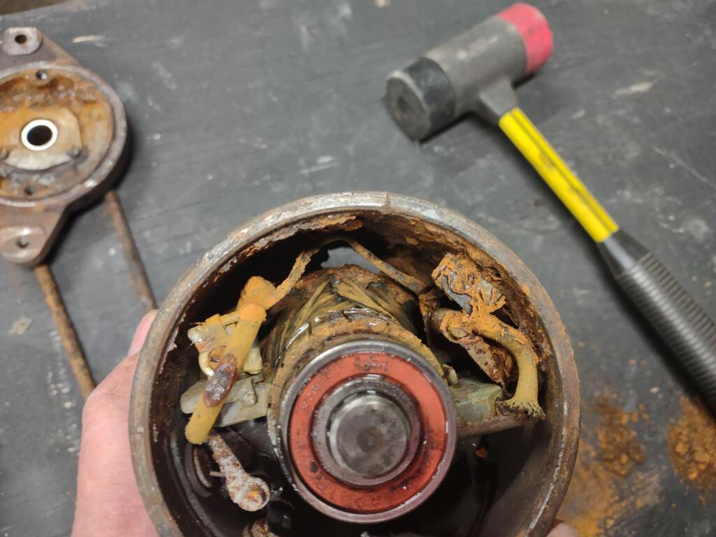

Achto 31,310 #4 Posted November 28, 2022 1 hour ago, 45to70 said: Have not been able to find a part number for a 753 S/G...........mine has sized up. A lot of companies used the AC Delco starter/gen. Basically only 2 differences in them 1 - clock wise or counter clock wise rotation. 2 - The length of the body, short or long. You should require a long/standard length with a CW rotation. Here is a source for a complete S/G or a rebuild kit. https://isavetractors.com/electrical/starter-generator-parts/ One other source for a complete S/G. Part MES9193N http://www.psep.biz/store/kohler_starter_motors.htm I just opened this S/G a bit ago and plan on rebuilding it. Bearings were good, rotor was rusted to the magnets. 1 Share this post Link to post Share on other sites

WHX?? 55,702 #7 Posted November 29, 2022 (edited) 5 hours ago, 45to70 said: OK< Thanks. Think will go with the rebuild kit. Am guessing it is a bearing. Most likely... me thinks Dan has you covered but any issues let us know. I generally enjoy rebuilding them 'cept for cleaning. Usually ther is a distinct bearing whine when time to replace but if it sat and looks like Dan's all bets are off. I have enough pics to do a tutorial on them ... should get off my butt and do it. I saves vid it is OK but doesn't get in depth on things that i feel should be addressed. The bearings are a real common one and I just order them off fleabay. Always some on the shelf. I have found the brushes seldom need replacing but it doesn't hurt. Since I am a horseaholic and most of my tractors are early 60s always have a rebuilt on the shelf too. Edited November 29, 2022 by WHX?? 3 Share this post Link to post Share on other sites

gwest_ca-(File Mod) 12,066 #9 Posted November 29, 2022 One thing that is often overlooked. The ends of the armature housing should be wire brushed to bare metal along with the matching surfaces on both end plates. A thin coat of dielectric grease on the cleaned surfaces will keep rust at bay till the next time it comes apart. These surfaces provide the ground circuit required. Starter motors should be done the same way. 1 3 1 Share this post Link to post Share on other sites
