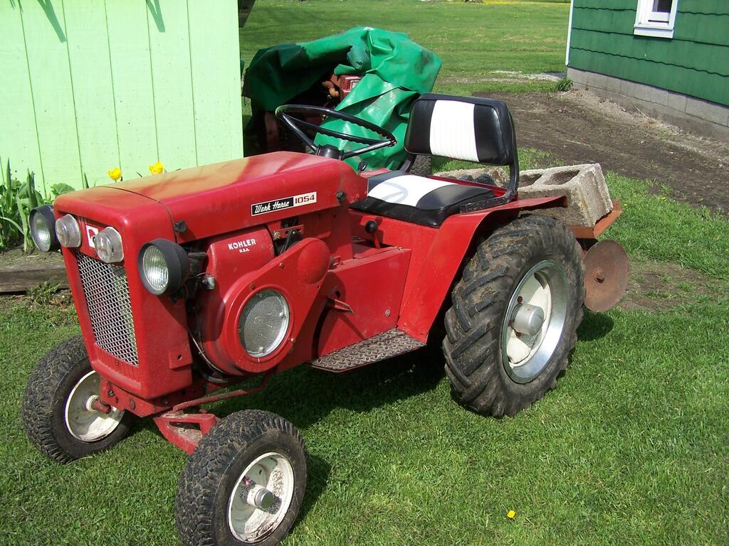

Lane Ranger 12,159 #16 Posted November 28, 2022 (edited) This 1054 hood and front cowling was done with a brush! The key to doing a smooth job is to mix up your canned paint with some Flood Penetrol ( get in hardware, Lowes or Home Depot) that helps smooth your paint on metal surfaces. I used a quart can of regal red Rustoleum. Other parts were spray painted with Rustoleum regal red. Flood Penetrol https://www.homedepot.com/p/reviews/Flood-Penetrol-1-Qt-Clear-Paint-Additive-FLD4-04/100130893/2?mtc=SEM-CM-CML-GGL-D59S-059_037_SFT_WN_CVR-NA-NA-NA-DSA-2998253-NA-NA-NA-NBR-NA-NA-NEW-NA&cm_mmc=SEM-CM-CML-GGL-D59S-059_037_SFT_WN_CVR-NA-NA-NA-DSA-2998253-NA-NA-NA-NBR-NA-NA-NEW-NA-71700000099318007-58700007989738948-39700072693012461&gbraid=0AAAAADq61UfbGGc0FCqgou7H4uJqQ1VQ0&gbraid=0AAAAADq61UfbGGc0FCqgou7H4uJqQ1VQ0&gclid=Cj0KCQiA1ZGcBhCoARIsAGQ0kkqYbfYRE-AzPOudJXwcT7cZkGt50kHr9l7oDUG5f1MSCSiwbcrZPBsaAtW1EALw_wcB&gclsrc=aw.ds Edited November 28, 2022 by Lane Ranger 10 Share this post Link to post Share on other sites

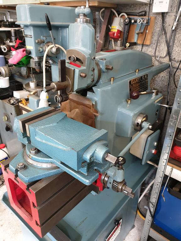

Mickwhitt 5,259 #22 Posted November 29, 2022 I brush painted the chassis and transmission of my C-125 and its all fine. Yes cast iron is rough but can still be made to look better. I have renovated many machine tools such as lathes and milling machines over the years. All of them had some degree of filling done to the castings to even out the surface. One c British company, Raglan, used to coat the raw castings in a kind of slow curing filler and leave them in a warm kiln overnight. This allowed the filler to "run" and self level before it set. The casting was then sanded prior to painting. This was more akin to car bodywork than engineering. When I stripped a couple of Raglans down I was amazed at how much filler had been used and how poor the castings were before the beauty treatment. This is an Elliot 10m shaper which looks sprayed but was brush painted and sanded between coats. It's got a better finish than my car (automobile) 3 2 1 Share this post Link to post Share on other sites
