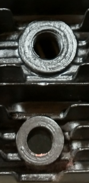

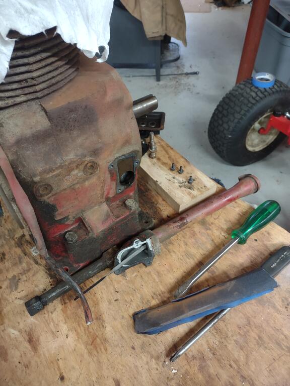

ebinmaine 81,038 #201 Posted December 31, 2022 4 minutes ago, Lee1977 said: I don't think there would be much difference, but the white paint might not dissipate heat as quick. This is correct. There is little difference between most colors but black is the color that BOTH absorbs AND dissipates the most heat. 37 minutes ago, Horse Newbie said: I thought black absorbed heat and white repelled heat… Interesting research... Kirchhoff's law: "For an arbitrary body emitting and absorbing thermal radiation in thermodynamic equilibrium, the emissivity is equal to the absorptivity." White will repel heat the most and it will hold it the most when the source of heat is gone. 1 2 Share this post Link to post Share on other sites
wallfish 20,719 #202 Posted December 31, 2022 It ain't gonna make 1 iota of difference whatever color is on that head. Paint away in my opinion as will not cause any problems with cooling on a small engine. The convection heat will still easily dissipate. What could the "r-value" of paint be? 1 millionth of 1 degree? Here's an interesting article from the aircraft industry which would definitely be interested in ANY tiny degree of cooling or heating properties of anything on their engines. https://www.avweb.com/ownership/improving-engine-cooling-by-painting/ 3 1 Share this post Link to post Share on other sites
SylvanLakeWH 32,764 #203 Posted December 31, 2022 No expert, but I think @wallfish is correct. I wouldn't expect any difference in heating / cooling given the minimal surface area we're talking about... regardless, I would think less coats of any color would equal cooler... even if minimal... 3 Share this post Link to post Share on other sites
ebinmaine 81,038 #204 Posted December 31, 2022 @wallfish Very interesting read. Thanks for posting. I agree that the color would make little to no difference in heat to my case. Dark color was chosen just because it would cover the staining of another dark color. It would be a very interesting experiment to use an infrared thermometer on a well thought out trial to see the actual temps. 54 minutes ago, SylvanLakeWH said: I would think less coats of any color would equal cooler... even if minimal... Agreed here as well. I'm not sure if the pic shows it well ... The black isn't even covering all the maroon. Look deep in the fins. But at least it's dark to dark so it blends in for the most part. If/when I get a sand/bead blaster it could be cleaned up. 2 Share this post Link to post Share on other sites
Sparky-(Admin) 26,619 #205 Posted December 31, 2022 1 hour ago, ebinmaine said: Look deep in the fins. Trying to hypnotize us are ya!! It’s not gonna work But it’s nice to watch this project motoring along and a nice pace. 10 Share this post Link to post Share on other sites
ebinmaine 81,038 #206 Posted December 31, 2022 59 minutes ago, Sparky said: Trying to hypnotize us are ya!! 1 Share this post Link to post Share on other sites
kpinnc 19,033 #207 Posted December 31, 2022 (edited) Regardless of which color dissipates better, black high temp paint seems to hold up better than anything else. Every silver or light color I've used tends to discolor over time. One more thing: every manufacturer on earth sprayed these complete engines with thier paint. Either because they didn't care or because paint made a negligable difference in performance- and these engines keep going 50+ years later. I don't see it as an issue. Just my opinion. Edited December 31, 2022 by kpinnc 3 Share this post Link to post Share on other sites
ebinmaine 81,038 #208 Posted December 31, 2022 Agreed on all counts. Share this post Link to post Share on other sites

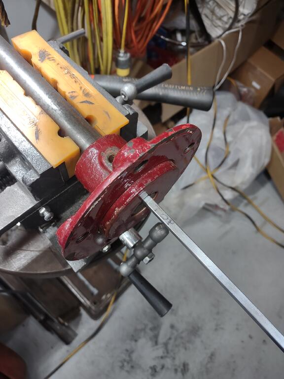

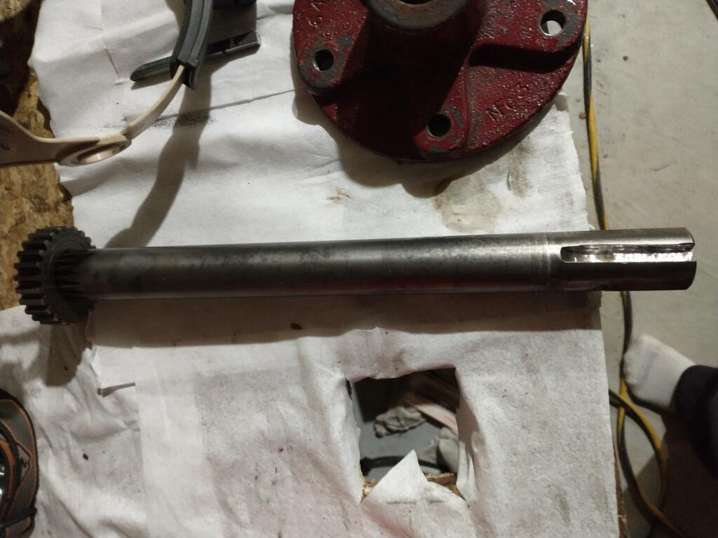

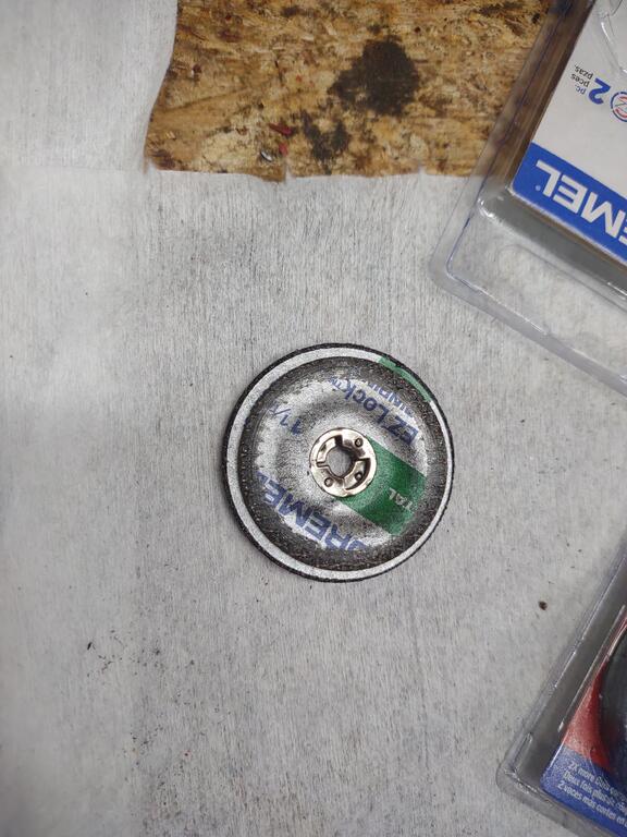

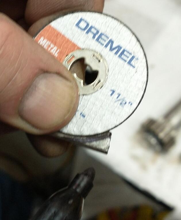

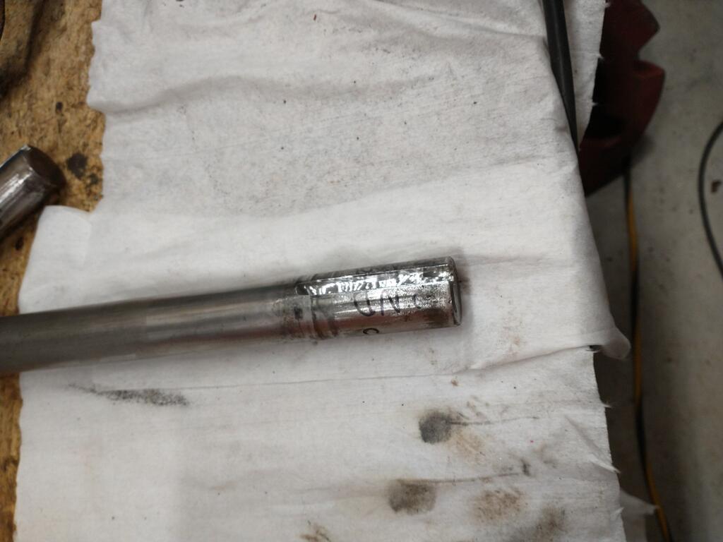

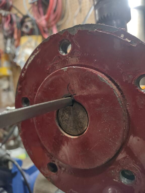

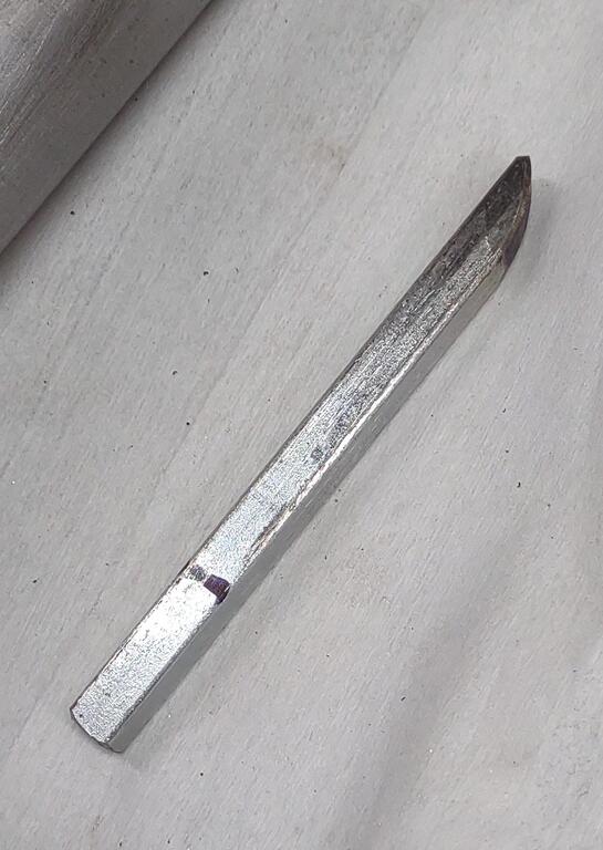

ebinmaine 81,038 #209 Posted December 31, 2022 I was able to get one of the axle keyway grooves cut. Could be a hair tighter up n down but it'll do just fine. The black marker line is the final length. I'll cut it off later. I'm leaving it long because it's easier to handle. To get the curve line right I lined up a cutting wheel and traced a marker line into the key stock. Then ground the key. Here's the old grinding wheel on top of a new one after doing some experimental cutting and making 3 full grooves. While I did that BBT took a couple things off the K341. Earlier today The Paint Department was at it again. The rear fender seat pan is now red. 5 Share this post Link to post Share on other sites
8ntruck 9,358 #210 Posted January 1, 2023 Got any shim stock that you could use to fill up the extra up and down space? Would be some extra bullet proofing.... 1 Share this post Link to post Share on other sites
ebinmaine 81,038 #211 Posted January 1, 2023 57 minutes ago, 8ntruck said: Got any shim stock that you could use to fill up the extra up and down space? Would be some extra bullet proofing.... Not handy but I could get some. Share this post Link to post Share on other sites

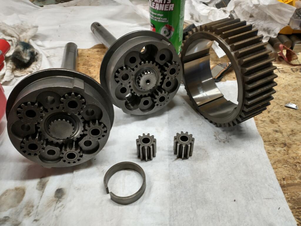

ebinmaine 81,038 #212 Posted January 6, 2023 (edited) The BBT and I been ridiculously busy the last few days but we've done a little here n there. Trina finished cleaning up the engine oil pan this evening. She also started cleaning up the outside of the transmission fluid pump. I finished up the 2nd axle keyway groove and cleaned the differential for assembly. This pic shows all the components of a 5071 10 pinion Limited Slip Differential with steel endplates. We should be about ready to assemble the transuhmasshion and make us a rolling chassis. Edited January 6, 2023 by ebinmaine 4 3 Share this post Link to post Share on other sites
Handy Don 17,628 #213 Posted January 6, 2023 (edited) 16 minutes ago, ebinmaine said: This pic shows all the components of a 10 pinion Limited Slip Differential. That's a terrific picture of the differential. Please add to your post ( for folks using the search box) that its a 5071 LSD with steel endplates (5060 if aluminum) Definitely some wear on those pinions but nothing serious. FYI @JimSraj Edited January 6, 2023 by Handy Don 1 Share this post Link to post Share on other sites
ebinmaine 81,038 #214 Posted January 6, 2023 8 hours ago, Handy Don said: That's a terrific picture of the differential. Please add to your post ( for folks using the search box) that its a 5071 LSD with steel endplates (5060 if aluminum) Definitely some wear on those pinions but nothing serious. FYI @JimSraj Added that. That wear line is the coloration where the spring was riding. The wear itself is negligible. I believe this was the diff from the 70 Charger but can't be sure. 1 Share this post Link to post Share on other sites

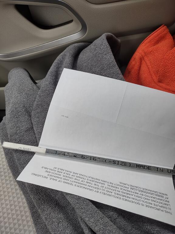

953 nut 70,023 #215 Posted January 6, 2023 On 12/31/2022 at 6:43 PM, ebinmaine said: was able to get one of the axle keyway grooves cut. Could be a hair tighter up n down but it'll do just fine. If you happen to go past a GRAINGER store on your travels you could puck up some 1/4" X 5/16" key-stock and adjust the fit as needed. 1 Share this post Link to post Share on other sites
ebinmaine 81,038 #216 Posted January 6, 2023 5 minutes ago, 953 nut said: If you happen to go past a GRAINGER store on your travels you could puck up some 1/4" X 5/16" key-stock and adjust the fit as needed. Well considering I work almost across the street from one I'll bet I could find some of that size key stock fairly well. 👍 1 Share this post Link to post Share on other sites

8ntruck 9,358 #219 Posted January 6, 2023 4 hours ago, 953 nut said: If you happen to go past a GRAINGER store on your travels you could puck up some 1/4" X 5/16" key-stock and adjust the fit as needed. better than adding shims. 1 Share this post Link to post Share on other sites

ebinmaine 81,038 #225 Posted January 12, 2023 I did some experimentation with a different way of cutting the axle shaft keyways. No pics yet as I've yet to perfect the method. A note to folks on the O rings at the plugs on the hydro pump. They're a normal 13/16 outside diameter and... NOT a standard hardware store O ring from the plumbing section. Sundstrand appears to use a Hydraulics Industry Standard MORB Male O Ring Boss. The size is between the plumbing Standards of 1/16 and 3/32. Share this post Link to post Share on other sites
