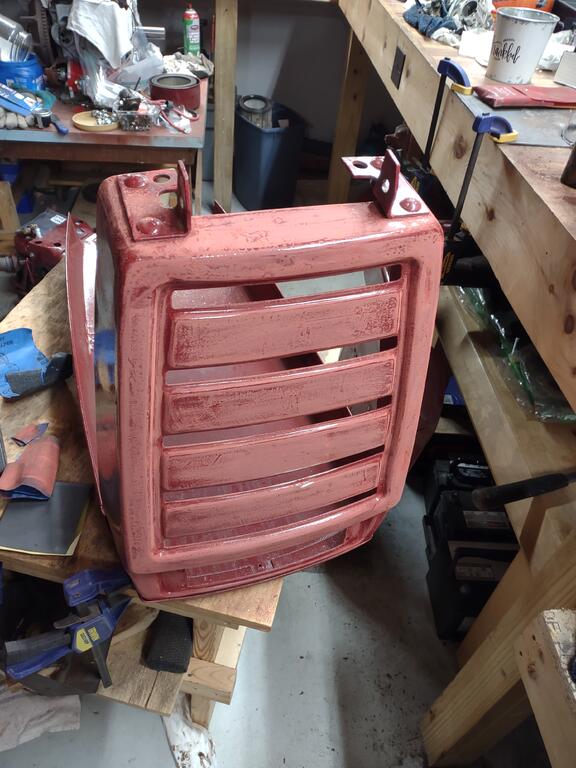

SylvanLakeWH 32,309 #101 Posted December 12, 2022 Lookin' good!!! 1 1 Share this post Link to post Share on other sites
kpinnc 18,916 #102 Posted December 12, 2022 3 hours ago, ebinmaine said: Here she's most done. Spacing is even. I do believe she does fine work! Very impressive! 2 1 Share this post Link to post Share on other sites
ebinmaine 80,469 #103 Posted December 12, 2022 5 hours ago, kpinnc said: I do believe she does fine work! Very impressive! Much appreciated Sir. 1 Share this post Link to post Share on other sites
Handy Don 17,387 #104 Posted December 12, 2022 Dang, Trina, that stuff takes a lot of patience. Looks terrific 1 1 Share this post Link to post Share on other sites
kpinnc 18,916 #105 Posted December 12, 2022 7 hours ago, Handy Don said: Dang, Trina, that stuff takes a lot of patience. Somehow, I'm thinking she has plenty of practice with patience... JUST JOKING! 1 3 Share this post Link to post Share on other sites
ebinmaine 80,469 #106 Posted December 12, 2022 35 minutes ago, kpinnc said: Somehow, I'm thinking she has plenty of practice with patience... JUST JOKING! You Sir, are quite correct... 🥋 1 Share this post Link to post Share on other sites
kpinnc 18,916 #107 Posted December 12, 2022 3 minutes ago, ebinmaine said: You Sir, are quite correct... My wife's level of patience is the only reason all the frying pans are dent-free at my house. ... I figured you'd know what I meant. 1 2 Share this post Link to post Share on other sites
ebinmaine 80,469 #108 Posted December 12, 2022 6 minutes ago, kpinnc said: My wife's level of patience is the only reason all the frying pans are dent-free at my house. ... I figured you'd know what I meant. Oh I do. 🤪 1 Share this post Link to post Share on other sites

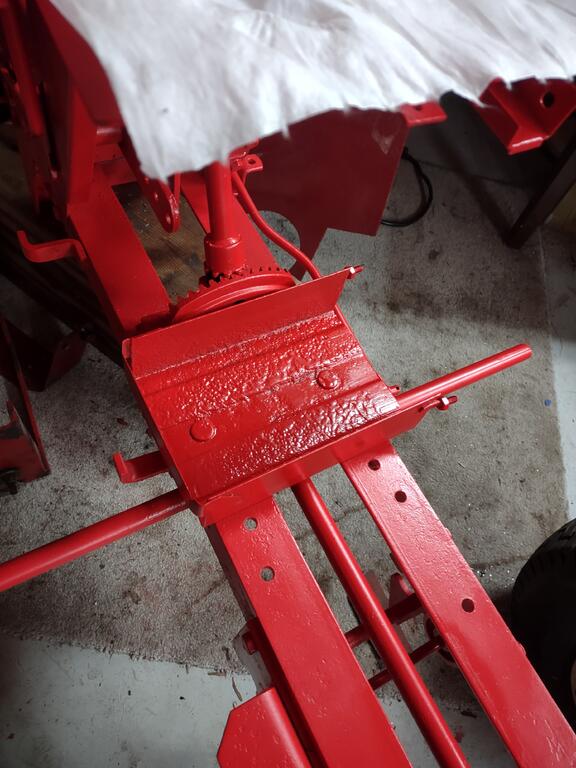

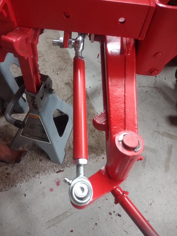

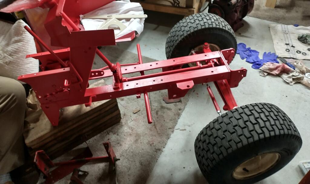

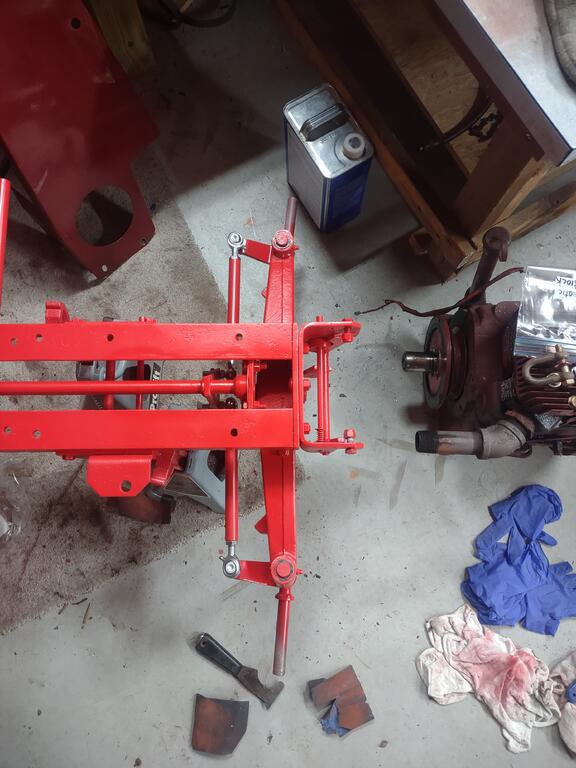

ebinmaine 80,469 #109 Posted December 13, 2022 More cleaning. More painting. Repeat. Repeat. Trina got another coat of paint on some things she'd done yesterday. Also put paint on the hydraulic cylinder and seat square tubing this evening. The piece with the blue end is the rebuilt starter. We got the front tires and steering back in. Heim joints. The only way to go. These are 7/16 double male greaseable all RH thread. 3 4 Share this post Link to post Share on other sites
RandyLittrell 3,945 #110 Posted December 13, 2022 10 hours ago, ebinmaine said: These are 7/16 double male greaseable all RH thread. Are you threading some DOM tubing for those? Randy 1 Share this post Link to post Share on other sites
ebinmaine 80,469 #111 Posted December 13, 2022 8 minutes ago, RandyLittrell said: Are you threading some DOM tubing for those? Randy I've had the Red rod portion for a year or three.... I think it was 3/4 rod bought from a big box store that I cut to length and had someone bore and thread for me. 1 Share this post Link to post Share on other sites
RandyLittrell 3,945 #112 Posted December 13, 2022 2 minutes ago, ebinmaine said: I've had the Red rod portion for a year or three.... I think it was 3/4 rod bought from a big box store that I cut to length and had someone bore and thread for me. They look good Eric!! I use all thread with pipe slipped over it and plug welded to hold it, then use female Heims. I believe with the right DOM tubing, you can just run a tap in the ends as well. Randy 1 1 Share this post Link to post Share on other sites
Lee1977 7,756 #113 Posted December 13, 2022 I just used 1/2" cold rolled on my 312 and haven't had and trouble with it. I have 5/8" or 3/4" turned down to 1/2" on the ends on the others.. I had some 5/8" turned down on the end for it but it was so hard I couldn't run the die on it. 1 1 Share this post Link to post Share on other sites
ebinmaine 80,469 #114 Posted December 13, 2022 8 minutes ago, Lee1977 said: I just used 1/2" cold rolled on my 312 and haven't had and trouble with it. I have 5/8" or 3/4" turned down to 1/2" on the ends on the others.. I had some 5/8" turned down on the end for it but it was so hard I couldn't run the die on it. Now that you bring that up I half remember buying mild steel rod on purpose and getting it large enough that I can have it tapped internally. That may have been why I went with 3/4 diameter. Share this post Link to post Share on other sites

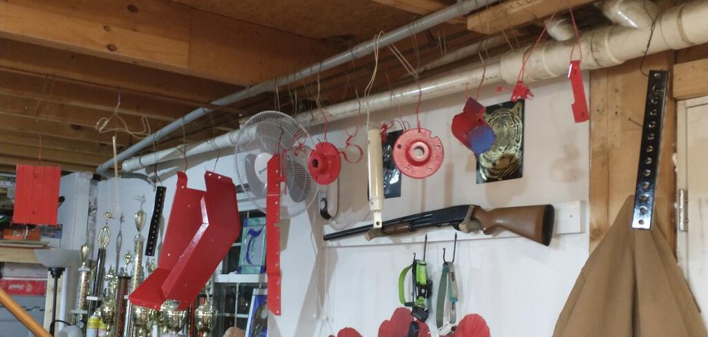

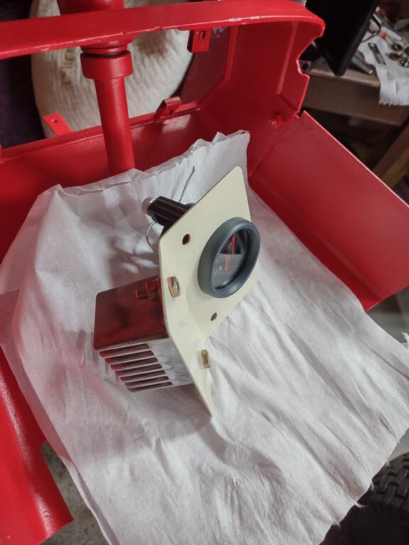

ebinmaine 80,469 #115 Posted December 14, 2022 Very little time for either of us today so we enforced the One Bolt Rule. Trina got another coat of paint on the lift cylinder and bolted down the battery tray. I installed the volt guage and voltage regulator in its bracket. She sanded more at the front of the hood while I sanded off the old Delco ignition coil. 6 Share this post Link to post Share on other sites

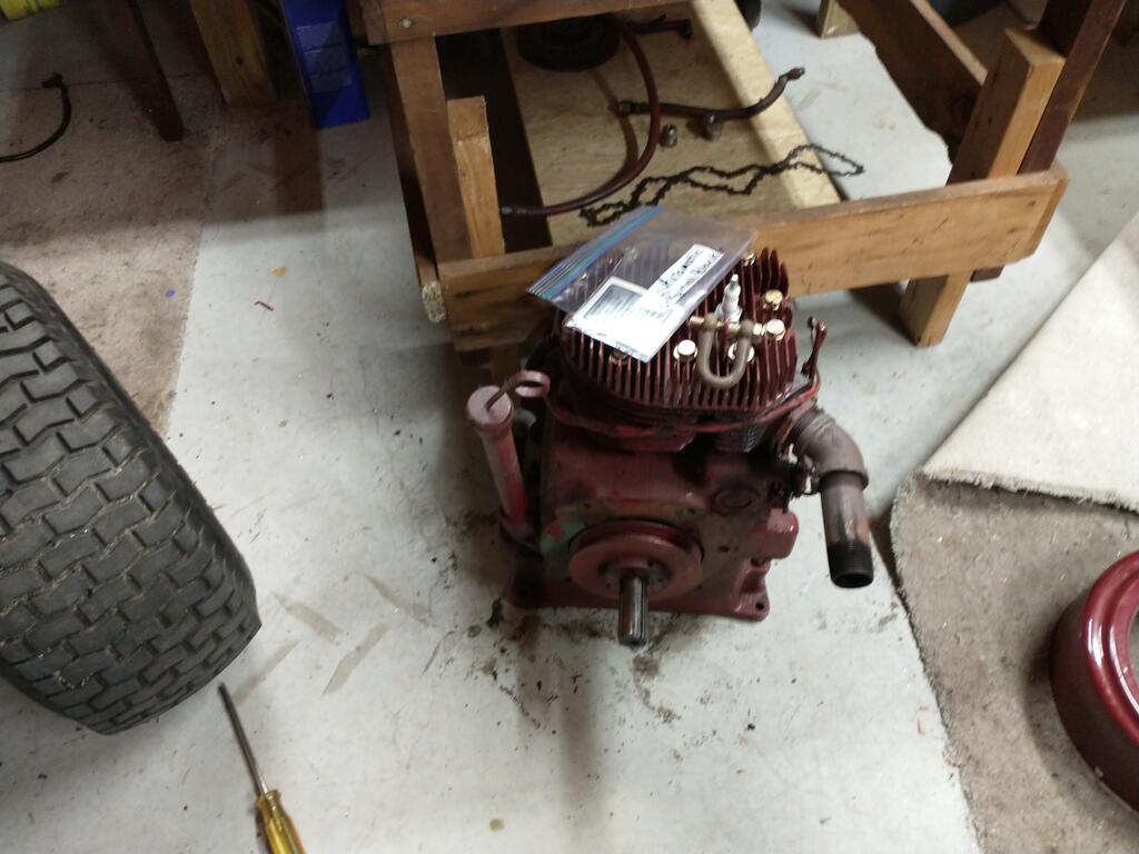

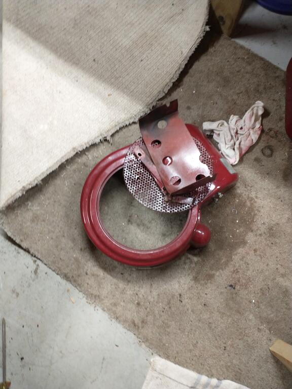

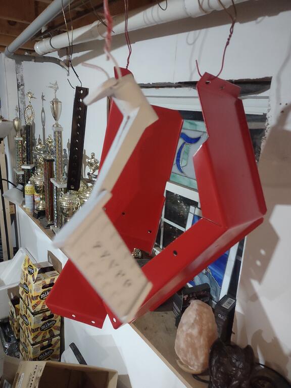

ebinmaine 80,469 #117 Posted December 16, 2022 Last night I was able to get the engine PTO off and set aside bagged up. Got the set screws out of the drive pulley. Removed all the engine sheet metal. That'll be used on the engine we put in. Doing it that way so we're ahead of time. Trina spent more time sanding and prepping along with a little more hammer and dolly work. More of the same for her this evening. I went digging around in the parts pile for axles. I have good keys but bad bearing area and vice versa. I'll take a couple axles with good bearing areas and grind new keyways somehow. Likely make a nice row of drilled holes. Expand them. File in the holes. Might also consider using an end mill bit to flatten the bottom of the holes. 1 1 Share this post Link to post Share on other sites

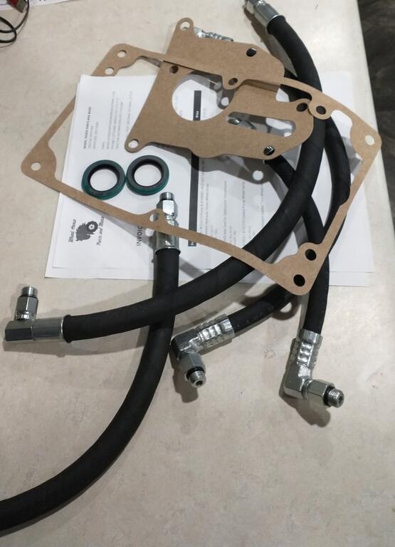

ebinmaine 80,469 #118 Posted December 16, 2022 Got a package from @wheelhorseman Lowell !! 6 5 1 Share this post Link to post Share on other sites

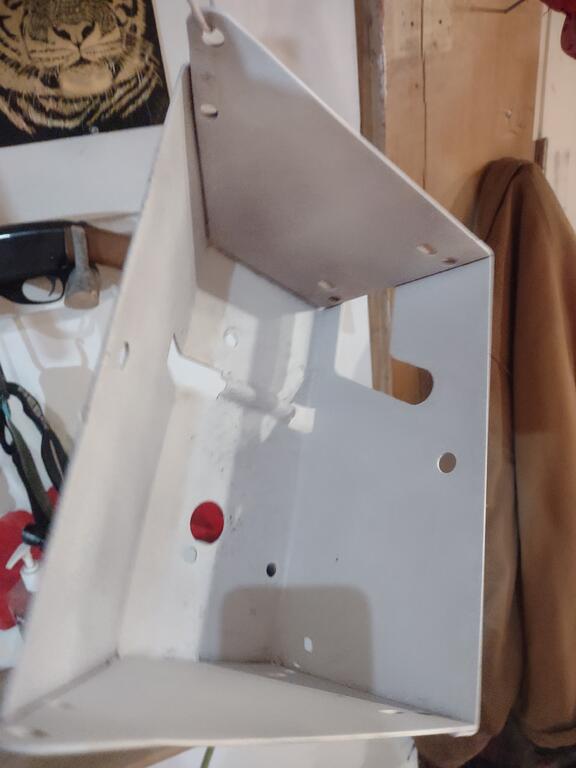

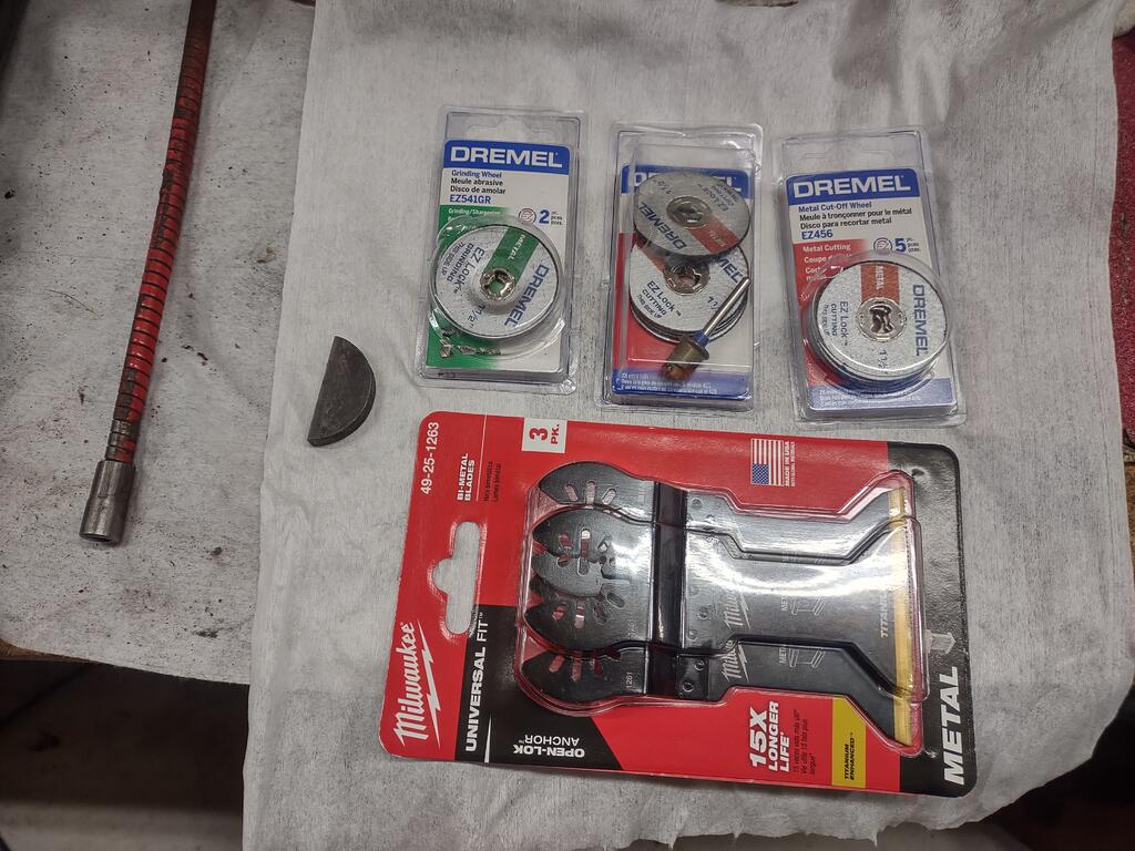

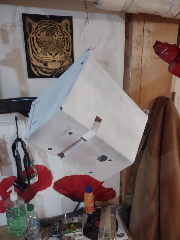

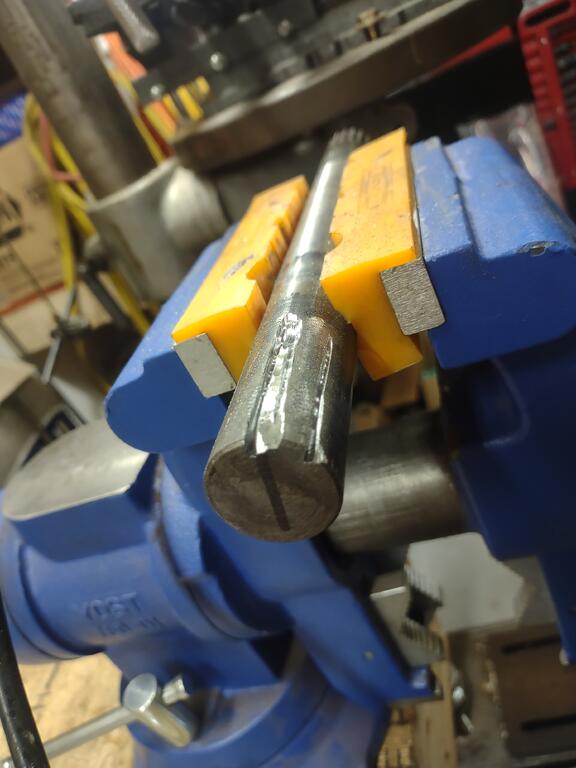

ebinmaine 80,469 #119 Posted December 21, 2022 This past 3 days we've been busy with snow removal from a pretty fair sized VERY heavy wet snow storm. Today we got back at the Automatic tractor. Trina sanded and primed 2 more pieces. The brake/neutral pedal and the tool box seat pan holdererer. I've been thinkerizing on how to cut grind slash a keyway groove in an axle. After a fair bit of brainstorming and experimentation I've decided that the Dremel tool with a cutting disc is the way to go for me. I highlighted that to bring attention to the fact that other folks could should and would do this other ways. I tried using a 4" grinder but lacked control. I tried using a vibratory cutter and it's a little rough. The Dremel tool will take a fair amount of patience and time... But... I can get the job done... Myself. No need for a $100 machine shop bill and waiting 2 MONTHS to get the parts back. 1 Share this post Link to post Share on other sites
WHX?? 57,934 #120 Posted December 21, 2022 I dunno EB all I can say is yikes... 2 1 Share this post Link to post Share on other sites
ebinmaine 80,469 #121 Posted December 21, 2022 1 minute ago, WHX?? said: I dunno EB all I can say is yikes... Axle's already junk so no worries. Still a lot of work to do obviously. I'll cut some grooves here then IIFF I feel good about it I'll go to the better longer axles. Either it will work or it won't right? 1 Share this post Link to post Share on other sites
Handy Don 17,387 #122 Posted December 21, 2022 1 hour ago, ebinmaine said: Axle's already junk so no worries. Still a lot of work to do obviously. I'll cut some grooves here then IIFF I feel good about it I'll go to the better longer axles. Either it will work or it won't right? I'm wondering if it might be steadier to lock the Dremel down and slide the axle back and forth under it while raising the axle a bit after each pass? Clamping something to the axle would let you steady it and keep it properly oriented, too. 1 1 Share this post Link to post Share on other sites
ebinmaine 80,469 #123 Posted December 21, 2022 5 hours ago, Handy Don said: I'm wondering if it might be steadier to lock the Dremel down and slide the axle back and forth under it while raising the axle a bit after each pass? Clamping something to the axle would let you steady it and keep it properly oriented, too. I can see the logic in that. Not sure if I'd be more steady one way or the other. I'll try it out. 7 hours ago, WHX?? said: I dunno EB all I can say is yikes... Just an FYI. Looking at the pic above BOTH of the grooves you see were already partially in place before I tried anything with the Dremel. That's why they look so messy. The Dremel tool makes a nice clean sharp edged cut. I'm quite confident that once I get a straight mark, a good hold on either the cutter or work piece, and a good comfortable sitting position, I'll be able to get a decent groove. I also bought grinding wheels to try, along with the cutting wheels. 1 Share this post Link to post Share on other sites
WHX?? 57,934 #124 Posted December 21, 2022 Tell ya one thing EB won't be for lack of trying 2 1 Share this post Link to post Share on other sites
ebinmaine 80,469 #125 Posted December 21, 2022 3 minutes ago, WHX?? said: Tell ya one thing EB won't be for lack of trying That's kind of what I was thinking too. Where I've already got an axle that isn't any good I can just give it a shot with very low risk. I believe I can make it work given the right angles and extreme patience. 2 Share this post Link to post Share on other sites
