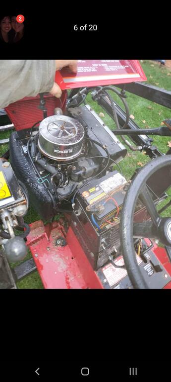

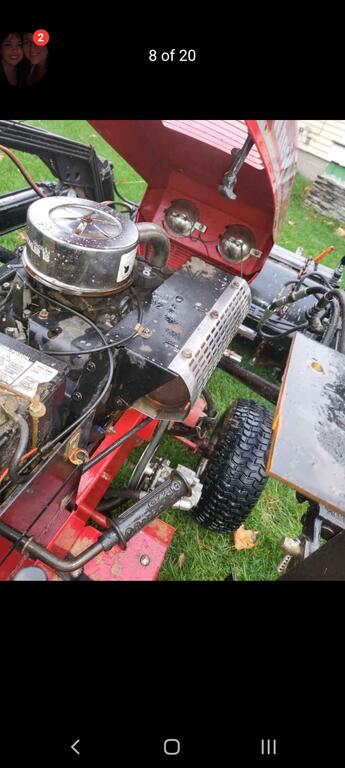

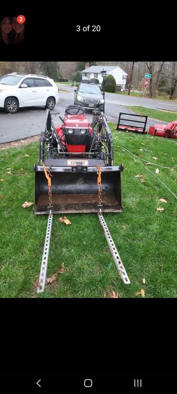

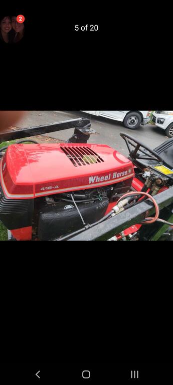

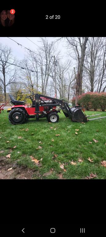

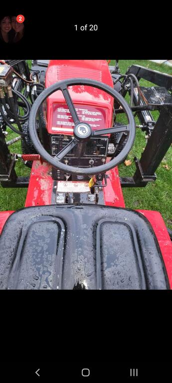

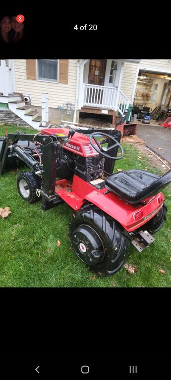

RED-Z06 2,718 #1 Posted November 27, 2022 Found on marketplace...418-A with a loader, bet that is a handful with a few hundred pounds in the bucket 5 Share this post Link to post Share on other sites
ebinmaine 79,012 #2 Posted November 27, 2022 It would be some tolerable as long as you were moving the tractor while steering. Definitely a good candidate for reduction steering. 2 1 Share this post Link to post Share on other sites
953 nut 66,287 #3 Posted November 27, 2022 A weight box behind the rear axle would help. 4 Share this post Link to post Share on other sites
ebinmaine 79,012 #4 Posted November 27, 2022 2 minutes ago, 953 nut said: A weight box behind the rear axle would help. Agreed. Our backhoe is a great counterbalance. 2 Share this post Link to post Share on other sites
Zeek 2,299 #5 Posted November 27, 2022 With those "forks", it's looks like a nice lawn chair carrier. 7 Share this post Link to post Share on other sites
RED-Z06 2,718 #6 Posted November 27, 2022 Wish these tractors had power steering, the hydros had the auxiliary outlets, there's room for an orbital valve...and they were already priced around the cost of tractors with power steering... 2 Share this post Link to post Share on other sites

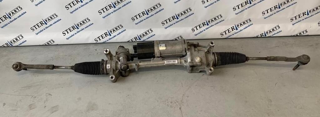

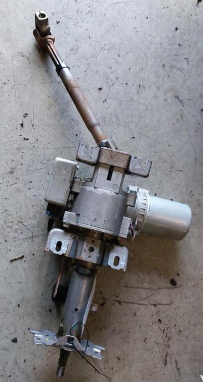

sjoemie himself 3,106 #12 Posted December 2, 2022 Regarding powersteering on a Wheel Horse (or other small vehicle for that matter) there are electric powersteering units one could use. Some of them have a motor on the steering rack and others on the shaft that leads to the steering rack. Seems easy enough to adapt, even to vehicles without hydraulics. Motor on rack Motor on shaft 2 Share this post Link to post Share on other sites
Handy Don 16,679 #13 Posted December 5, 2022 On 12/2/2022 at 6:17 AM, sjoemie himself said: Seems easy enough to adapt, even to vehicles without hydraulics If I were going there, I'd look to a unit that leaves the current tie rods and lower steering shaft in place to preserve the geometry of the steering. Share this post Link to post Share on other sites
sjoemie himself 3,106 #14 Posted December 5, 2022 30 minutes ago, Handy Don said: If I were going there, I'd look to a unit that leaves the current tie rods and lower steering shaft in place to preserve the geometry of the steering. Agreed. The unit with the drive-motor on the steering shaft would also be my first pick. Seems to be as easy as giving it 12V DC and you're off to the races. Might try it on my 512-D. Sure could use it with that heavy sweeper on the nose. 1 Share this post Link to post Share on other sites
Damien Walker 297 #15 Posted March 9, 2023 (edited) Have a look at my two threads on the subject....apologies, I have tried to 'quote' them here but without success. First one is: Wheel Horse 500H Series Power Steering Conversion This was for a 518H..ie already has hydraulic power but it would be relatively easy to add a belt driven automotive pump and tank for the manual transmission tractors. Second one discusses the geometry issues @Handy Don refers to....there's a simple solution: Wheel Horse 500 Swept Front Axle Geometry Correction There's really insufficient room in the dash tower for an electric system, at least, not without considerable butchery. I'm really pleased with my conversion, it has transformed the machine. Hope this helps. Edited March 9, 2023 by Damien Walker Share this post Link to post Share on other sites
