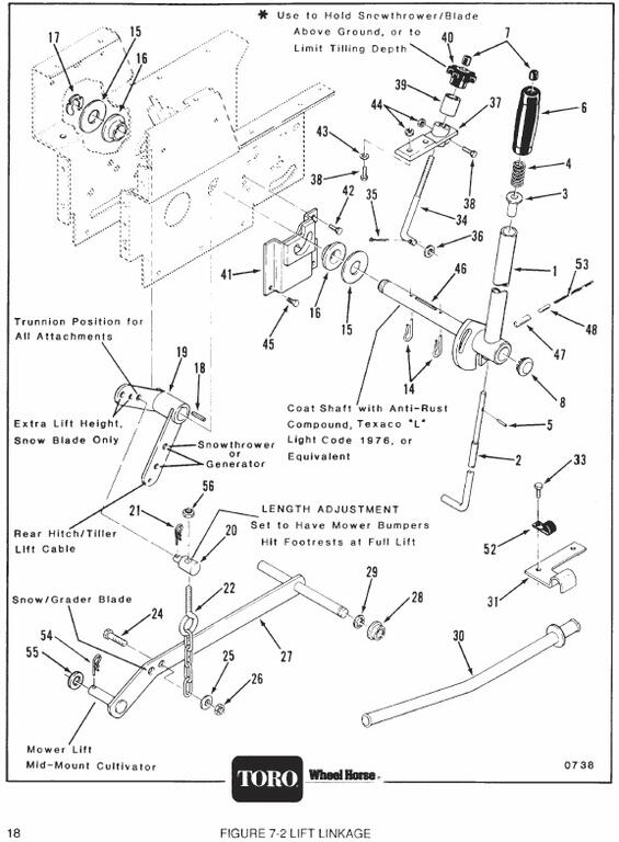

Reddart 213 #1 Posted November 26, 2022 So, I want to try a solid link (to replace the chain) when I have my plow on for the snow. I bought the long link last year and tried to install it….nope, too long. OK, then I’ll get the short link. Nope, too short. is there a medium link? Share this post Link to post Share on other sites
gwest_ca-(File Mod) 12,510 #2 Posted November 27, 2022 No medium link to my knowledge. Click on the picture Are you hooking it up correctly? Remove item 27 and go up to the lift bellcrank 19 1 Share this post Link to post Share on other sites
Reddart 213 #3 Posted November 27, 2022 Ahhh, I think I am trying to install it incorrectly. I was trying to replace the chain with the solid bar link, but from this diagram, the link goes directly from the lift lever to the plow, bypassing the middle lever. 1 Share this post Link to post Share on other sites
