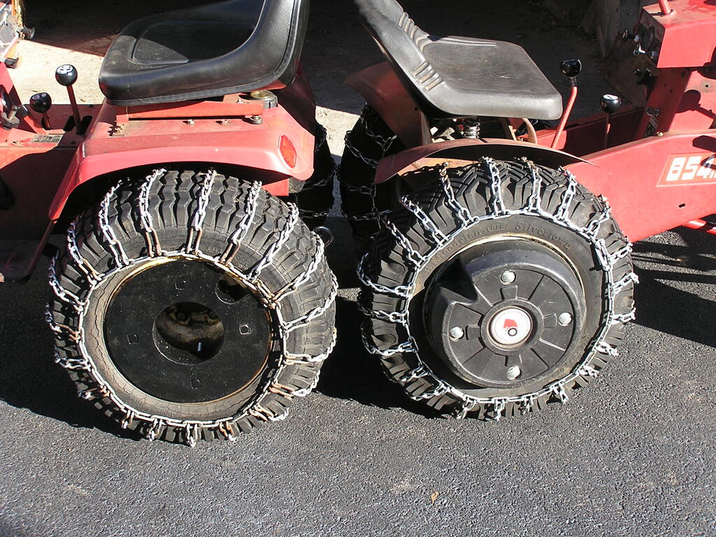

ri702bill 12,475 #1 Posted November 24, 2022 (edited) All: Looks like in the near future I will need to service at least one rear tire on the C81 - the checking on the sidewalls is now showing in the tread area - I am concerned that the tire may split and fail.. The issue is that it is tubed and filled with 4-1/2 gallons of winter windshield washer fluid. I have another mounted C series tire, it holds air but has no tube. What is the best way to EMPTY the filled tube, collect the fluid so I can dismount it and reuse the tube and the fluid in the other tire?? I have an old galvanized 10 gallon washtub - do I just top off the air to 20 PSI, position the tire in the tub with the valve stem at 6 o'clock and pull the core out of the valve stem ?? Edited November 24, 2022 by ri702bill Share this post Link to post Share on other sites
