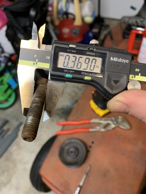

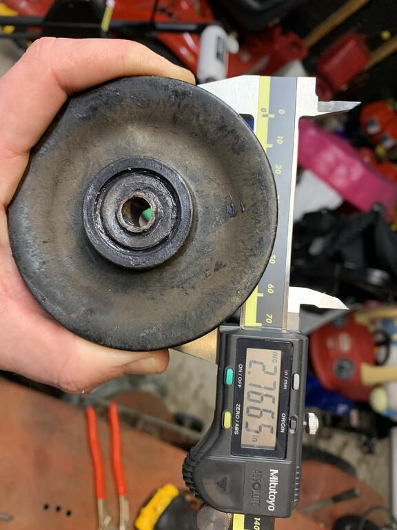

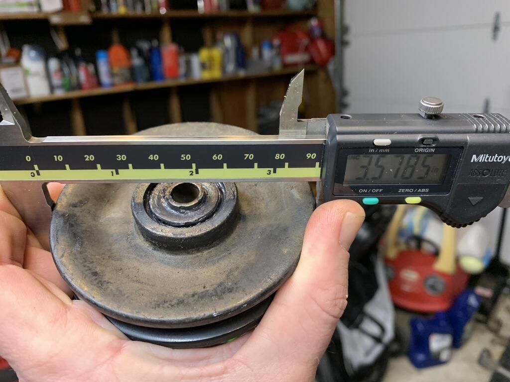

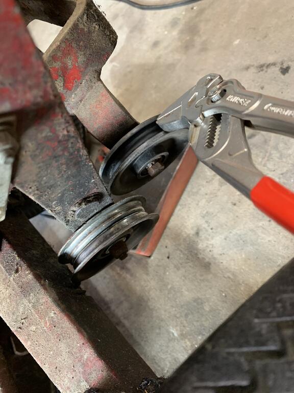

Jake Wilkerson 38 #1 Posted November 20, 2022 (edited) I’m having a hard time figuring out what belts I need before I rip this thing apart. I’ve got a Charger 12 1-7251 with a Mower 5-7366 Ive got 2 belts sitting on the shelf Gates 6378 (1/2”x103 1/4”) Gates 6886 (1/2” x 86”) Are either of these applicable to this machine? UPDATE : I ripped it apart and it doesn’t seem like either belt is for the PTO and this particular pulley bearing is smoked. Anybody have a part number or common size I could find locally? Edited November 20, 2022 by Jake Wilkerson 1 Share this post Link to post Share on other sites

Jake Wilkerson 38 #3 Posted November 20, 2022 32 minutes ago, gwest_ca said: Tractor drive belt # 7478 replaces # 4535 (HB/5L x 84.22" or 5/8" x 84.22") 5-7366 Drive belt 9360 (1/2" x 95.63") [1/2" x 97" in ipl looks wrong] Spindle belt 8411 (1/2" x 76.94") 4567 bearing or https://www.partstree.com/parts/toro-4567/ The pulley I have my pliers on feels plastic and doesn’t look to have a serviceable bearing. I’ll have to take a closer look. Thank you for the other part numbers. 1 Share this post Link to post Share on other sites

Jake Wilkerson 38 #5 Posted November 21, 2022 I PM’d the user you sent me. Here’s some additional photos 1 Share this post Link to post Share on other sites
gwest_ca-(File Mod) 12,259 #6 Posted November 21, 2022 If you dig into the grease you should find a retaining ring on one side. It maybe on the other side. The other pulley uses the same bearing and ring if they are original. 1 Share this post Link to post Share on other sites
Jake Wilkerson 38 #7 Posted November 21, 2022 19 minutes ago, gwest_ca said: If you dig into the grease you should find a retaining ring on one side. It maybe on the other side. The other pulley uses the same bearing and ring if they are original. After speaking with the fella selling bearings there’s no way this is the factory pulley since it’s not metal. Ive got a mule drive on my 73 no name I may try and see if either of its idlers are compatible. If not, I’ll just have to source another idler from somewhere. I think if I try to press this bearing out the pulley will fail. 1 Share this post Link to post Share on other sites
