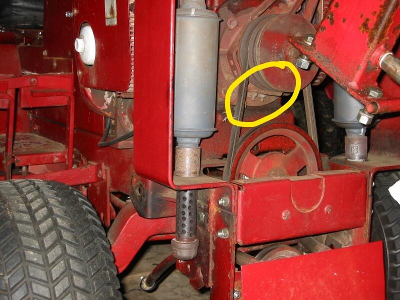

tractorhogg 667 #3 Posted November 18, 2022 14 minutes ago, pfrederi said: Sorry I have D200. I think D-160 Kohlers are not that common If you would be so kind as to show a picture of your D200 clutch and PTO brake, it may help me, thanks Share this post Link to post Share on other sites
pfrederi 21,302 #4 Posted November 18, 2022 She is down in the barn. This is an old pic i had on computer. Does it help? Share this post Link to post Share on other sites

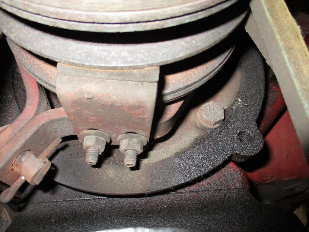

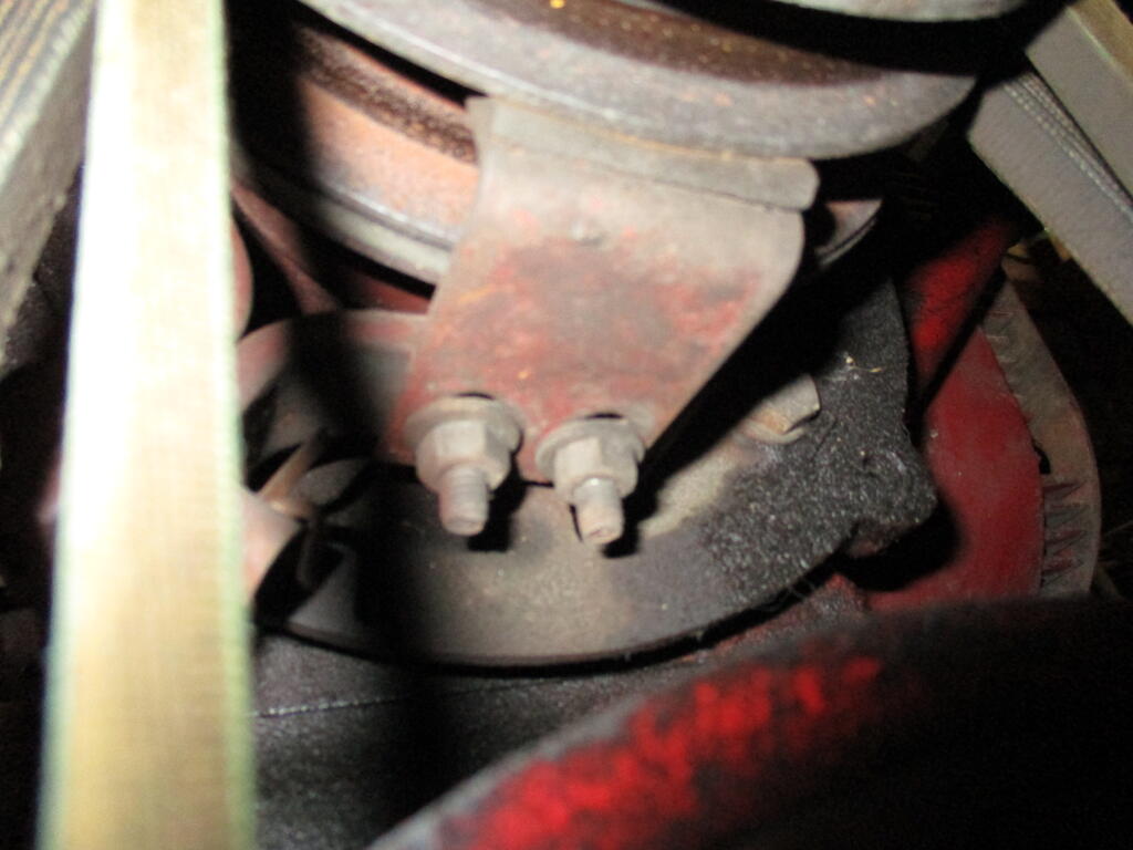

tractorhogg 667 #6 Posted November 18, 2022 (edited) 22 minutes ago, pfrederi said: If not I can go down later see if I can get a better one Does the brake pad face the block, and which side is the brake bolted to the bracket, the inner side or the outer side. Thanks Edited November 18, 2022 by tractorhogg Share this post Link to post Share on other sites
pfrederi 21,302 #7 Posted November 18, 2022 8 minutes ago, tractorhogg said: Does the brake pad face the block, and which side is the brake bolted to the bracket, the inner side or the outer side. Thanks I will have to go look....later ... 29 degrees and windy... 1 Share this post Link to post Share on other sites
pacer 3,181 #8 Posted November 18, 2022 IIRC the brake is mounted with the pad facing the inside grove of the PTO pulley in about the .... 7 oclock position? The couple I have had with the brake still on was worn and looked like a pain to keep adjusted so I just removed them and I did away with them. My blades will stop spinning within 5-10 seconds so I didnt really see the need for one. 2 Share this post Link to post Share on other sites
pfrederi 21,302 #9 Posted November 18, 2022 Friction Pad faces forward. 1 Share this post Link to post Share on other sites
pacer 3,181 #10 Posted November 18, 2022 Well thankfully I havent lost ALL my brain -- thats exactly where I thought it was mounted, but was a bit unsure about how the pad was facing and guessed wrong on that part 1 Share this post Link to post Share on other sites
tractorhogg 667 #11 Posted November 18, 2022 6 hours ago, pfrederi said: I will have to go look....later ... 29 degrees and windy... Thank you so much!! the pictures are perfect, 31 and windy here Share this post Link to post Share on other sites
tractorhogg 667 #12 Posted November 18, 2022 6 hours ago, pacer said: IIRC the brake is mounted with the pad facing the inside grove of the PTO pulley in about the .... 7 oclock position? The couple I have had with the brake still on was worn and looked like a pain to keep adjusted so I just removed them and I did away with them. My blades will stop spinning within 5-10 seconds so I didnt really see the need for one. Thanks, I bought a reproduction clutch brake from a member here and I was going to return it. I may just keep it even if I'm not going to install it. I thought it might have been the wrong part or that my PTO was missing a piece or bracket for it, but all is good now Share this post Link to post Share on other sites
tractorhogg 667 #13 Posted November 18, 2022 4 hours ago, pacer said: Well thankfully I havent lost ALL my brain -- thats exactly where I thought it was mounted, but was a bit unsure about how the pad was facing and guessed wrong on that part Your preachin to the choir, I couldn't even figure it out without pictures Share this post Link to post Share on other sites
