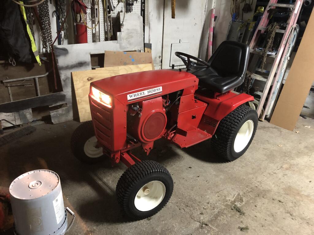

lumbert scott 25 #1 Posted November 17, 2022 (edited) I just got my hands on another horse, Guy did'nt exactly know what it is, Believes it is a 1979. Is there a way to know? It has steel fenders, my other horse has the fiberglass fenders Thanks guys ! Edited November 17, 2022 by lumbert scott 2 Share this post Link to post Share on other sites
Pullstart 71,215 #2 Posted November 17, 2022 Wow, Belding? Hi neighbor! Do you have any pictures of what you picked up? How about a model/serial tag, on the left side of the hood stand, or under the dash? Share this post Link to post Share on other sites

lumbert scott 25 #6 Posted November 17, 2022 (edited) I don’t see any make or model tag Edited November 17, 2022 by lumbert scott 3 Share this post Link to post Share on other sites

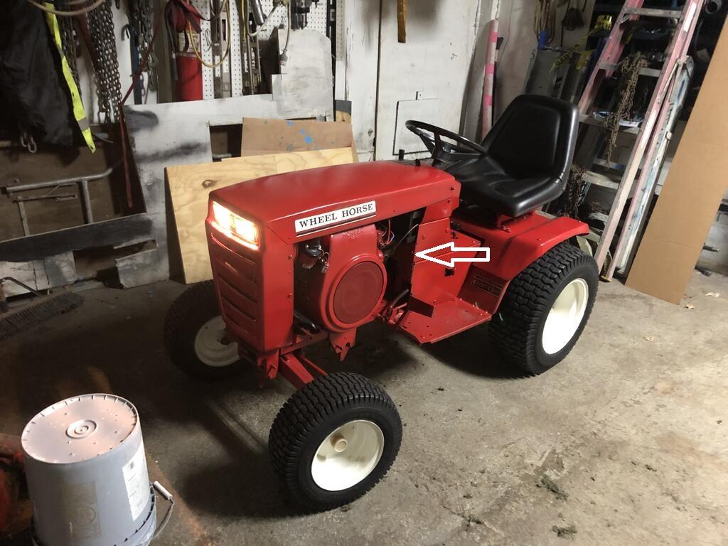

Achto 32,639 #7 Posted November 17, 2022 (edited) 3 hours ago, lumbert scott said: Guy did'nt exactly know what it is It looks like it was repainted at one time. Check by the white arrow on the picture below for an id tag. May be painter over, (hate it when this is done) I will throw my hat in the ring for guess's too. I'm going to guess a C-series. First 2 numbers of the model will be the engine horse power. C121 = 12hp engine, C120 = 12hp engine with the C121 being the newer of the two. Problem with guessing the model by the sheet metal = a Charger, Bronco, Cxx0 and Cxx1 models all used the same sheet metal. Edited November 18, 2022 by Achto 2 Share this post Link to post Share on other sites
Ed Kennell 47,268 #8 Posted November 18, 2022 Doesn't the tank under the seat rule out a C-120? C-121 or C141 ? 3 Share this post Link to post Share on other sites
gwest_ca-(File Mod) 12,484 #9 Posted November 18, 2022 Up to and including 1977 the hood stand was narrower than the dash housing. 1978-79 the hood stand was as wide as the dash housing. The ID plate was riveted on as the white arrow shows but the plate faced the front of the tractor. Click on the picture in the link to see some ID plate examples. 2 Share this post Link to post Share on other sites
Blasterdad 3,168 #10 Posted November 18, 2022 Just by looking it's a '78 or '79 C with the shaker plate short block. 1980 was the start of the black hoods. The wrong stickers were put on the hood when it was repainted, still looks good though. 1 Share this post Link to post Share on other sites

Lee1977 7,764 #14 Posted November 18, 2022 (edited) I agree with Ed on a C-121 or C-141 hydro either 1978 or 1979 they used old style hoods and fender on some early models those years. The metal fender for the gas tank is avabile and could have been changed. Edited November 18, 2022 by Lee1977 Share this post Link to post Share on other sites
