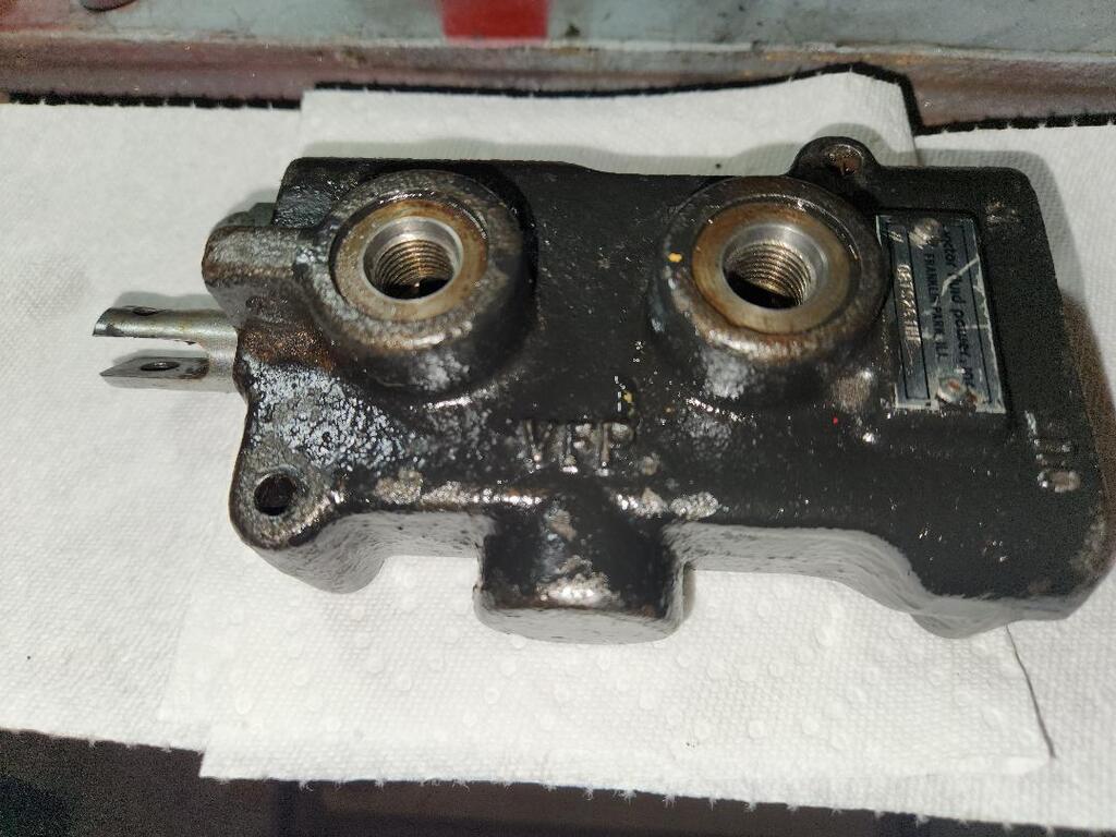

Brockport Bill 2,518 #1 Posted November 14, 2022 i posted a thread a couple weeks ago about a lift valve leak on a C175, Series 2 -- but i have a different related question? I have replaced the O rings inside the lift valve unit as well as replacing the O rings on all the respective hose fitting ends - I am assuming and hopeful that i have now "repaired" the leak from the lift valve itself or a hose coupling thats been causing the oil dripping from the lift valve unit area? - it was impossible to determine where exactly the leak was coming from????? Here's my new question since this is a new venture to me ------------ how do i know its NOT the fitting itself on the end of the hose that is leaking at its own joint???????? The fittings or couplings have a swivel and therefore a joint - so how can i determine it isnt the fitting itself leaking ? Sure don't want to re-assemble the tractor only to learn the new O rings did not correct the leak????? And certainly I want to avoid expense of new hoses, fittings etc unless necessary. Is there such a thing as a vendor/store/repairshop that somehow does pressure tests? Is it common, or not common, for the fitting/coupling itself other - than worn O rings - to leak -- after all the hoses and the fittings are likely original from 1980? thanks for any insights!!!!!!!!!!!!!!!!!!!!!!!!!!!!!!!!!!!!!!!!!!!!! Share this post Link to post Share on other sites

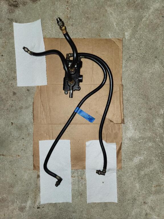

Brockport Bill 2,518 #4 Posted November 14, 2022 some lift valve photos and hoses attached 1 Share this post Link to post Share on other sites

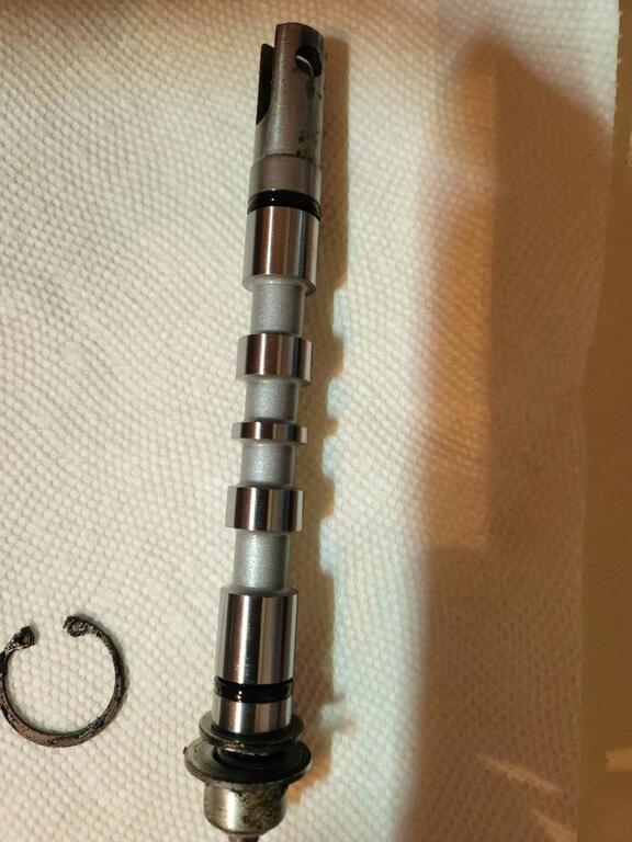

Brockport Bill 2,518 #6 Posted November 14, 2022 below is photo of the internal lift valve piston shaft Share this post Link to post Share on other sites

953 nut 70,325 #8 Posted November 14, 2022 Your ORB "O" ring fittings should be torqued to about 225 inch pounds when installed. I guess you could fabricate a cap for one end of the hose and an adapter to connect to an air hose fitting to the other end to give them a pressure test. 1 Share this post Link to post Share on other sites
JPWH 6,544 #9 Posted November 14, 2022 A hydraulic repair shop should be able to test your hoses but you can replace them for what the test would cost 1 Share this post Link to post Share on other sites

pfrederi 21,303 #11 Posted November 14, 2022 Old swivel fittings will eventually leak The more they swivel/move the sooner they wear out and leak Repair by replacement ... or unless it is a big leak I live with it it is a form of corrosion control 1 Share this post Link to post Share on other sites
Brockport Bill 2,518 #12 Posted November 14, 2022 6 hours ago, peter lena said: @Brockport Bill https://products.swagelok.com/en/all-products/fittings/c/100? we used these every where , hose make up shop probably has them in stock , so you could connect with hose or tube , no failures . plan on " working areas " for no stress operation . bombproof operation , pete 2 hours ago, pfrederi said: Old swivel fittings will eventually leak The more they swivel/move the sooner they wear out and leak Repair by replacement ... or unless it is a big leak I live with it it is a form of corrosion control i am taking old hydraulic hoses to a shop tomorrow --- will see if they can pressure test the 4 hoses to identify which fitting is leaking - and get quotes to replace either leaky one or all 4 2 Share this post Link to post Share on other sites
