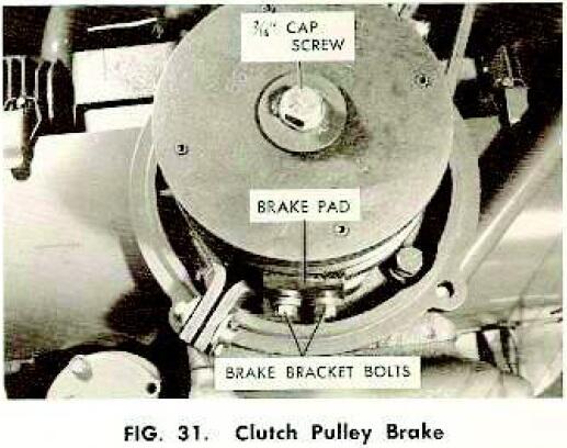

gwest_ca-(File Mod) 12,106 #4 Posted November 13, 2022 Found this in the 1975 operator manual 2 Share this post Link to post Share on other sites

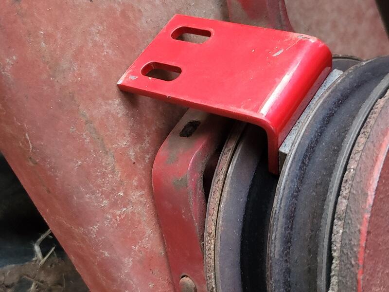

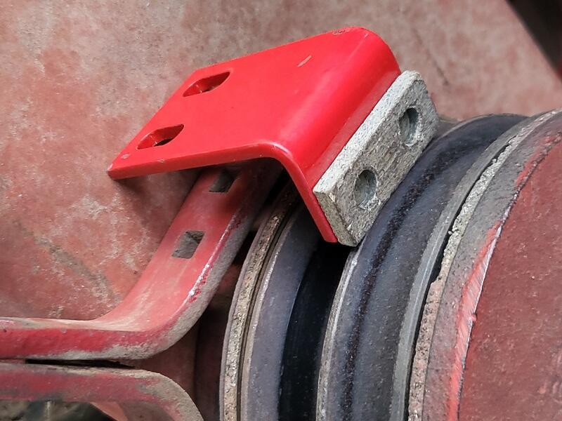

tractorhogg 652 #5 Posted November 14, 2022 24 minutes ago, gwest_ca said: Found this in the 1975 operator manual I have that picture in the service manual, but that is a Kohler 18 hp-20 hp 482s or 532s. Here is the clutch brake and my clutch. I bought the brake from a member here and it was a reproduction, but it looks like others I have seen. I don't see how it can attach and work unless I drill the rivets and put the pad on the other side or cut off the slots and re drill them closer, Check out my pictures Share this post Link to post Share on other sites
tractorhogg 652 #6 Posted November 14, 2022 I bought this part from a member here, and the only way I could see that it would work is if I cut off the long end with the slots and made new slots closer to the brake lining Share this post Link to post Share on other sites
