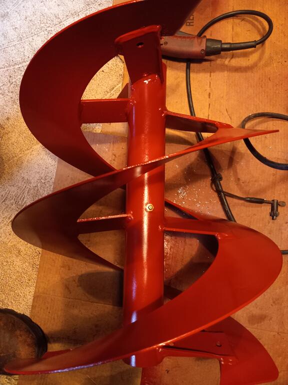

Panther416-8 342 #1 Posted November 12, 2022 All, I see some snowblower have zerk fittings on each auger half so the the auger shaft can be greased for corrosion protection ( 79361 dual stage snowblower does not). Has anyone drilled/tapped their augers for grease fittings? Any reason not to? I would think that having grease inside the cavity of the auger and around the drive shaft would be a good corrosion preventative. 1 Share this post Link to post Share on other sites

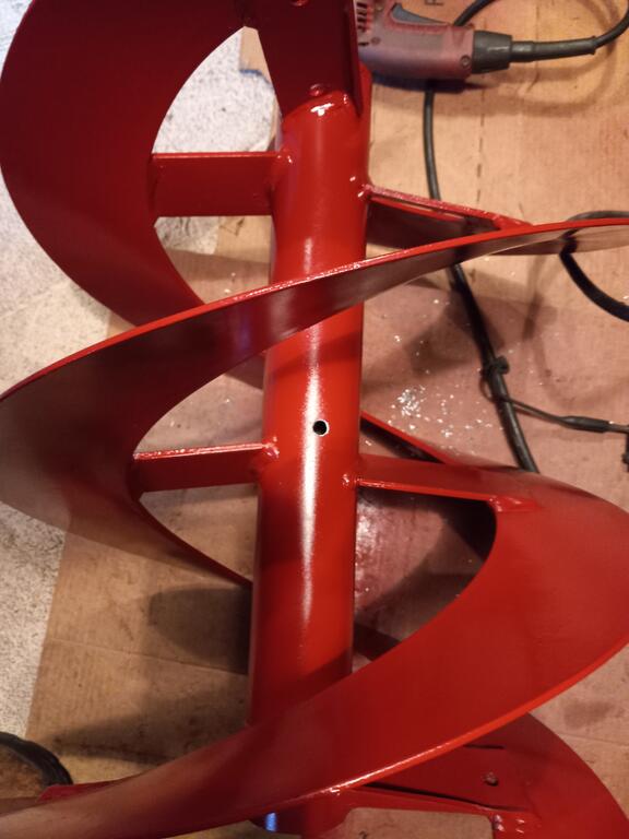

Panther416-8 342 #5 Posted November 22, 2022 I removed the augers and drilled a single hole in about the middle of each and found the the thickness to be suitable enough to tap. I added a zerk to each and they seemed to tighten up nicely. 1 Share this post Link to post Share on other sites
