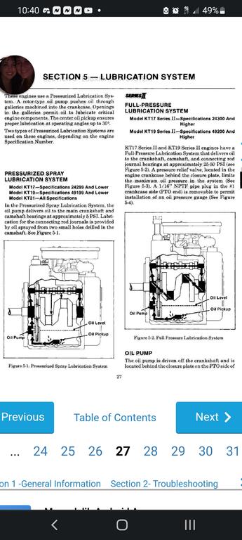

Jeff-C175 7,211 #26 Posted November 12, 2022 (edited) 37 minutes ago, Brockport Bill said: Yes And this plug is not installed on the Series I. Not drilled through. I think that's for an oil pressure switch? Edited November 12, 2022 by Jeff-C175 2 Share this post Link to post Share on other sites

Brockport Bill 2,455 #30 Posted November 12, 2022 here is photo of my C175 Series 1 engine to differentiate from the C175 Series 2 that I posted earlier in this thread - not a great photo but shows the difference 3 Share this post Link to post Share on other sites

RED-Z06 2,720 #32 Posted November 13, 2022 13 hours ago, Jeff-C175 said: How would a filter work on a splash lubricated engine? How would the oil be pushed through the filter? I 1 Share this post Link to post Share on other sites
