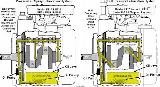

8ntruck 9,382 #13 Posted November 12, 2022 I'm pretty sure that the KT series II engines are full pressure oil systems. The KT steries I engines had a drip oiling system for the big ends of the rods with an oil pump pumping the oil to the crankshaft journals and through the camshaft that has the 'drip ports' to distribute the oil to the rods. The series II engines added oil passages in the crank to oil the rods. 1 3 Share this post Link to post Share on other sites
Achto 32,923 #14 Posted November 12, 2022 Here is an illustration depicting the oiling differences between a Series I and a Series II 5 1 Share this post Link to post Share on other sites

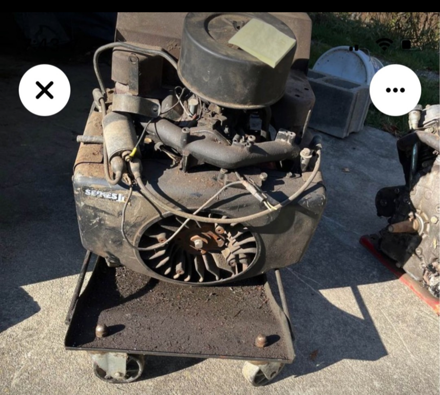

AHS 1,703 #16 Posted November 12, 2022 Ok, I went this morning and got a series 2 Kohler 17 for $30!!!!!😀 it has an occasional backfire at full throttle. I’m going to adjust the valves? He said he messed with the points and cleaned the carb. I’m going to change the oil, replace points, condenser, coil and adjust the valves. 2 1 Share this post Link to post Share on other sites
Jeff-C175 7,211 #17 Posted November 12, 2022 Just now, AHS said: adjust the valves? Unfortunately, to adjust those they need to be ground. The tappets are not adjustable. 1 minute ago, AHS said: messed with the points Hmmm... "messed with" is not a term I would use to describe adjusting the points. Sounds like a hacker term. I would adjust them with a timing light. 2 1 Share this post Link to post Share on other sites
ebinmaine 81,139 #18 Posted November 12, 2022 18 minutes ago, AHS said: Ok, I went this morning and got a series 2 Kohler 17 for $30!!!!!😀 it has an occasional backfire at full throttle. I’m going to adjust the valves? He said he messed with the points and cleaned the carb. I’m going to change the oil, replace points, condenser, coil and adjust the valves. I'd recommend ACTUALLY cleaning the carb the right way too. Remove. SOAK. Reassemble. 1 1 Share this post Link to post Share on other sites

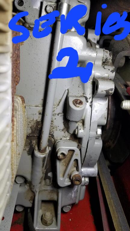

Brockport Bill 2,518 #20 Posted November 12, 2022 i was told this design feature ( see photo ) was a distinguishing factor that indicates the kohler is Series 2 ??? Yes/no? Absent that then its supposedly Series 1 ???????? 1 1 Share this post Link to post Share on other sites
Brockport Bill 2,518 #21 Posted November 12, 2022 there was a Youtube i saw a yr or 2 ago with Kohler 17 engine completely apart and actually showed the holes in the Series 2 crank where engine was redesigned so oil would circulate -- thats what i think i see in the diagrams shown earlier in the thread posted by ACHTO 1 1 Share this post Link to post Share on other sites
pacer 3,181 #22 Posted November 12, 2022 @Brockport Bill That 'cover' piece - or lack of - is the way I've always used to tell which is which. Cause the series 1 does not have it. 3 Share this post Link to post Share on other sites
