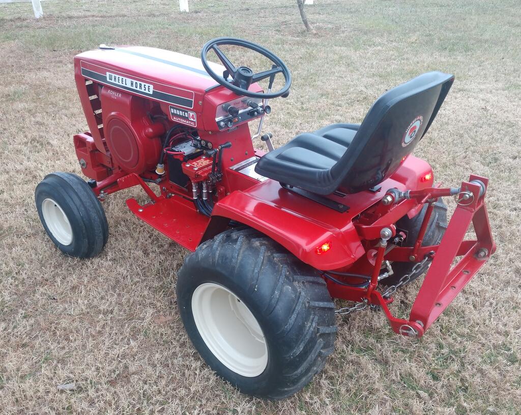

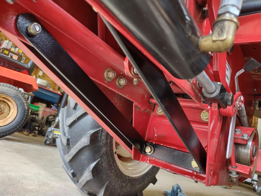

kpinnc 17,309 #2 Posted November 10, 2022 (edited) Depends on the tractor, or your fab skills. Some, but not many tractors had options for Cat 0 three points. Or you can make one. Most any of these tractors can handle a three point, though I'd recommend some additional bracing depending on how much weight you plan to lift. The example brace below isn't mine, but is a very good idea. I made one for my Bronco, and others have been built by members here as well. A clevis hitch can be used for most any Brinly implement, and they are far easier to add to a tractor than a 3-point. Just depends on how much work you want to do. Edited November 11, 2022 by kpinnc 6 Share this post Link to post Share on other sites

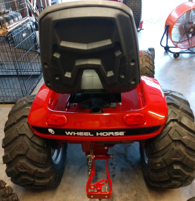

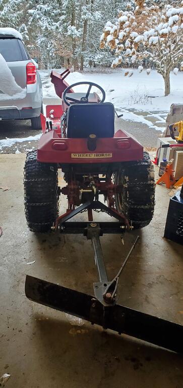

Alex175 784 #3 Posted November 10, 2022 New stuff can be tricky, just went on Northern Tool which used to stock a handful of Cat 0 options, but they don't seem to have much anymore either. I've lucked out a few times just keeping an eye on Facebook Marketplace, or Craigslist for used equipment. Or like @kpinnc said, the Brinly hitch setup works well too, you can either get the hitch mount on smaller machines, or if you have one with a 3 point there are adapters for that like in my third picture. 3 Share this post Link to post Share on other sites
