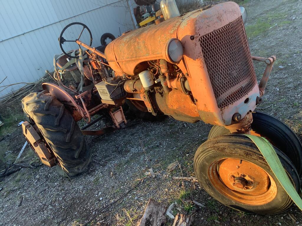

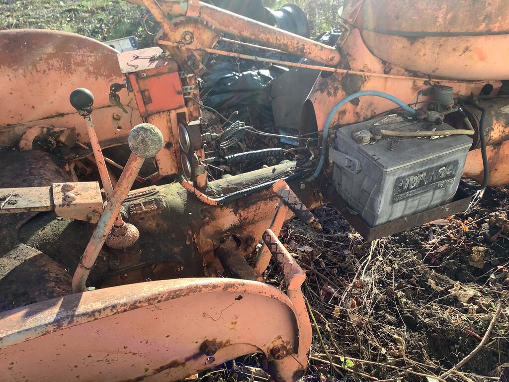

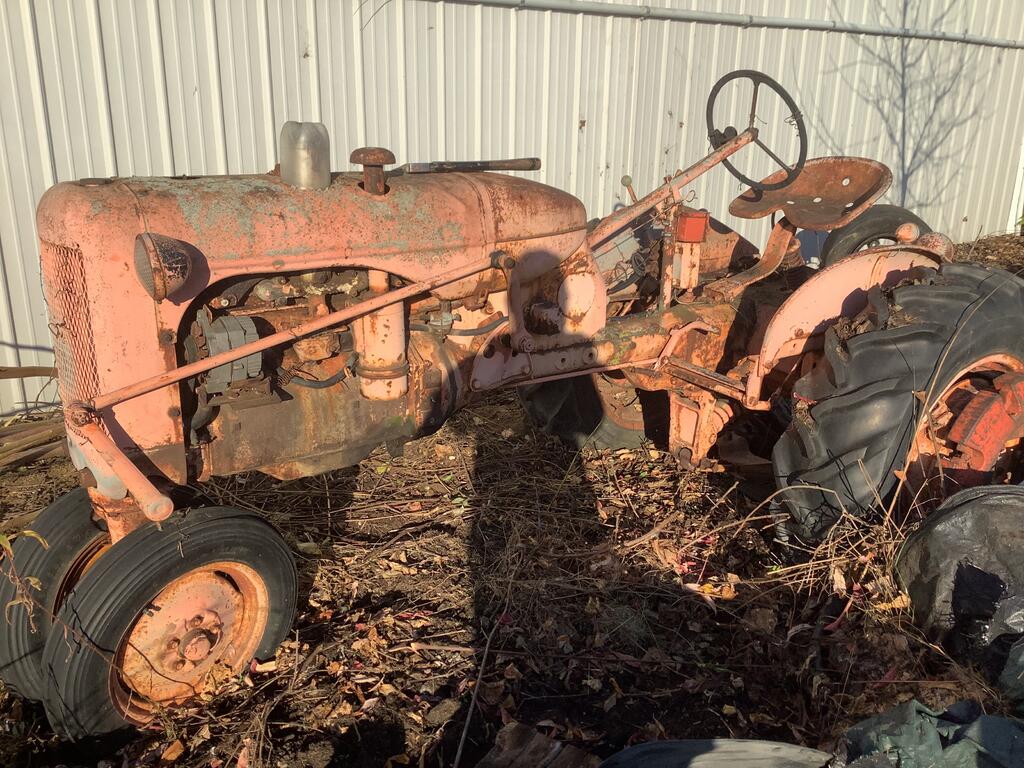

Pullstart 71,564 #1 Posted November 10, 2022 I bought this property about 5 years ago now, from my in laws. Honestly, the time is running together and I am not 100% positive on that. Might be working on 6! This Allis Chalmers CA was given to my brother in law by a close family friend a long, long time ago. I’ve ruled over it since moving here, yet it has just been a grapevine home. I’ve had feelers out now for a while, maybe a year, looking for a machine to get a brush hog for, or pull a bigger plow, etc. the WD45 is powerful, but has no traction. Cleaning up the place a bit lately, I uncovered this from the vines once again and today just asked my BIL what he’s going to do with it. Well, it’s mine now, so long as it stays in the family and I don’t sell it. It has the aftermarket 3 point system, which I may end up swapping onto the WD45 but first it’ll need a real good transmission soaking. The shift rails are stuck to all forward gears, I can only access reverse. The engine oil looks full and fresh at least! My plan, once I get the pool and camper winterized and put away, is to get it INSIDE where it belongs, drain out whatever is inside the transmission, then get it soaking with any oil yep fluids I can find. I have a couple pallets of used oil and I won’t even mind just filling it up to set for the winter. I’ve filled engines to sit for a year and got them to break free, why not an old transmission to start? 7 6 1 Share this post Link to post Share on other sites
953 nut 70,661 #2 Posted November 10, 2022 19 minutes ago, Pullstart said: WD45 is powerful, but has no traction. Looks like that CA has some good wheel weights. 2 1 Share this post Link to post Share on other sites
Pullstart 71,564 #3 Posted November 10, 2022 Just now, 953 nut said: Looks like that CA has some good wheel weights. And good tires, what I can see! We have this same 3 bottom plow, it would be amazing to hear that old thing chuggin’ along turning dirt! https://youtu.be/y1zZcWmAr64 1 Share this post Link to post Share on other sites

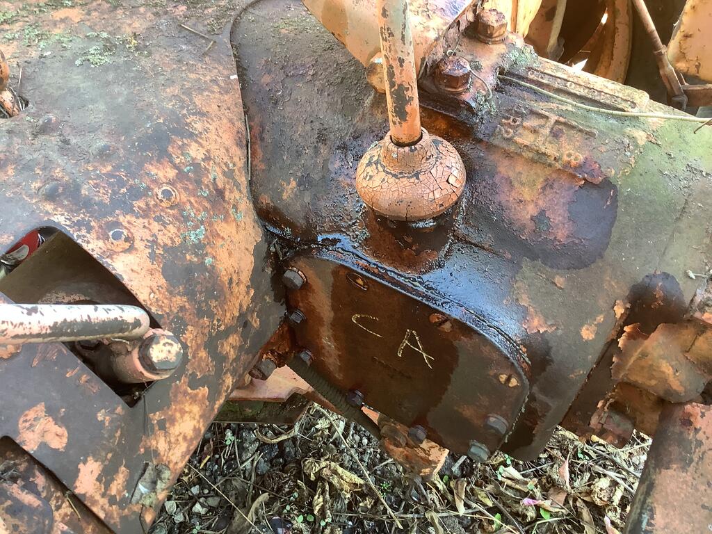

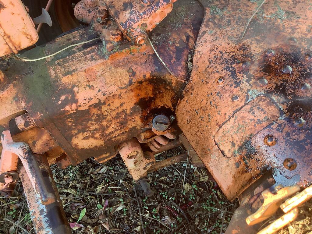

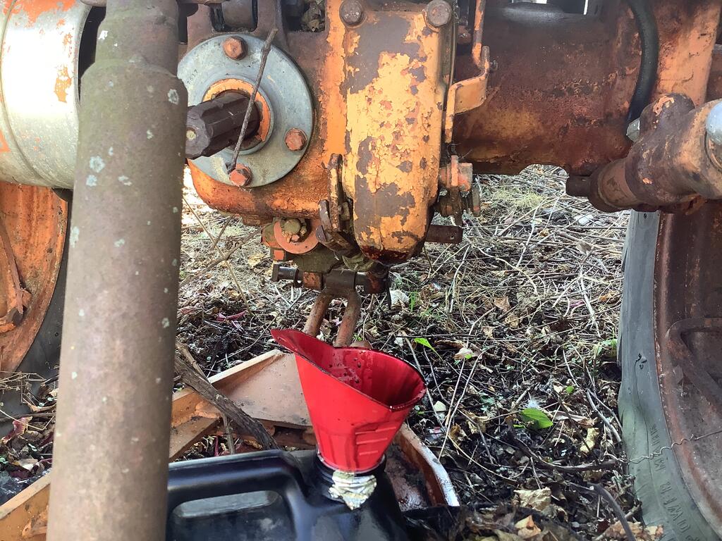

Pullstart 71,564 #4 Posted November 10, 2022 (edited) Well, I removed the plug and filled it to the brim with old oil, then started dripping oil into the shifter hole, in hopes to fill it up. Then, I hear something pouring out the rear. The “draft” mechanism is split (water damage) and is leaking back out. Water was coming out before the oil. Ugh. I realize this will be a long term project, and there’s no need to rush it. I did figure though, I can remove the side plate where it is written “CA” to access the shift rails. Edited November 10, 2022 by Pullstart 2 5 Share this post Link to post Share on other sites

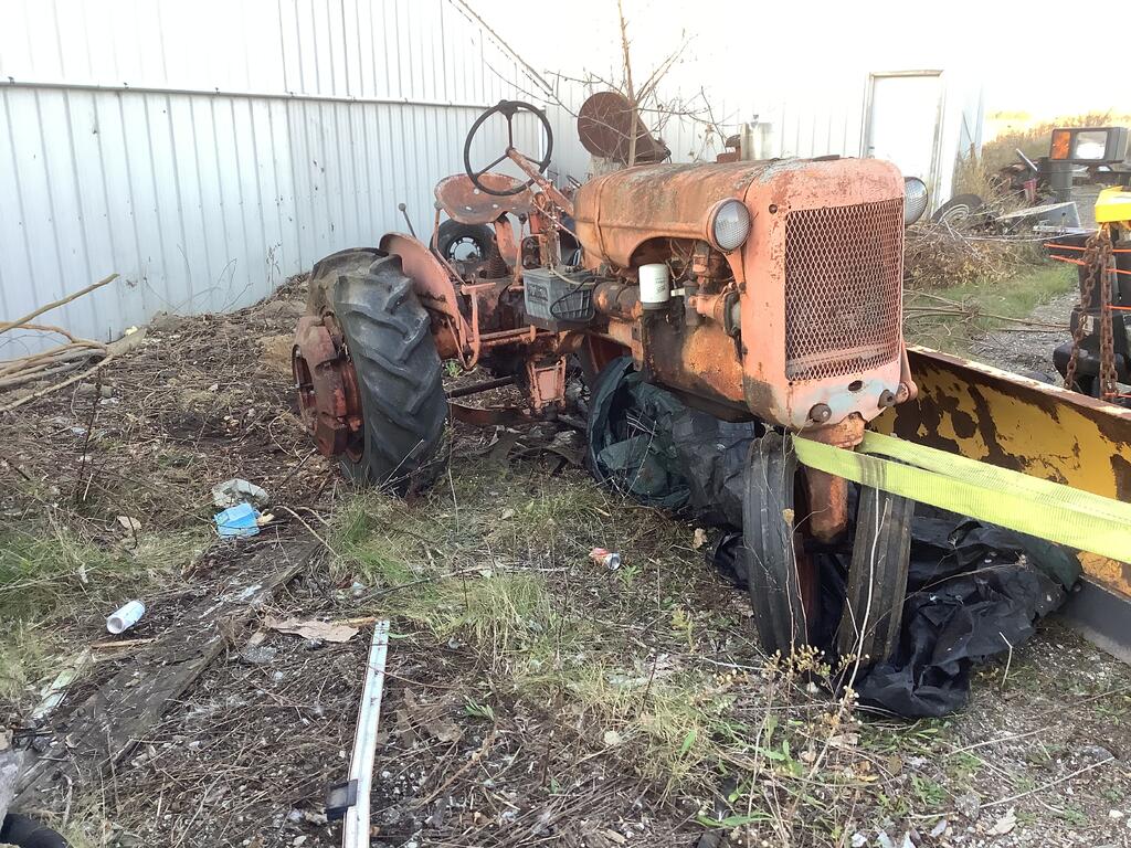

Pullstart 71,564 #9 Posted November 10, 2022 1 minute ago, sjoemie himself said: MCM I’m not sure what that is, should I watch it? I managed to drag it a bit, rock it a bit, then break the rear tires loose. The valve stems are frozen and I can’t get any air in them right now. I’ll address that soon. One thing’s for sure. There’s enough moss on this to compete with @Achto’s Rat Fink Suburban for the greenest tractor on the forum! 4 2 Share this post Link to post Share on other sites

Achto 32,964 #13 Posted November 11, 2022 9 hours ago, Pullstart said: the WD45 is powerful, but has no traction. Curious, a WD45 should weigh in at 4000lbs + or -. The CA should weigh around 2800lbs. 1 Share this post Link to post Share on other sites

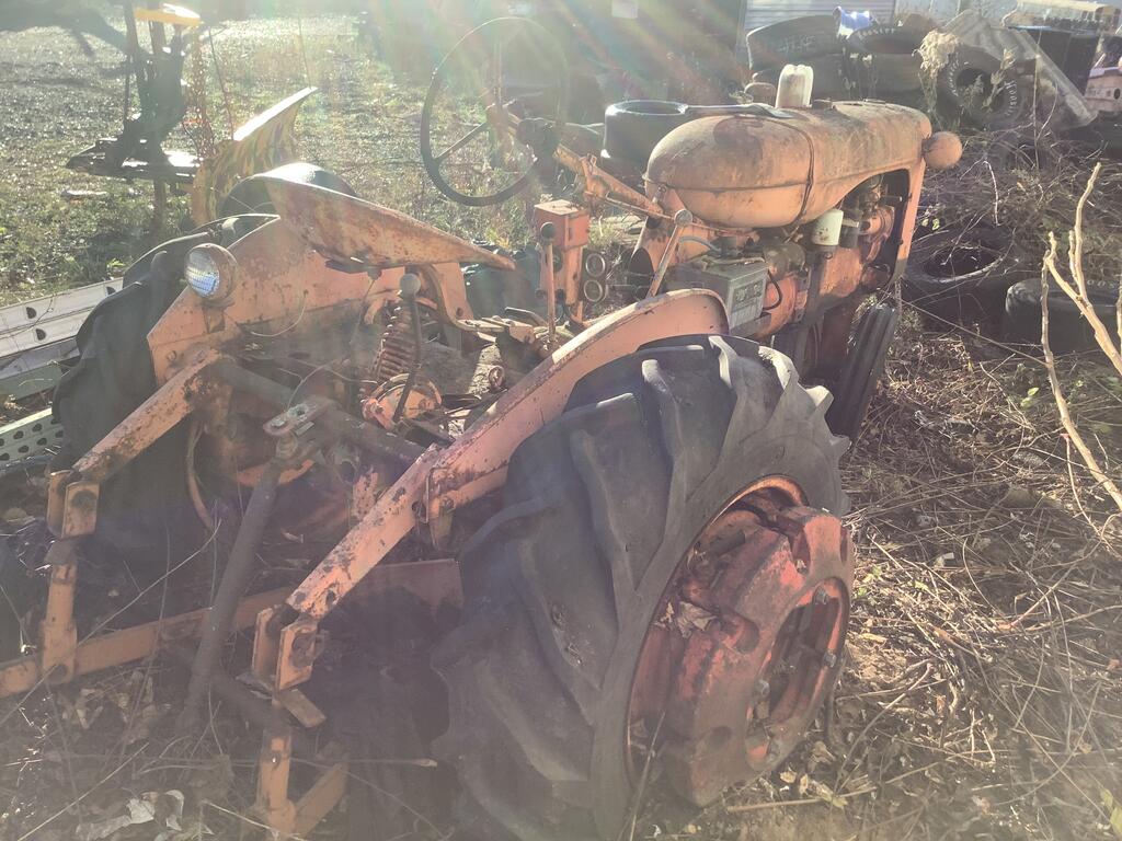

Pullstart 71,564 #14 Posted November 11, 2022 12 hours ago, Achto said: Curious, a WD45 should weigh in at 4000lbs + or -. The CA should weigh around 2800lbs. Tires…. You can see the WD45’s tires in the back of this picture… 1 1 Share this post Link to post Share on other sites

Pullstart 71,564 #20 Posted November 14, 2022 I had a thought today. Like a Wheel Horse transmission, this one got full of water enough to crack the “share” case. It’s probably pretty bad. 2 Share this post Link to post Share on other sites
ebinmaine 81,282 #21 Posted November 14, 2022 I'd have to agree that disassembly would be your best bet at this point. I don't know much of anything about those transmissions. Just from a general mechanical standpoint if it's cracked that bad I don't think I would try to use it at all until I dove into it a little bit to double check what's going on in there. IIFF the case itself is not structural to the Tractor or holding the driveline together you could certainly JB Weld that to do nothing else but keep the fluid in place. Welding of course would be an option. Seems to me there are enough of those around that Parts availability should be pretty good anyway. 1 Share this post Link to post Share on other sites
Pullstart 71,564 #22 Posted November 14, 2022 I remember going to this place a handful of years back for some cylinder head parts. This fella told me he has some transmissions minus the hand clutch side and we could find a good one for $400. That doesn’t sound terrible. If all else fails, there is a wide front CA not too far away that runs good and has “new tires” for $1,000. Obviously, I’d like to save what I have more than anything. 4 Share this post Link to post Share on other sites
