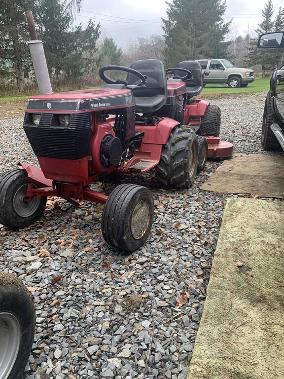

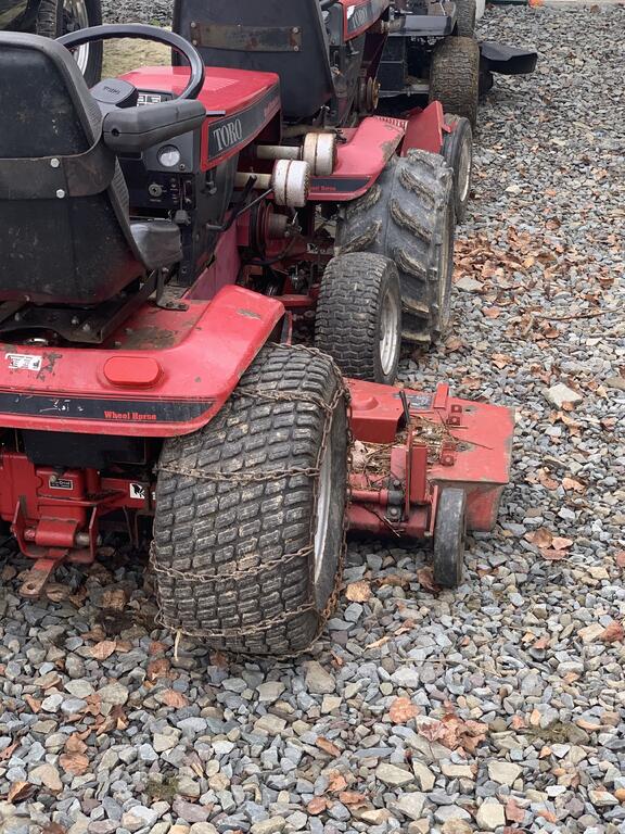

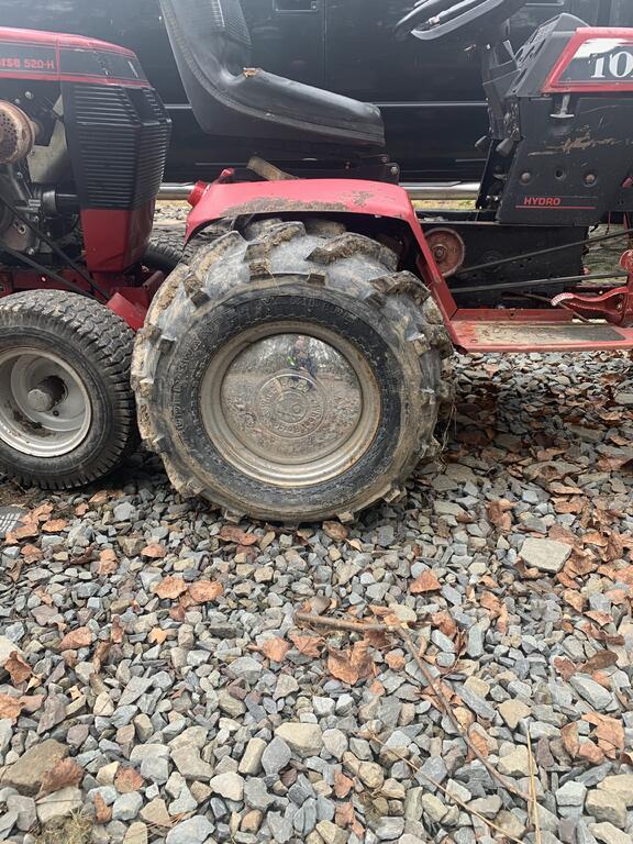

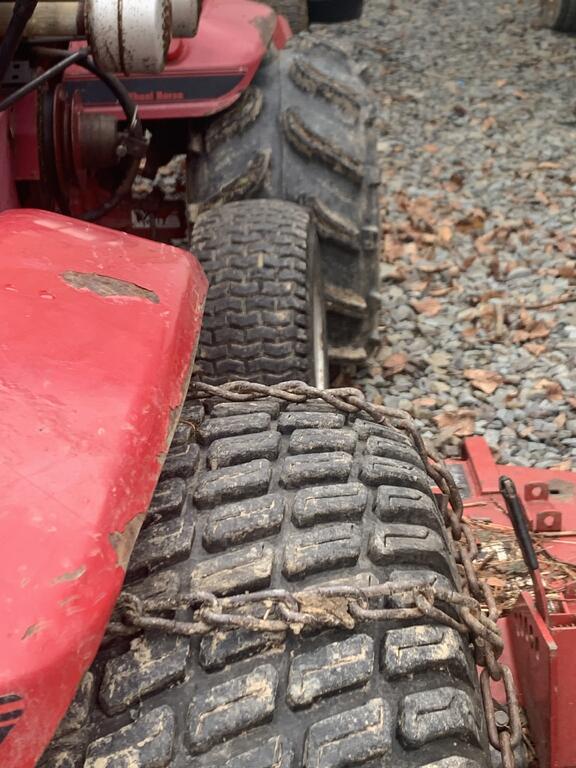

littleredrider 409 #26 Posted November 11, 2022 I put 25x12x12s on the wifey's diesel 520. Got rim blanks from Miller tire, 10" wide. A wide rim will "flatten" the tread, where ATV tires are normally rounded. They fit without lifting or modding anything. And are insane on traction. I thought I had pics, but guess it's the other tractors. Oh, get the bead breaker from harbor freight. I broke tires down that were on since the 60s, Need to work lil at a time, but they will come off.... 2 2 Share this post Link to post Share on other sites

littleredrider 409 #28 Posted November 12, 2022 I'll try to get some today. Sorta looks like rain holding off and the bright thingy coming out some. Don't wanna say what, cause it will go away!!!! But all three are out there, so can get a side by side comparision.... 1 Share this post Link to post Share on other sites
littleredrider 409 #29 Posted November 12, 2022 Pics ain’t the greatest but got some. 2 1 1 Share this post Link to post Share on other sites
littleredrider 409 #30 Posted November 12, 2022 Last one 1 1 1 Share this post Link to post Share on other sites
littleredrider 409 #31 Posted November 12, 2022 The other tractor has 24x12x12 for reference. 1 Share this post Link to post Share on other sites
