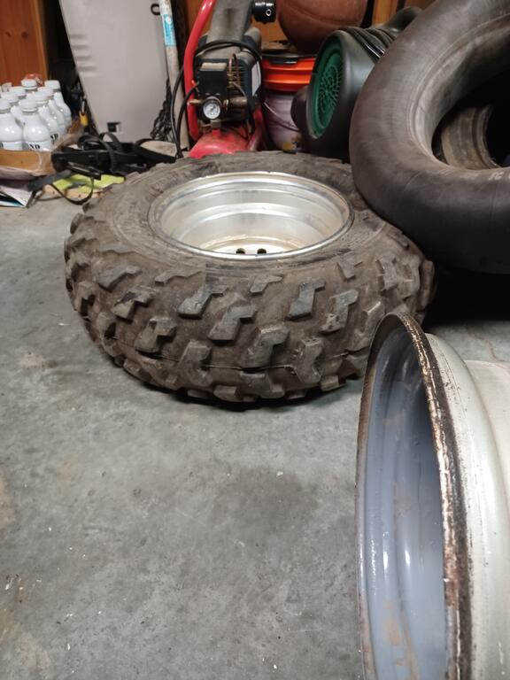

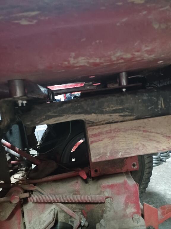

TJ5208 1,841 #1 Posted November 10, 2022 So I decided to stick a set of 25 inch ATV tires underneath my tractor so I had to lift the fender pan. And the tires are being a pain to try to take off the rims. I still have the other side to get off but here's my progress so far. @857lover has been watching this I already told him I'm probably going to take the ATV tires to a shop and get them took off because I don't feel like destroying them. 4 Share this post Link to post Share on other sites

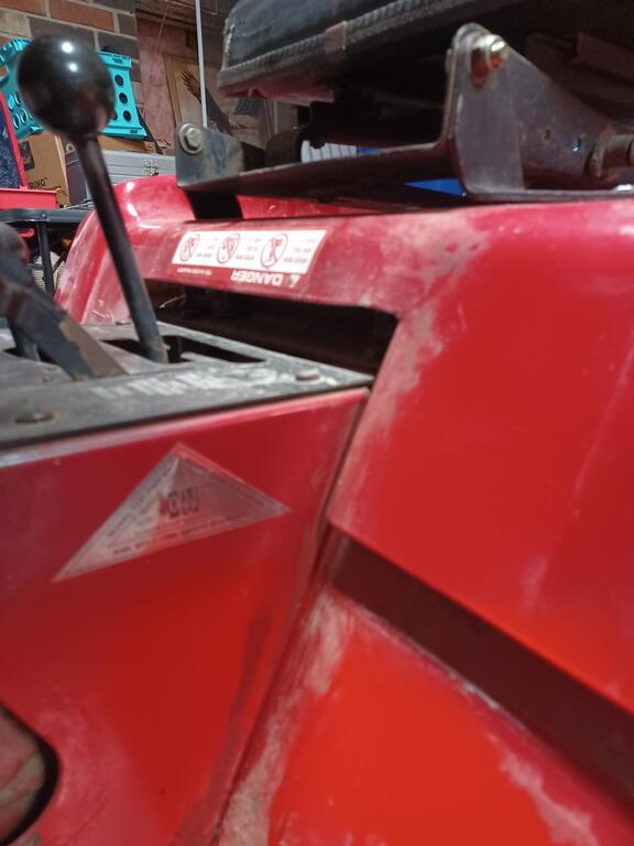

Panther416-8 342 #2 Posted November 10, 2022 Doesn't that lift make the trans oil check and fuel refill difficult at best? 1 Share this post Link to post Share on other sites
kpinnc 19,036 #3 Posted November 10, 2022 You can add blocks underneath the tank to raise the filler neck. Probably up to about 3/4 inch. 1 Share this post Link to post Share on other sites
TJ5208 1,841 #4 Posted November 10, 2022 1 hour ago, Panther416-8 said: Doesn't that lift make the trans oil check and fuel refill difficult at best? No not at all. 1 Share this post Link to post Share on other sites

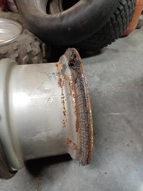

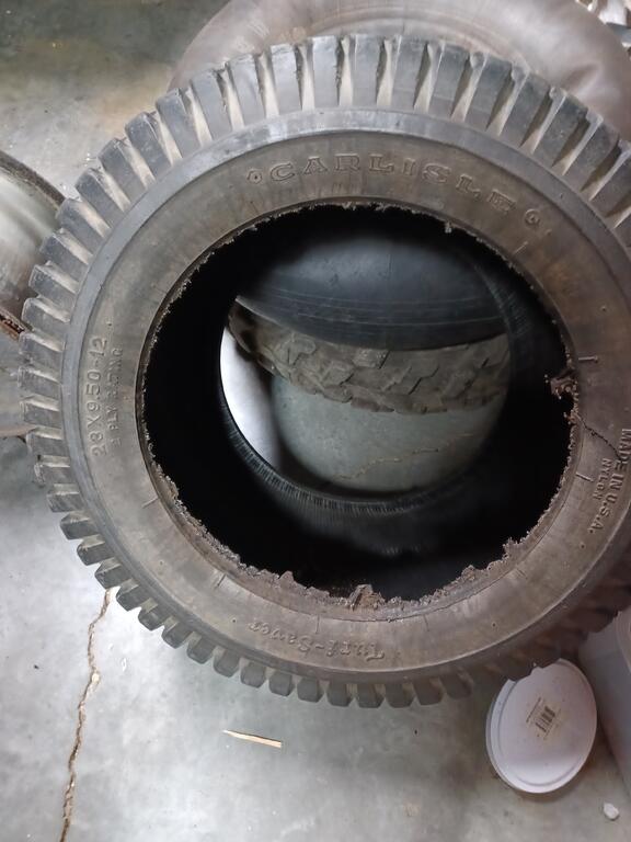

Pullstart 71,482 #5 Posted November 10, 2022 Did that tire rip like that, or was it cut off the wheel? 1 Share this post Link to post Share on other sites
TJ5208 1,841 #6 Posted November 10, 2022 1 minute ago, Pullstart said: Did that tire rip like that, or was it cut off the wheel? I had to cut it the bead is stuck. 1 Share this post Link to post Share on other sites
Pullstart 71,482 #7 Posted November 10, 2022 5 minutes ago, TJ Salyers said: I had to cut it the bead is stuck. Not fun. Best get after it with a chisel and hammer now 1 Share this post Link to post Share on other sites
TJ5208 1,841 #8 Posted November 10, 2022 7 minutes ago, Pullstart said: Not fun. Best get after it with a chisel and hammer now Im hoping i dont destroy the atv tires. 1 Share this post Link to post Share on other sites
Achto 32,890 #9 Posted November 10, 2022 (edited) Slide hammer bead breaker will get those tires broke off the rim. This is what I use on farm tractor tires & other tires that won't cooperate. https://www.amazon.com/Esco-70150-Slide-Hammer-Breaker/dp/B01DY9HBFK/ref=asc_df_B01DY9HBFK/?tag=hyprod-20&linkCode=df0&hvadid=312070574797&hvpos=&hvnetw=g&hvrand=479455778645694490&hvpone=&hvptwo=&hvqmt=&hvdev=c&hvdvcmdl=&hvlocint=&hvlocphy=1028137&hvtargid=pla-627895104447&psc=1 Edited November 10, 2022 by Achto 3 Share this post Link to post Share on other sites

Panther416-8 342 #11 Posted November 10, 2022 5 hours ago, kpinnc said: You can add blocks underneath the tank to raise the filler neck. Probably up to about 3/4 inch. Guess that would work. My transmission dipstick is already close to being flush with the seat pan. Not sure how that could be adjusted other than to fashion a new dipstick tube to thread into the trans and lengthen the dipstick itself. Share this post Link to post Share on other sites

TJ5208 1,841 #15 Posted November 11, 2022 8 hours ago, Snoopy11 said: By.... cutting them off... I just question why you didn't just take it to a tire shop? They will remove them and put the new ones on for you... Don I was trying to break the bead. Then i accidentally put the ply bar through the tire. Share this post Link to post Share on other sites
Jeff-C175 7,211 #16 Posted November 11, 2022 19 minutes ago, TJ Salyers said: I was trying to break the bead. Then i accidentally put the ply bar through the tire. That tells me the tires were dry rotted and junk anyway. Unless you had that pry bar sharpened up to play mumblety peg with. 1 Share this post Link to post Share on other sites
Lee1977 7,807 #17 Posted November 11, 2022 14 hours ago, kpinnc said: You can add blocks underneath the tank to raise the filler neck. Probably up to about 3/4 inch. I went under the fender and gas tank bracket on my 312-8. The lift tube will be a problem on the hydro if you go under the bracket. 2 Share this post Link to post Share on other sites

Snoopy11 5,731 #23 Posted November 11, 2022 2 hours ago, Pullstart said: Ok. Tires were junk. Can we drop that and move on How do you know the tires were junk? What evidence do you have of that? Seems to me that it was merely preference that these tires get changed... nothing wrong with that, but I have seen tires in MUCH worse shape still rolling around. Previous to them being amputated from the rim, I don't see any evidence that those tires were 'junk' ...or that they would not hold air. I see 12 inch tubes in the pictures, so it appears to me that the tires might have had tubes in them to begin with. Even if they didn't hold air for whatever reason, those tires look to be in good enough shape to tube (or re-tube) them... and it certainly would have been cheaper in TJ's position to use new tubes. I could easily tear a hole in even a brand new tire with the wrong tools. We don't know if the tires were bad or not... we can only look at pictures. If it was just preference that these tires get changed, then so be it. Just don't make excuses for using the wrong tools and cutting tires off rims to change them... that is a desperation move that shouldn't be recommended or repeated... Don Share this post Link to post Share on other sites
