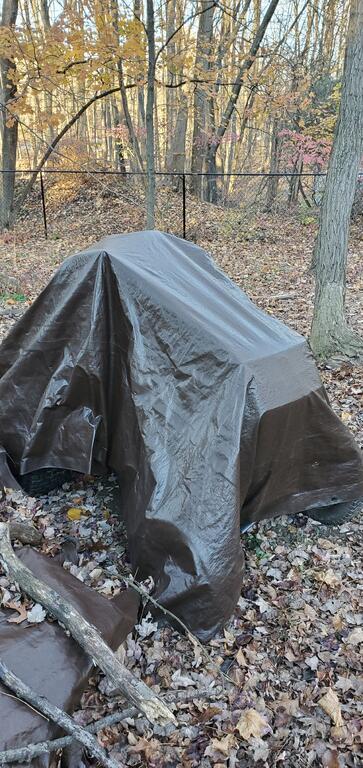

victorb 46 #1 Posted November 9, 2022 Not sure if this belongs here or in non-tractor section, so forgive me if I chose wrong. As the title suggests, I am curious where is the best place to keep your WheelHorse when not in use. Ideally I would like to keep mine in Garage or Shed but just have run out of room. Looking to build a second garage/shed at some point but not sure how soon that will happen. So for now I have a tarp tied down over my 520H to at least protect it from some elements. I plan on using this for clearing snow (blower) so it needs to be easily accessible. I looked at some various canopy/tent-like structures but not sure if they are any better than a tarp. What are solutions that others might use? Is a garage/shed the only way to go to keep a clean/dry tractor ready to go? -VictorB 2 Share this post Link to post Share on other sites
peter lena 9,939 #2 Posted November 9, 2022 @victorb think i would have something , with more coverage strength than , a sheet of vinyl, another thing is the mice , etc , getting under that . would also get some STA- BIL gas treatment run thru that before putting it to sleep. have sta bil in all my gas tanks . if the tent like set ups have a floor , that would be a bonus. others will add to this , pete 1 Share this post Link to post Share on other sites

Sparky-(Admin) 25,934 #4 Posted November 9, 2022 If you get a windy day and that tarp starts flapping it can actually wear off the paint where it beats on the hood or fender Could you make a simple wooden A frame over the tractor and then toss a tarp over that? 8 Share this post Link to post Share on other sites

victorb 46 #6 Posted November 9, 2022 6 minutes ago, Sparky said: If you get a windy day and that tarp starts flapping it can actually wear off the paint where it beats on the hood or fender Could you make a simple wooden A frame over the tractor and then toss a tarp over that? I have it tied down pretty good underneath but I do agree with you and this has been one of my many concerns. I will look into this if no better options come about. Thanks. 3 Share this post Link to post Share on other sites

kpinnc 18,740 #10 Posted November 10, 2022 Storing a tractor under a tarp is no different than storing one in a lake, completely submerged. Here at least, every single day results in condensation (with no benefit of the hood and fenders shedding water) that goes everywhere. It forms not only on top of the hood, but even under the tins of the engine, every electrical contact, every surface. If a tarp is the only option, it should be open on the sides as much as possible. Ventilation is mandatory. 1 Share this post Link to post Share on other sites

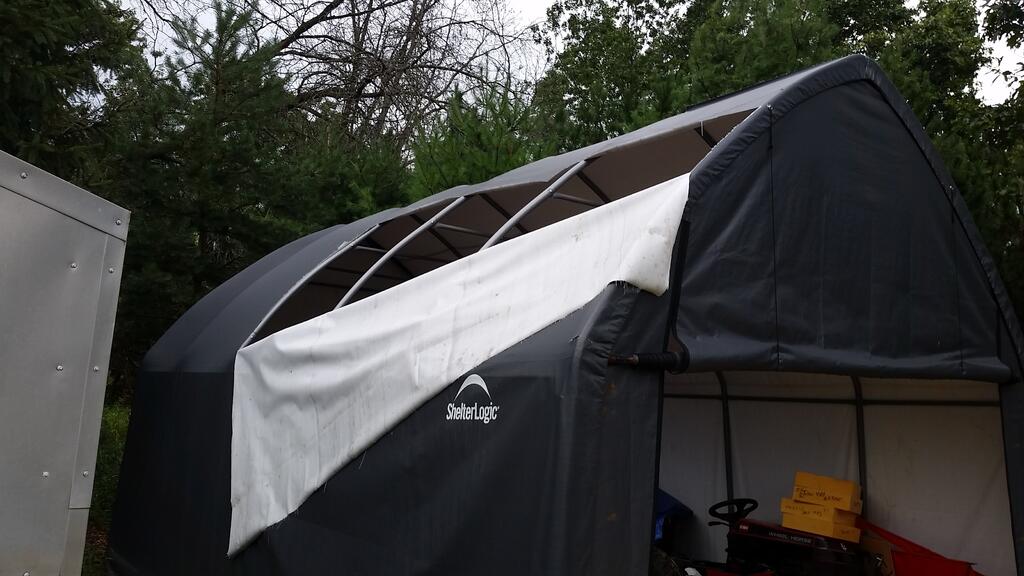

WHX?? 57,384 #17 Posted November 11, 2022 On 11/9/2022 at 2:41 PM, victorb said: Looking to build a second garage/shed at some point Same boat here guy. I'm lucky and have a neighbor who let's me keep a few (dozen) in a lean to off property but the way i gotta stack them in like cordwood makes it difficult to get one out if it needs love in the dead of two ft of snow. Plus the hassle of moving them all. You guys know how I feel about fake garages 1 Share this post Link to post Share on other sites

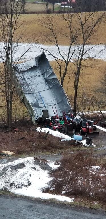

gt14rider 1,233 #19 Posted November 11, 2022 Had this up for 3 or 4 days, hold downs stayed, metal tubes bent and broke. 60+ mph winds 4 Share this post Link to post Share on other sites
